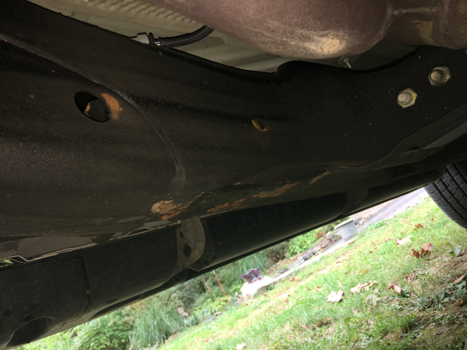

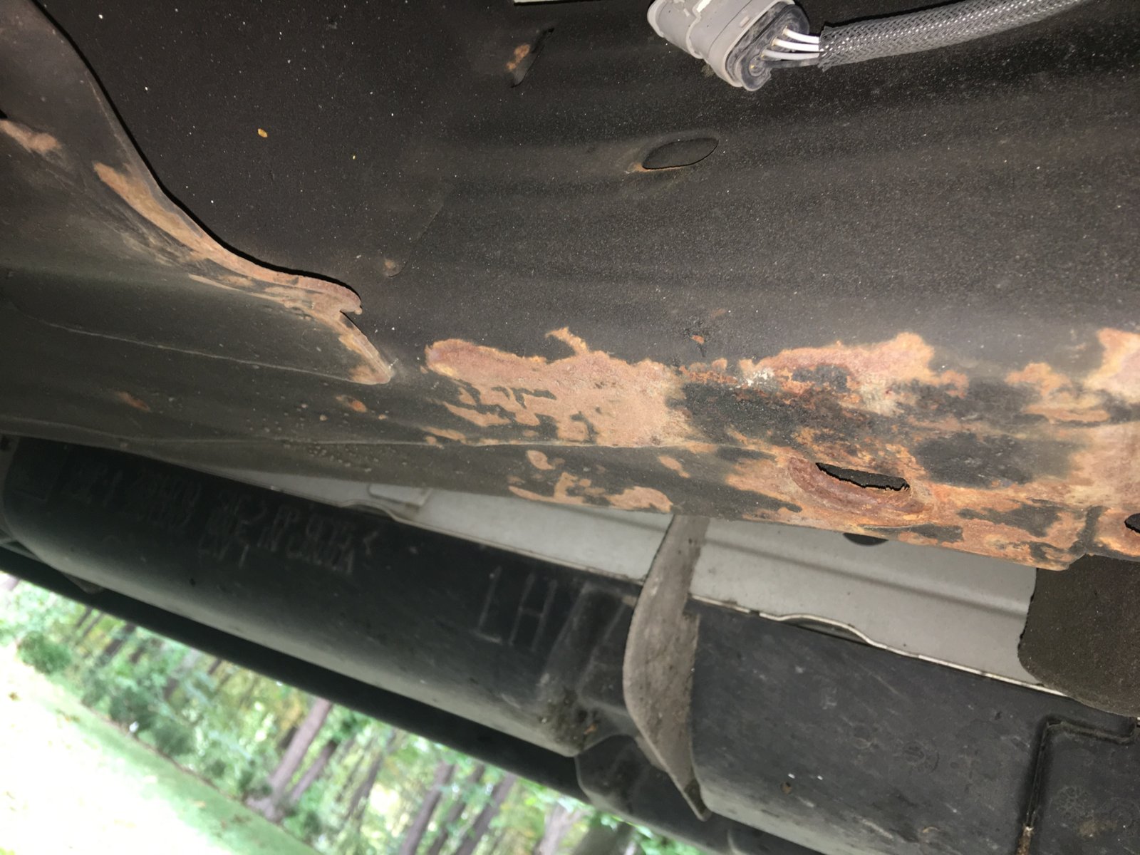

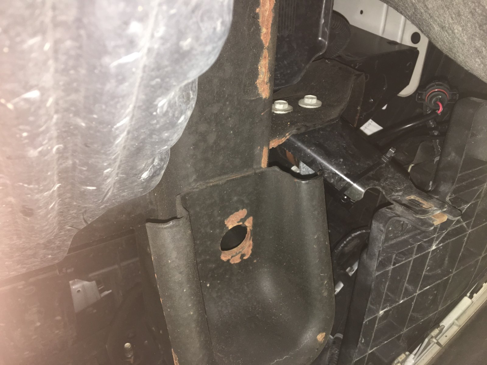

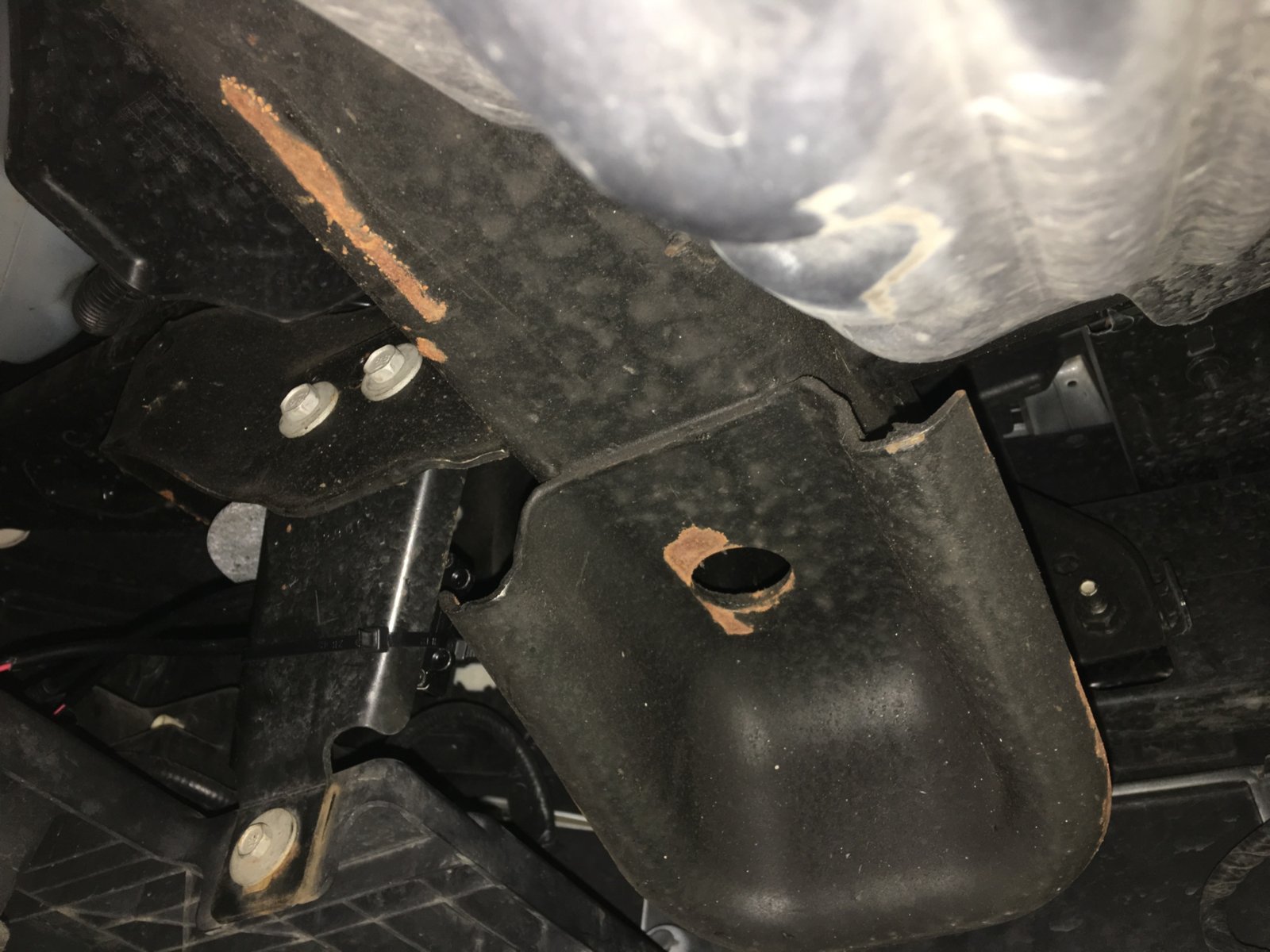

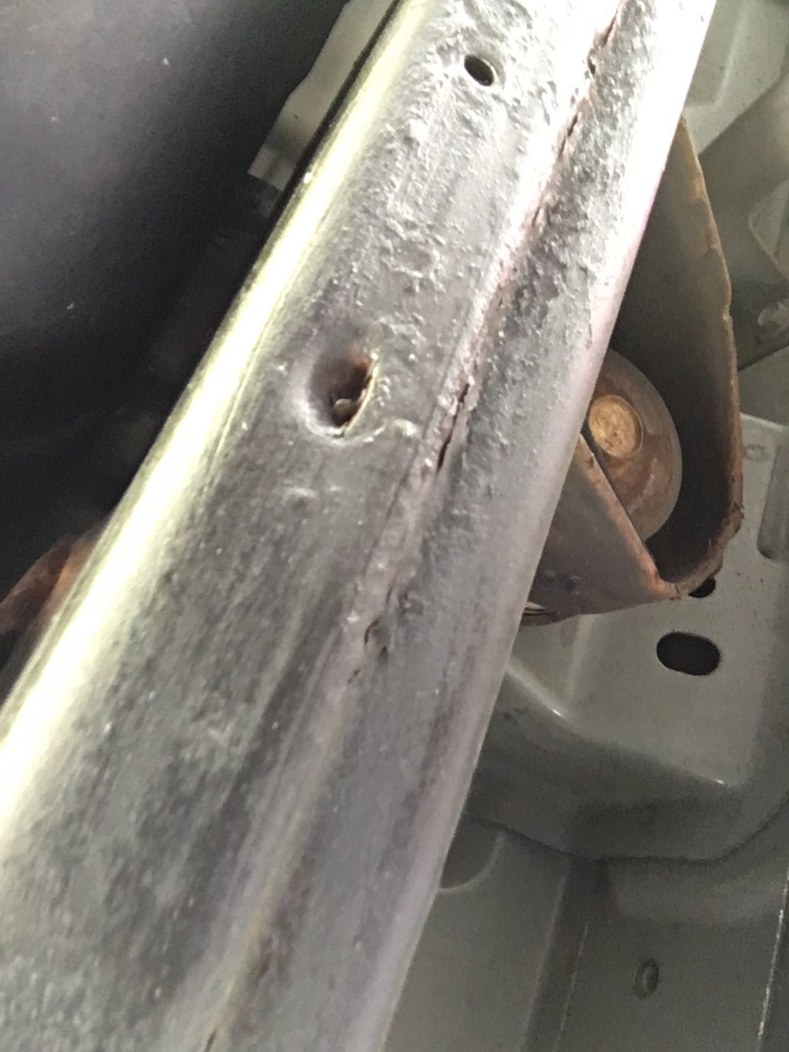

This is the under side of my 15 LTZ. I live in upstate ny where theres no shortage of salt and snow, i noticed the only real area that the coating is coming off is where it gets lifted up by the rack at the dealer.

There is factory spray in a can that is the same color rubberized texture. It has been discussed with a part number. Maybe someone remembers where it was if you want to buy a can to keep it factory looking.
