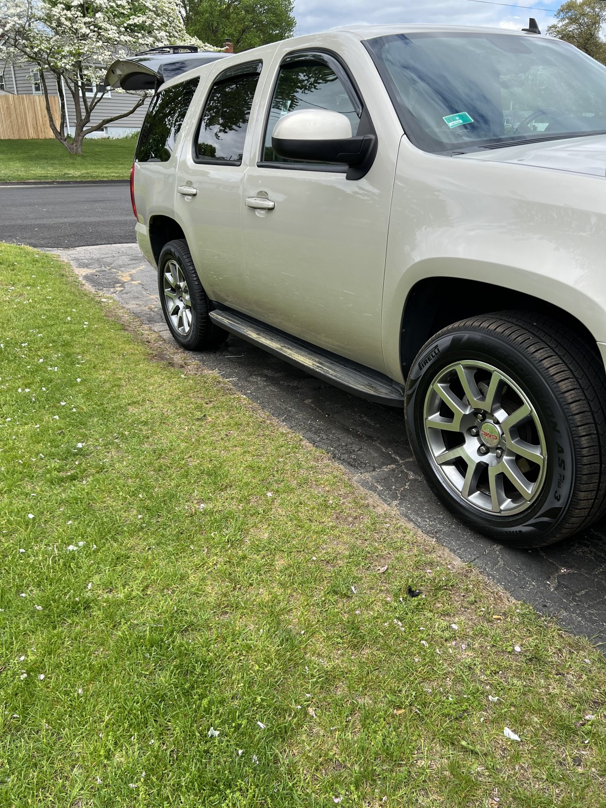

i have a set of new 20" wheels off a 2018 yukon xl. perfect fit
