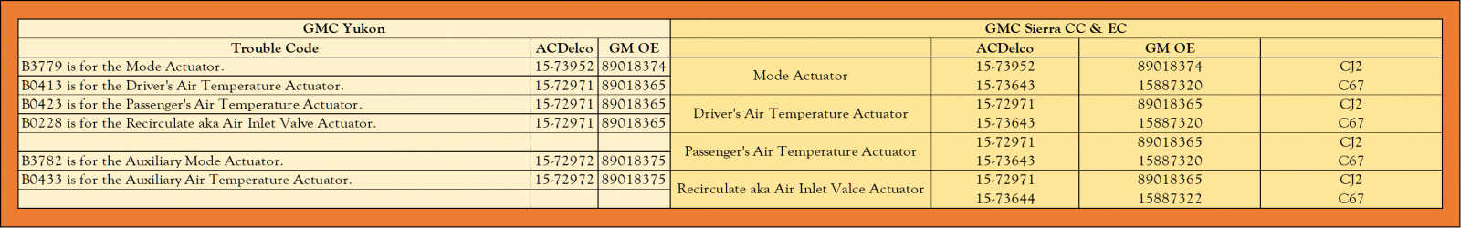

Does any know exact location of this actuator? trouble code B3782.16 stuck actuator
Common issue. Also called a blend door actuator if you want to find other posts here about it. Here's a primer on where they're located:Does any know exact location of this actuator? trouble code B3782.16 stuck actuator
