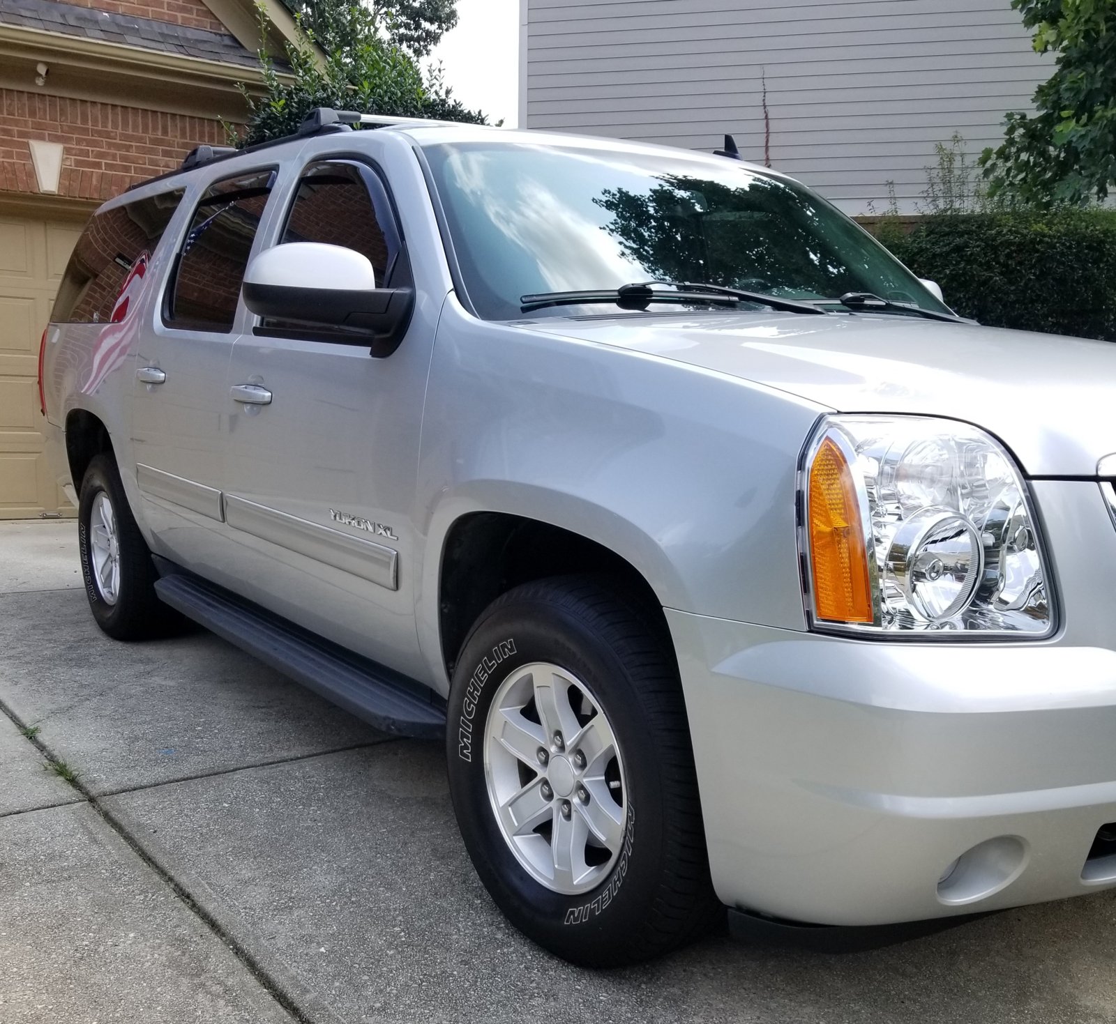

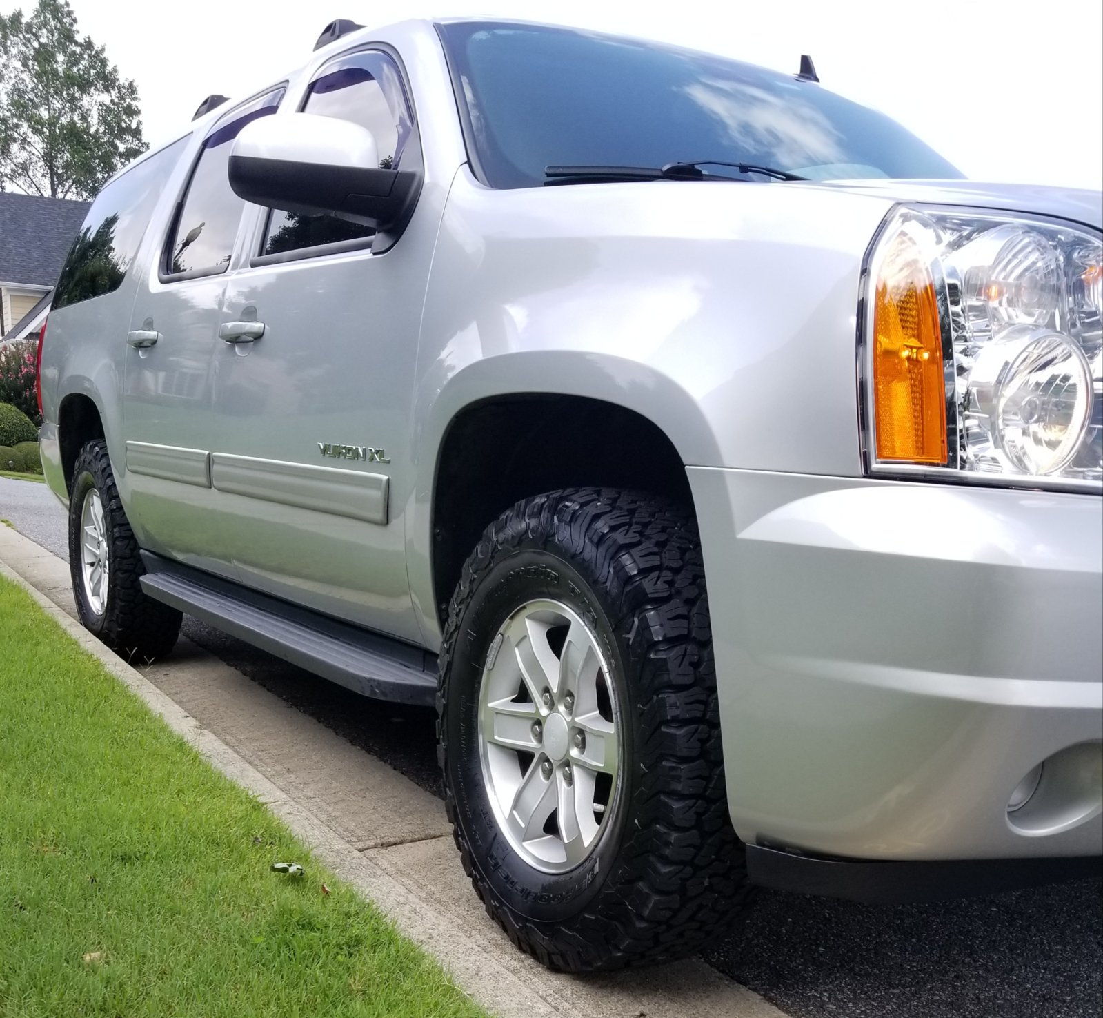

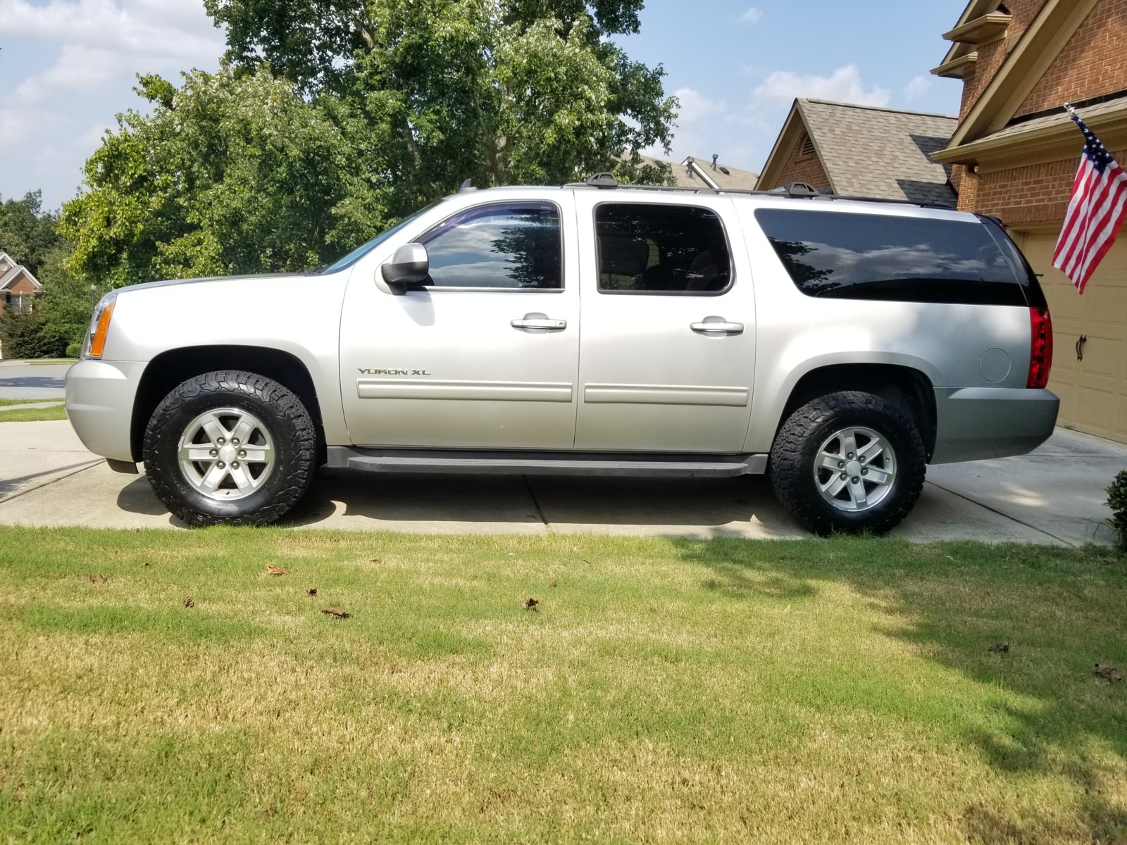

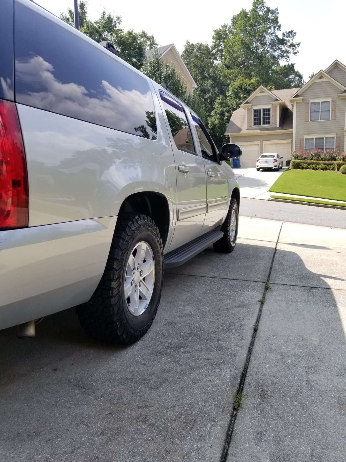

Before and after photos attached. Before is stock with stock size 265/70R17, after is the 2" level kit and the 285/70R17 KO2.
All photos are on a slight decline (front slightly downhill from rear)
