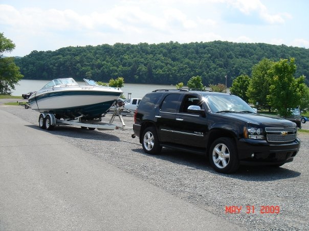

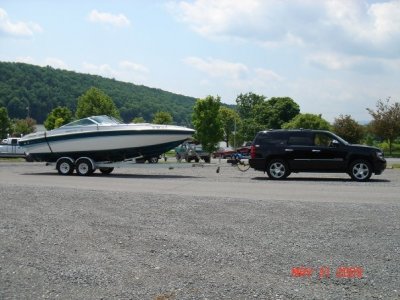

since everyone else was posting photos of their toys... ;)
