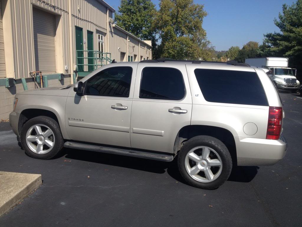

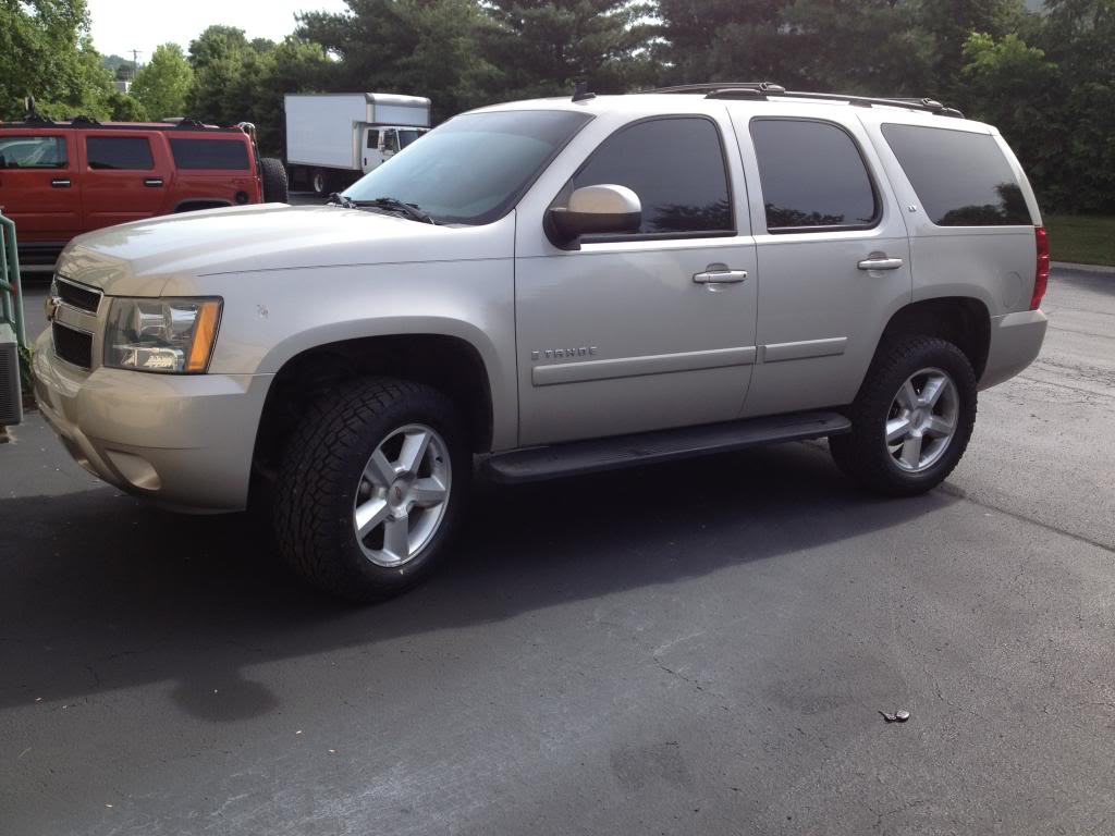

OK, finally got new shoes on her today. I installed a 2.5" TGC leveling kit and it had the dreaded "Cali lean". I couldn't stand it so I bought 1.5" spacers from ebay and installed them this weekend. It sits perfect now. This morning I put on 305/55/20 Falken Wildpeaks on factory 20's. So far they are VERY quiet and super smooth. They ride much better than my old terra grapplers. Time will tell how they wear. Anyway, here are some pics. The first one is before and the last three are after shots.

None on the rear. I trimmed a little behind the front of the front wheel liners and then zip tied the liner back a couple inches. No rubbing anywhere.
