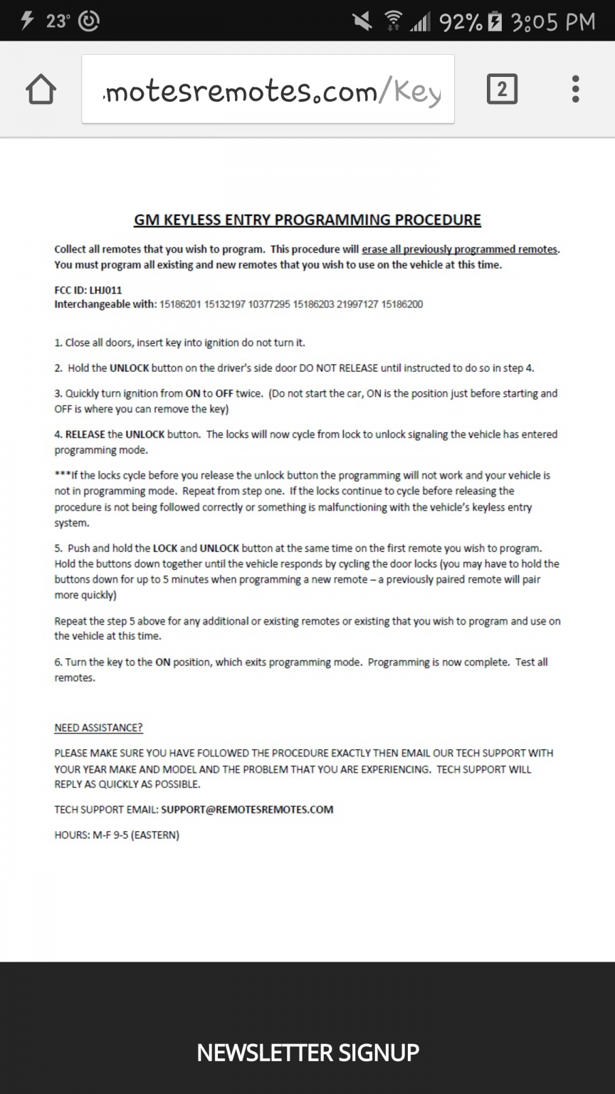

Hey Folks,
My 2004 Tahoe Z71 did not come with a working key fob. It came with a model that had no battery in it, and was falling apart. I checked online and it says its not even compatible with my truck. Here is the number from my remote 16245100-29. I have tried to get this work. I have cleaned it, replaced the battery with three others, no dice.
It seems that I need remote LHJ011
I have been following the directions at:
no dice, it goes into programming mode but my remote does not work. So, do you guys think its possible I have the wrong remote and or a dead remote?

I ordered some on eBAY, the LHJ011 but I quickly cancelled and I bought them from amazon because I had an amazon gift card which work out great!
I did order two of the 16245100-29 from eBay, which they seem that they won't work so I guess that will be a return....
From your above statement I believe you need to get the correct part for your YMM. JMHO and good luck.
