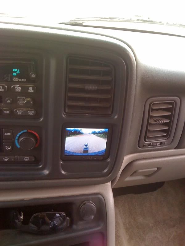

one of my first mods was a rear view camera. sooo nice for hooking up trailers

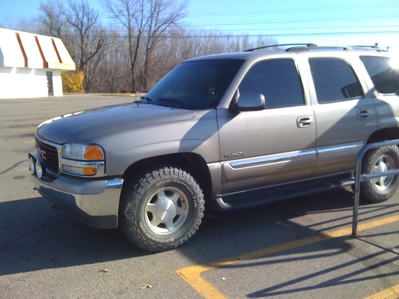

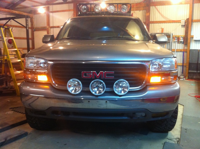

next few mods. 15% tint on the front doors. 32" bfg muds. 3 hella 500ff's with 100w bulbs

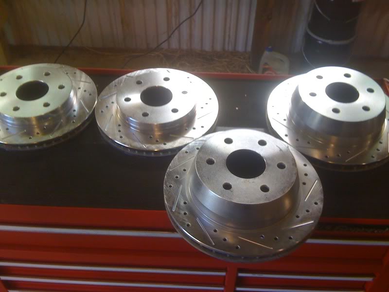

drilled slotted rotors

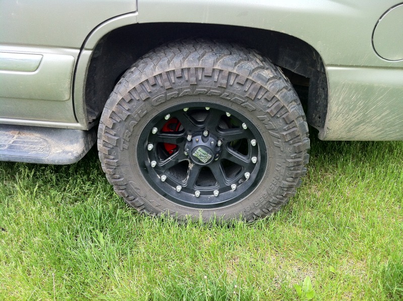

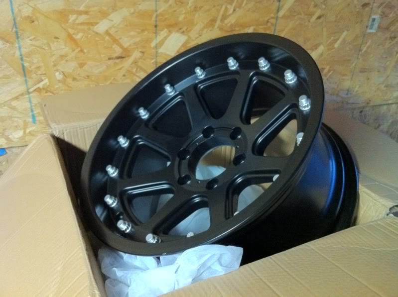

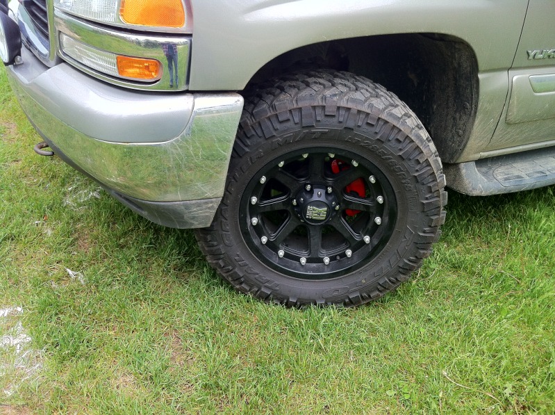

next up, wheels. 18x9 xd addicts -12 backspace
no real pics of it. installed a rough country leveling kit. have z71 springs and 1.5" spacers sitting waiting to go on to replace the stock springs and rc's 3/4" spacer
tire choice: nitto trails. 33's

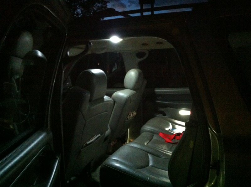

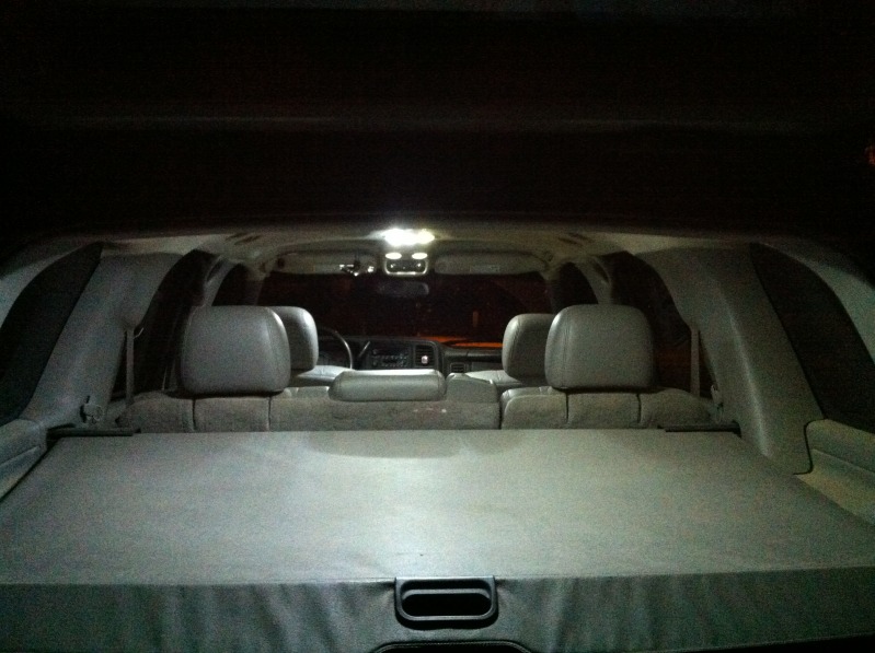

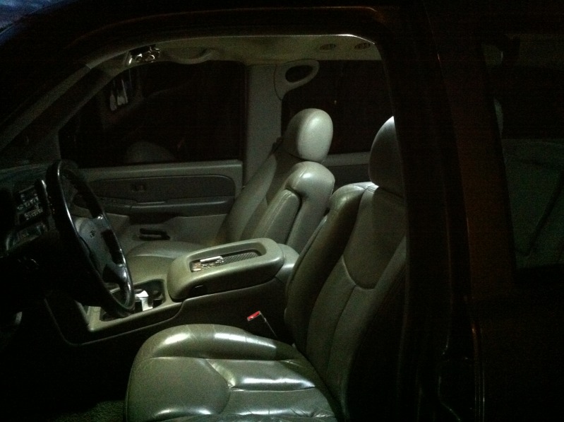

led conversion to all the overhead and door lights

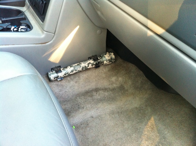

flashlight mount

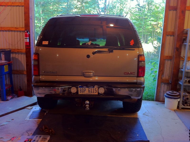

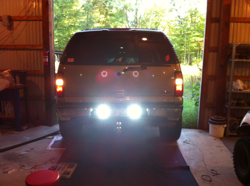

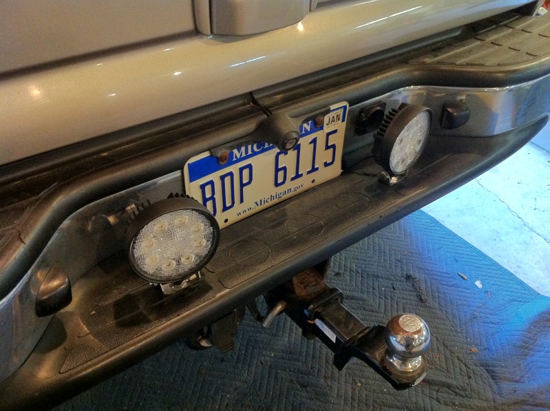

next up was upgraded reverse lights. i have a smaller set from pilot that were under my bumper but they were old and cracked and yellowed so it was time for new ones. 4" led's were brought in

i love it where did you get the back up cam? and the flashlight holder?

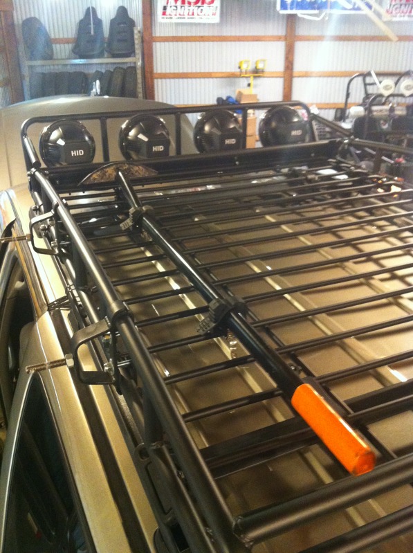

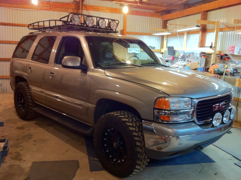

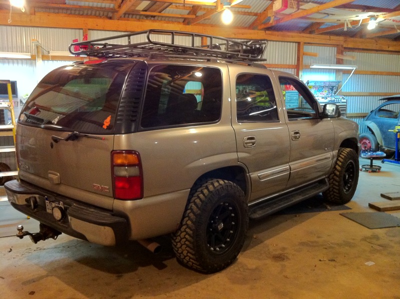

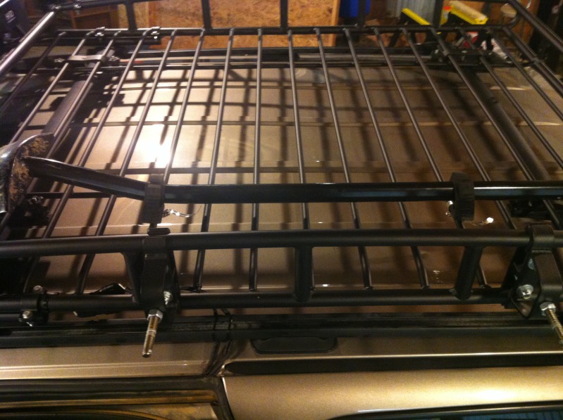

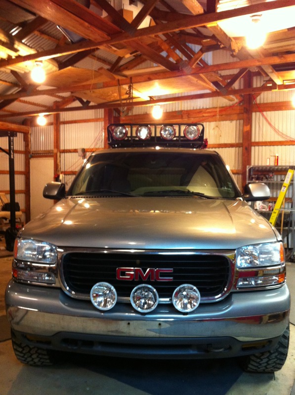

newest mod. baja rack cargo rack. ordered the optional light bar and hi-lift mount to go along with it. being that the rack is almost the exact width of the crossbar mounts i'm considering making custom brackets to bolt the rack down to lower it down slightly. should make it a little more solid too

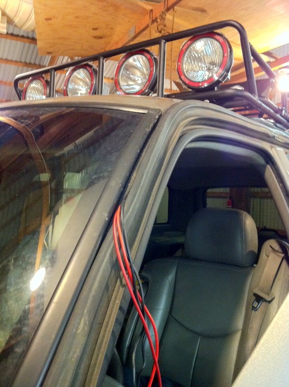

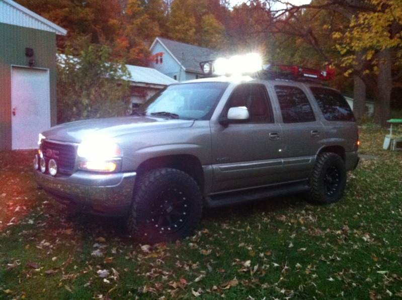

lights are 55w 7's hids. two spots and two floods. sadly, one showed up d.o.a. have a replacement on the way. something i have to mod slightly is drill new mounting holes for the lights slightly back on the mounting tabs because the lights hit the bar and don't allow me to aim them down lower to be effective. sure do light up the tops of trees like daytime though. lol
were i ran my wiring up to em
that for the most part brings us up to date to the mods. future thoughts are an intake. something for mounting or carrying a full size spare. have a netting system picked out to strap everything down to the roof. just gotta order it. considering a cb set up. rolling around a few other random ideas past all that but not really settled on anything else
back up camera came from ebay. someone here posted a find a few years back on someone selling a ton of em for like $30 each. even came with mounting brackets to hold it in place of the pocket that used to be there in the dash.
flashlight holder is just a maglight brand holder. its like $5ish. flashlight is a 3d led mag

Very cool man, love the look and overall idea. I haven't seen to many other Michigan boys (or maybe I'm not paying attention). How is the wiring for your rack lights holding up under the weather stripping?

its holding up fine. its only been in there a week :lol:
got a few things done today. got a new light in today to replace the one that was out. kinda good and kinda bad on that. i plugged it in and saw the color was different so i opened it up and it was a 5k light instead of the 6k the others are. not too far off but enough that it bugs me. lol. so i popped open the other flood light to check the guts and see if i could see what was wrong with it and saw they were 35w hids instead of the 55w they were supposed to be. prolly order up a hid kit and just replace all the guts in a couple of em so they can all be the same 6k 55w lights i want. so basically right now i've got 2-55w 6k spots. a 55w 5k flood and a 35w 6k flood. i'll get this all straightened out and matching eventually

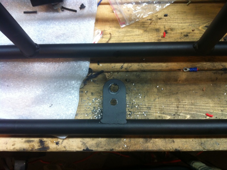

so since i had the light bar down to replace the light, i redrilled the mounting holes for the lights. the original holes mounted the lights too close to the bar so i couldn't aim them down far enough to be effective.

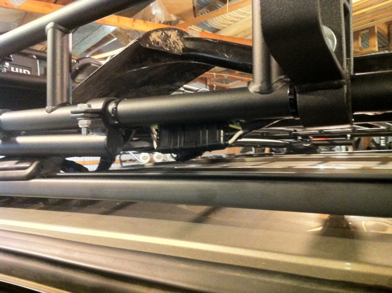

this is what i used to be able to be able to dismount my rack without cutting up any wires. theres 2 - 4 way trailer harness connectors. each one runs power/ground for two lights. if i need to pull the light bar off its just a quick unplug

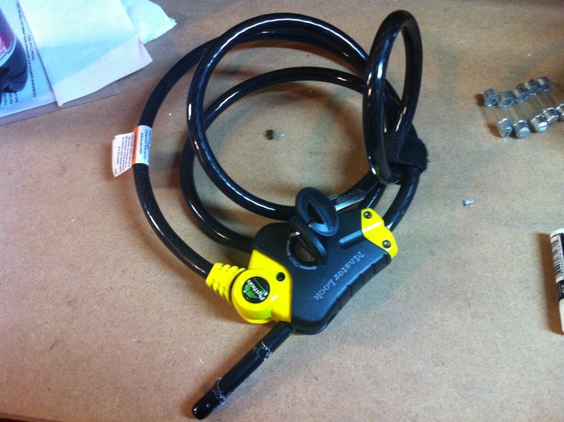

next, i picked up this lock to thread through the hi-lift for a little security. unfortunatly i don't like it once i played around with it. the locking mechanism seems pretty cheap and possibly prone to getting moisture in it which could freeze up in winter and make it next to impossble to unlock. kinda dissapointed since i expected better from masterlock. i think i'm just going to make my own cable in the next few days and use a weather resistant padlock

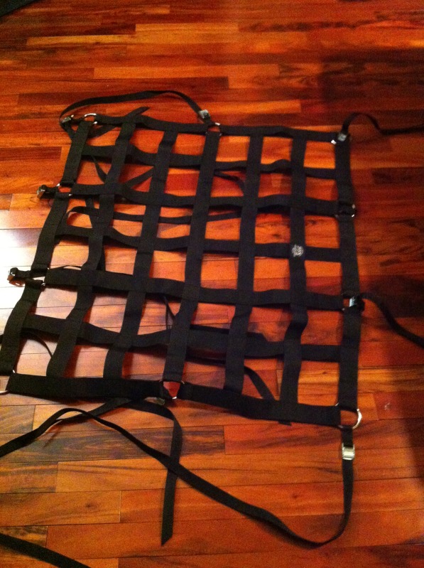

and got this in today. its from safari straps. 2" webbing. the large model like 46x40 or something like that. should work good to hold everything down on the roof

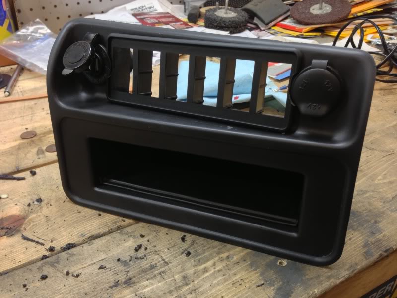

started a new switch panel. also has a blue sea usb port on the left

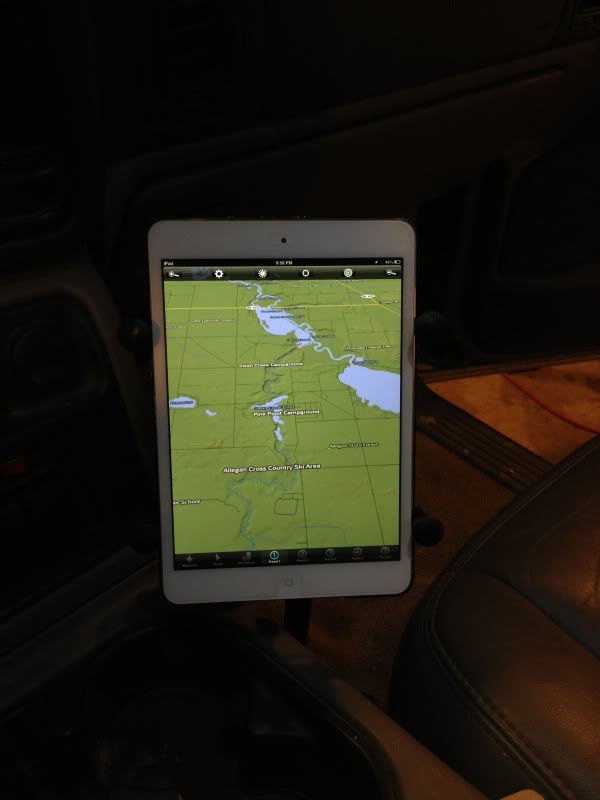

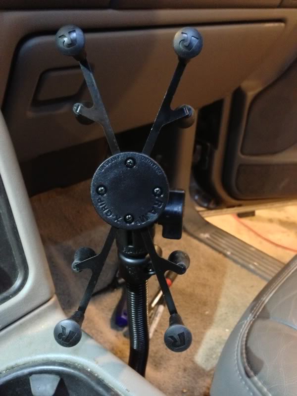

finally got some motivation to do some tinkering today. went and installed a ram mounts x grip tablet mount for my ipad mini
http://www.amazon.co...0?ie=UTF8&psc=1
i have "scenic maps" app. seems pretty good. preloads a ton of topographical maps to use
as i had bought a wifi only ipad i need something to get me a gps signal to help track where i am. i'm pairing my ipad with this
http://www.amazon.co...ual gps xgps150

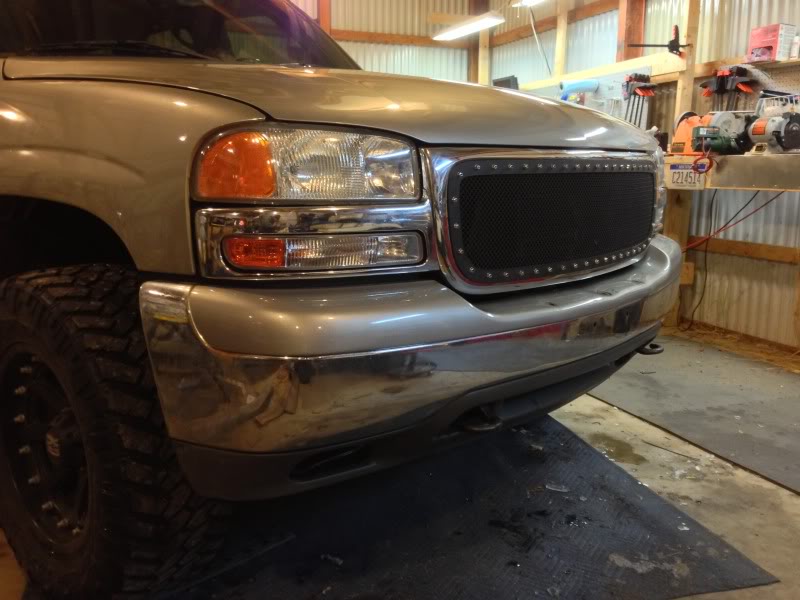

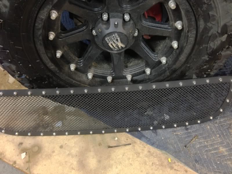

ya gotta match your grill to your wheels

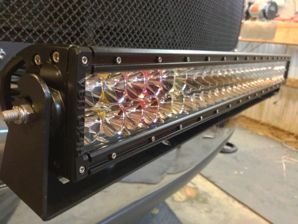

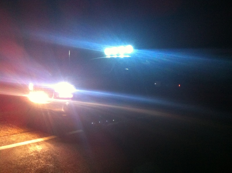

so i got me a led light bar. its a rigid industries 30" combo. original plan last weekend was to bolt it down where the hellas i took off were. wasn't enough room cause it would hit the grill. plan b: mount it behind the grill. while it fit...it was a very tight fit. almost no room between the trans cooler and bar. plus the bar blocked almost the whole cooler. plan c: make some brackets to space it out in front of the bumper a bit. while its not the most ideal spot imo, it works. very happy with it. all kinds of really bright

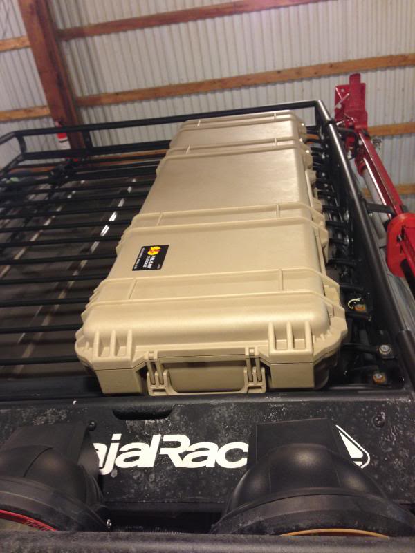

its a pelican 1720. plan on storing most of my recovery gear up here to help free up some room inside the vehicle and have less things bouncing around in case of an accident. mostly going to be high lift accessories and straps and such. still need to cut off the ends of the u-bolts but i was cold and tired so i decided to do it later.

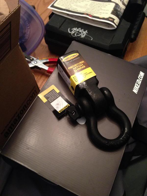

got one of these things
---------- Post added at 08:13 PM ---------- Previous post was at 08:12 PM ----------

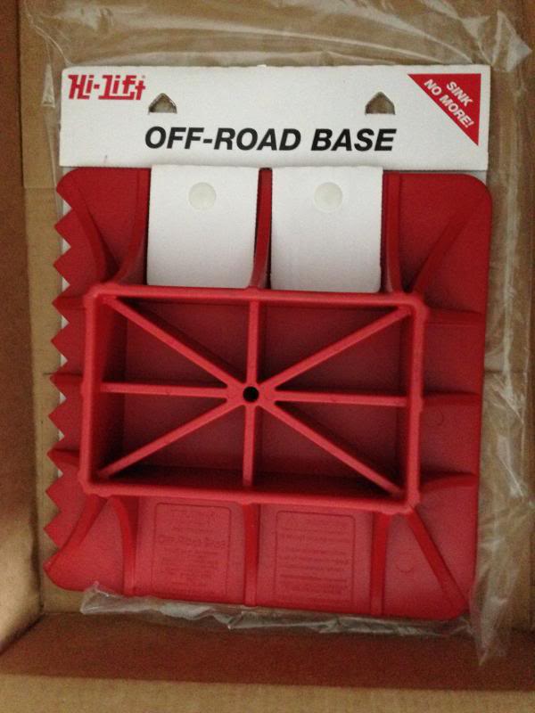

added a hi-lift base to complement the tire lift and bumper lift i already have
---------- Post added at 08:16 PM ---------- Previous post was at 08:13 PM ----------
grabbed some rigid d2's in amber with a driving beam. looking for better bad weather visibility. these will go in behind the grill once the snow goes away some and i can get in my shop and install em
slapped on a couple new trail grapplers

Loving that pelican case and the d ring receiver hitch. Cheers!
