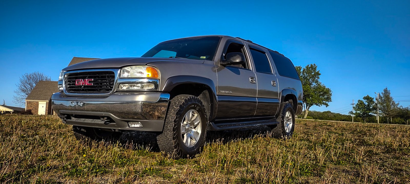

2002 Yukon XL 2WD 5.3L SLE, stock tires were roughly 30.49"...current tires are roughly 32.8" Load Range E.
YukonMike66
Aug 1, 2023
42
53
So my Yukon has tires that are nearly 33" and they are load range E....stocks were about 30.5" ...if i go back to 30.49" tires or even 31's, will i notice a difference in the way the vehicle feels in regards to power. The 285/70/17 BFG K02 Load Range E's are really heavy and sit right at 57.9 lbs each.....stocks were 36.56 lbs each according to what i found online.
The question is...will dropping 2" to 2.5" of tire and over 20 lbs per wheel make a measurable difference in feel...or should i just leave it as it is because the difference isnt enough to notice? Hope that all makes sense.
