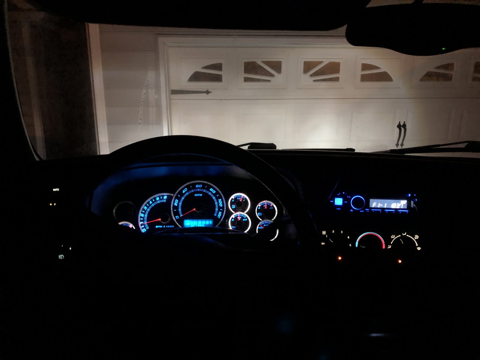

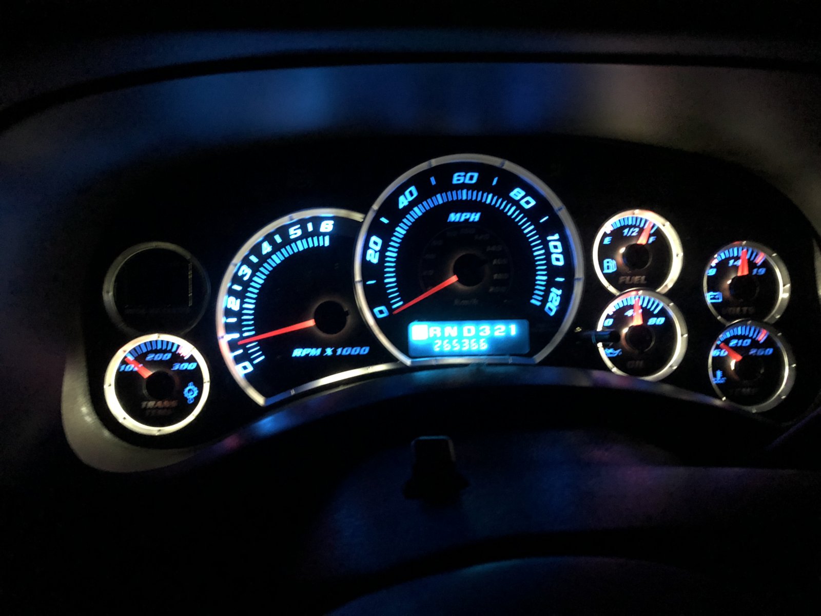

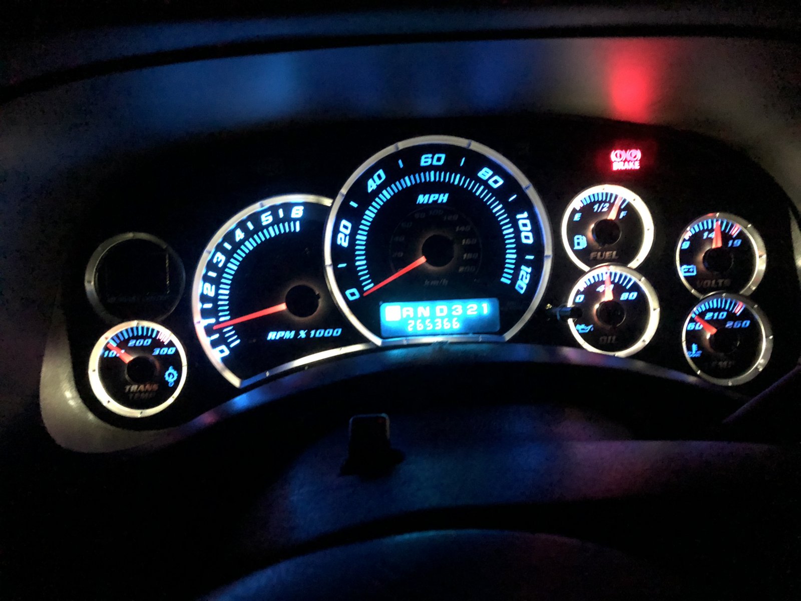

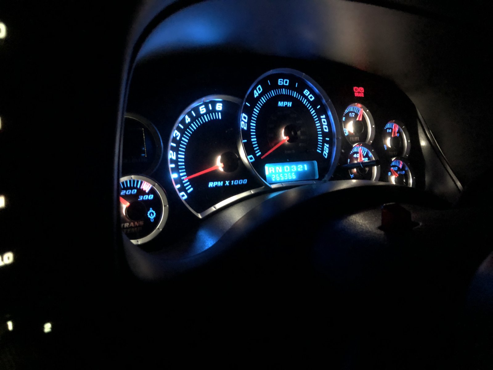

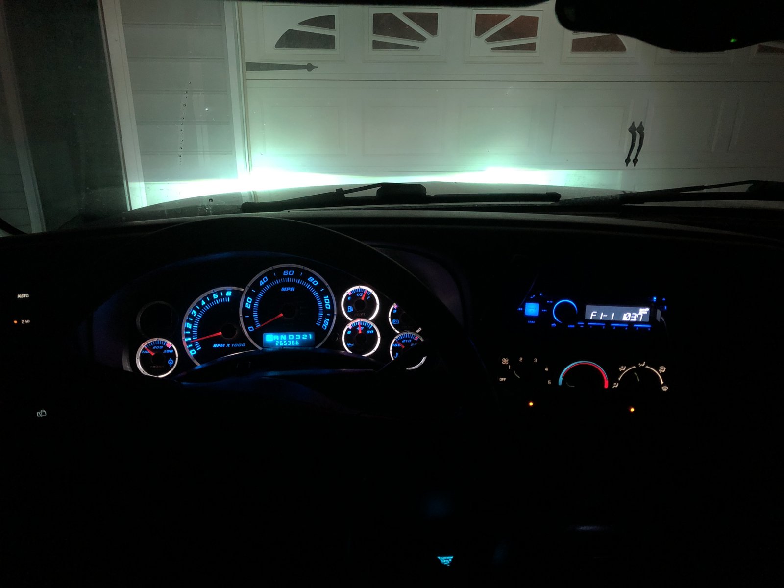

Went to work super early today was able to get good full night pics of the gauges and headlight output.
These show the white bleed through on the trim rings, is that how this cluster are suppose to be? I’m thinking about taking it out and blacking out the back of the silver trim rings cause I hate the light coming through. And does anyone have advise on what less to put in this thing to get even lighting?

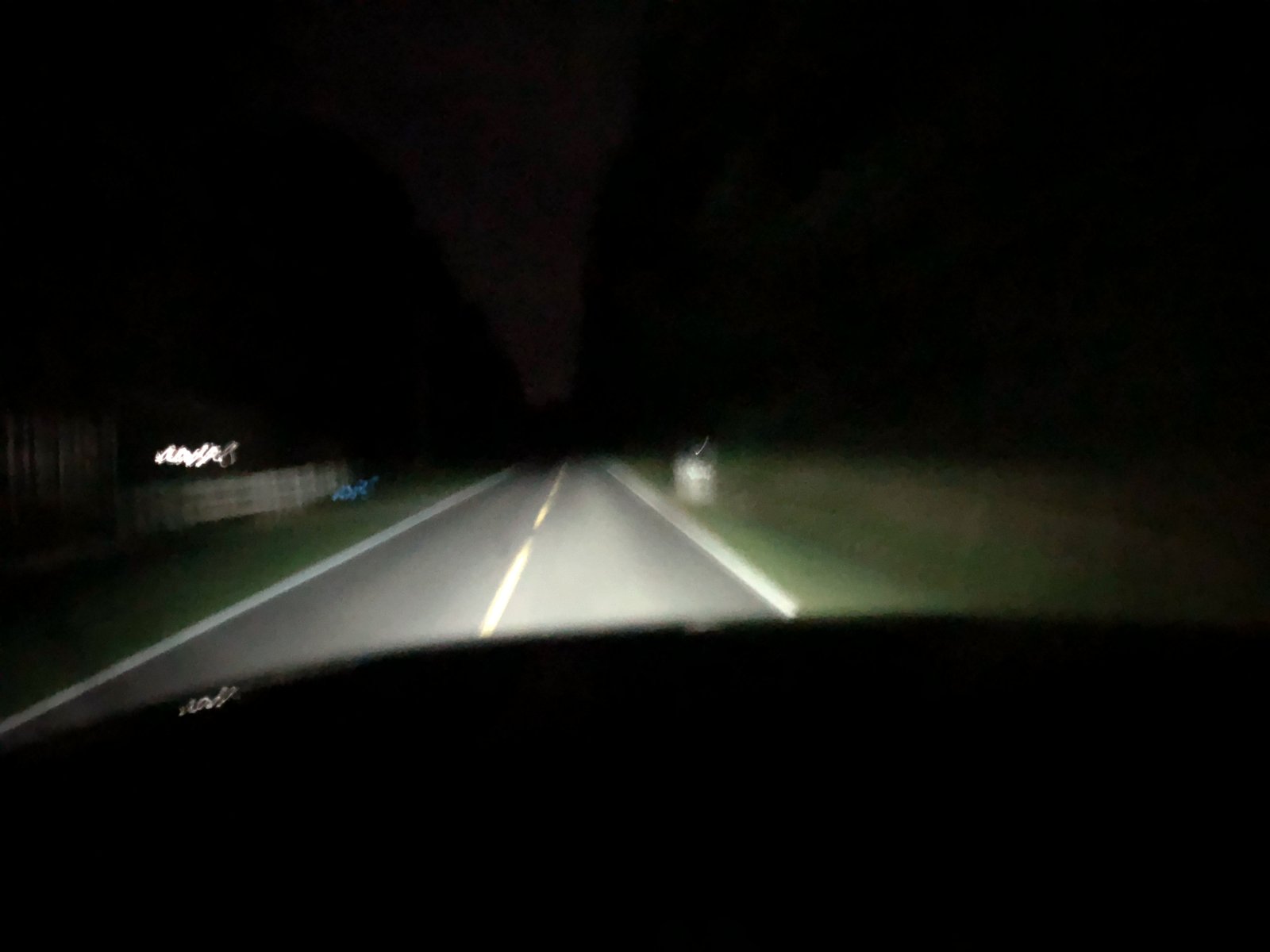

JDM 3030 switchbacks
JDM 3030 DRLs
Kensun 35w 6k HIDs in low beam
Auxbeam F-S3 hi beams
This is one set of the JDM Astar 3030 switchbacks. They’re really bright!
Not sure why the HiDs look greenish in the photos? It’s pure white in person.
Low beam hids at 5 feet
Low beam hids at 15 feet
Low beam hids driving

Shouldn’t drive with your ebrake on.... not good....smh.... ;)
crafty333
Jul 31, 2018
That's been my next upgrade. Also considering just smoking or tinting the lenses. It's low priority on my list, but it really does make a killer difference.

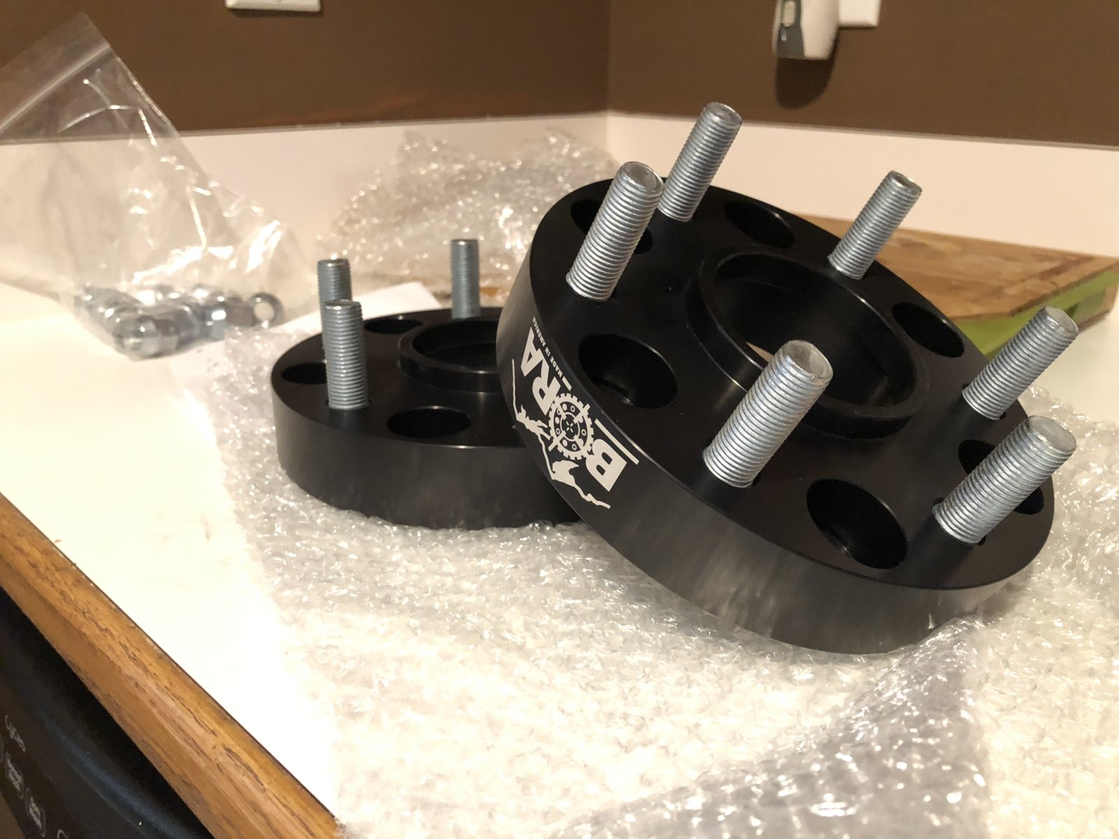

You gonna be trimming some studs then, I take it? Maybe you are qualified for @yates ™ position.
:happy175: You cheeky devil you.
And hopefully no trimming required. Classic IIIs have the recesses on the back, measured them before hand, 0.6” depth so with 1.25” spacers we are at 1.85” of clearance for the studs.

How long are the studs?

Never measured them so I dont know the exact length. But 1.75” spacers fit without trimming the studs so they have to be shorter than 1.75”. I just went with that, might have to grind the ends down at most.

Next time I have a wheel off, I'll have to measure how deep my indents are. I know recently @Shaw520 went 1.5 with no trimming. He had indents, too.

Yeah I just focused on keeping spacer + indent over 1.75” since that what everyone says clears without trimming. Kind of dumb of me to not just measure the stud when I put the 2” spacers on a couple weeks ago.

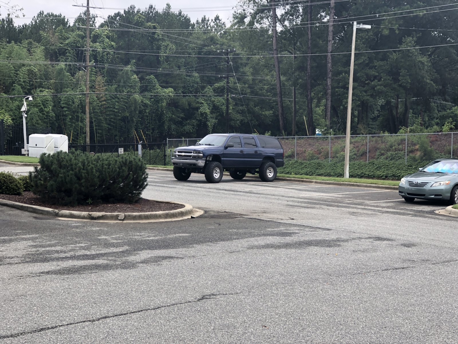

Welp not much has changed, just driving it at this point. Health is still up in the air and haven’t felt good lately. Hoping to work on it this weekend. In the meantime here’s some random photos.
Pretty much every morning at the end of my road I see the sunrise.
School went back Monday, let the indoctrination begin. Wish they’d just put them little ones on the bus and not clog up the roads with their stupidity.
Back in my spot!

Not that this helps either of you in any way shape or form, but I have 1" spacers on my wife's Denali and no trimming based on the cavities on the back of the rims.

Dang thats definilty not the norm, I measured when I was planning it out and I should have around an 1/8” clearance with the 1.25” spacers and the indents in the back of the MT Classic IIIs. Still haven’t put them on yet though, lol
