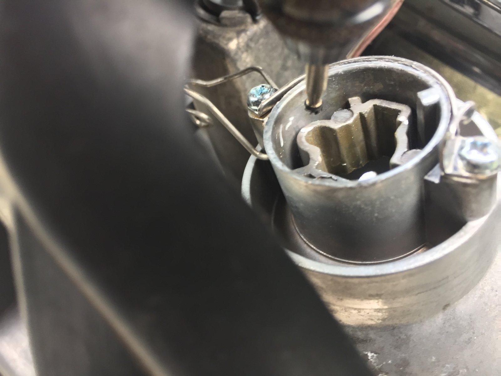

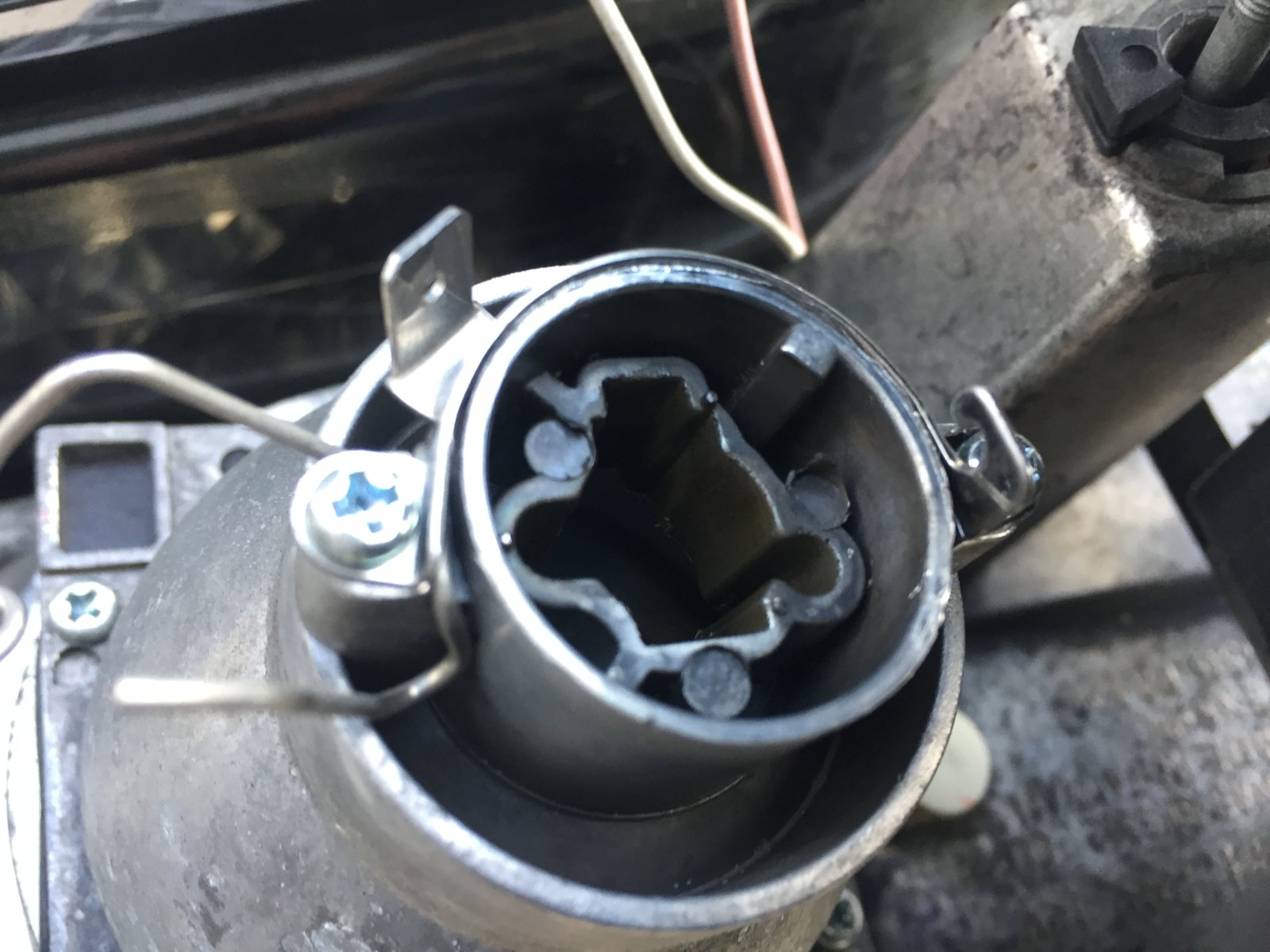

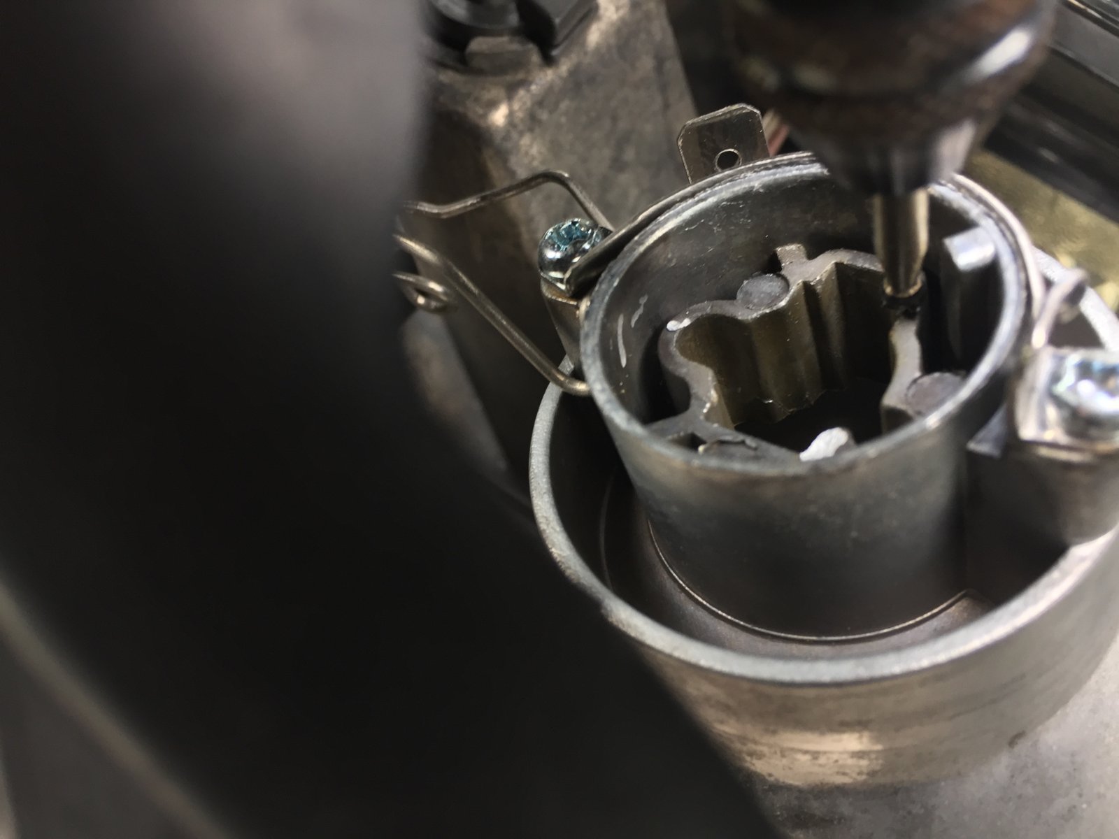

Swapped to 6k lows from 10K. Also I have always had trouble getting the bulbs to seat properly in the projectors. They are the cheap ones that come in the “sypder” headlights, they have 3 numbs inside the projector for the bulbs to sit on, problem is the numbs aren’t even and the tensioner spring causes the bulbs to sit at an angle.
Problem solved now that I have a Dremel.
The 3 little highlighted spots are where I ground down the numbs.
Bulbs sit perfectly flat and do not wiggle at all.

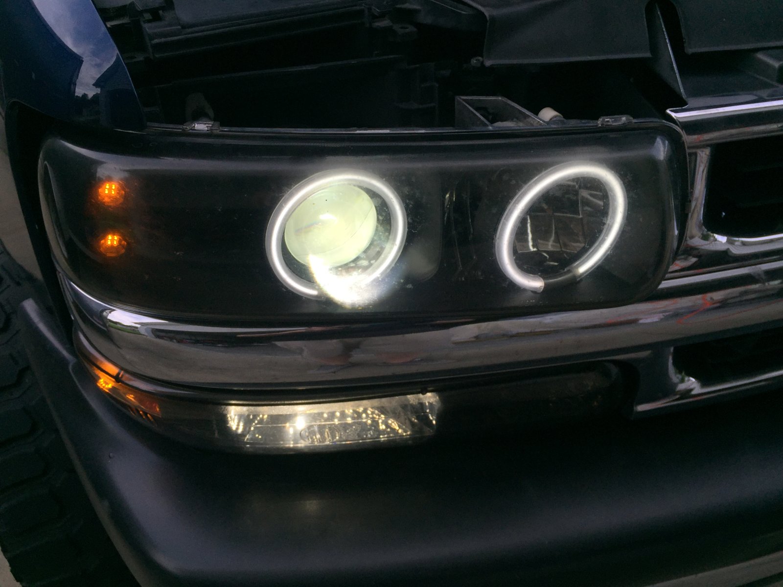

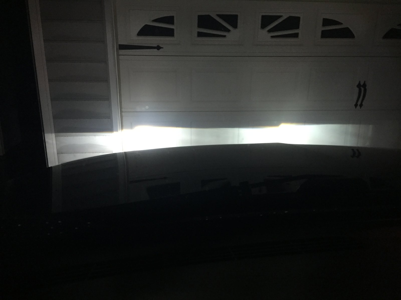

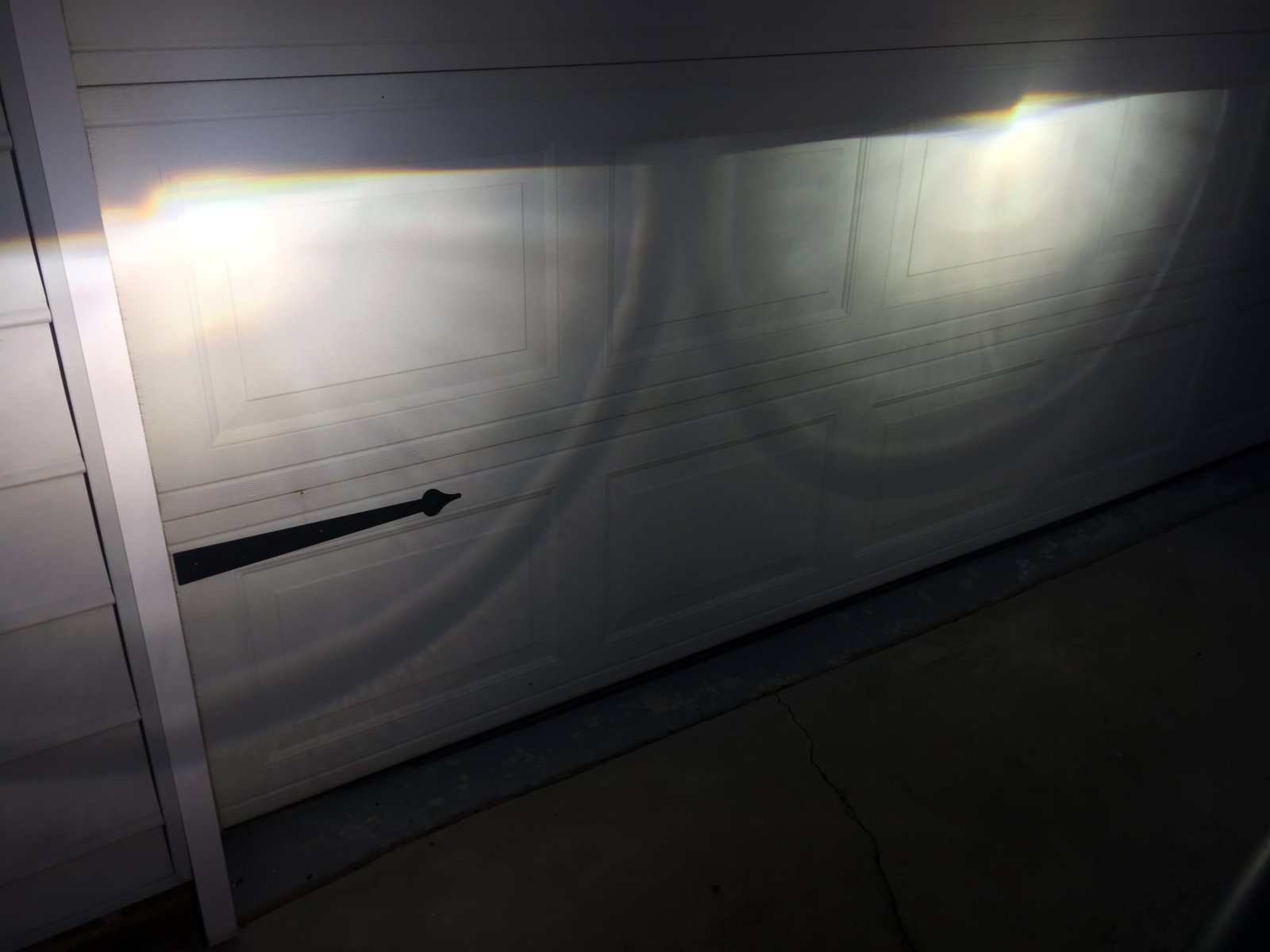

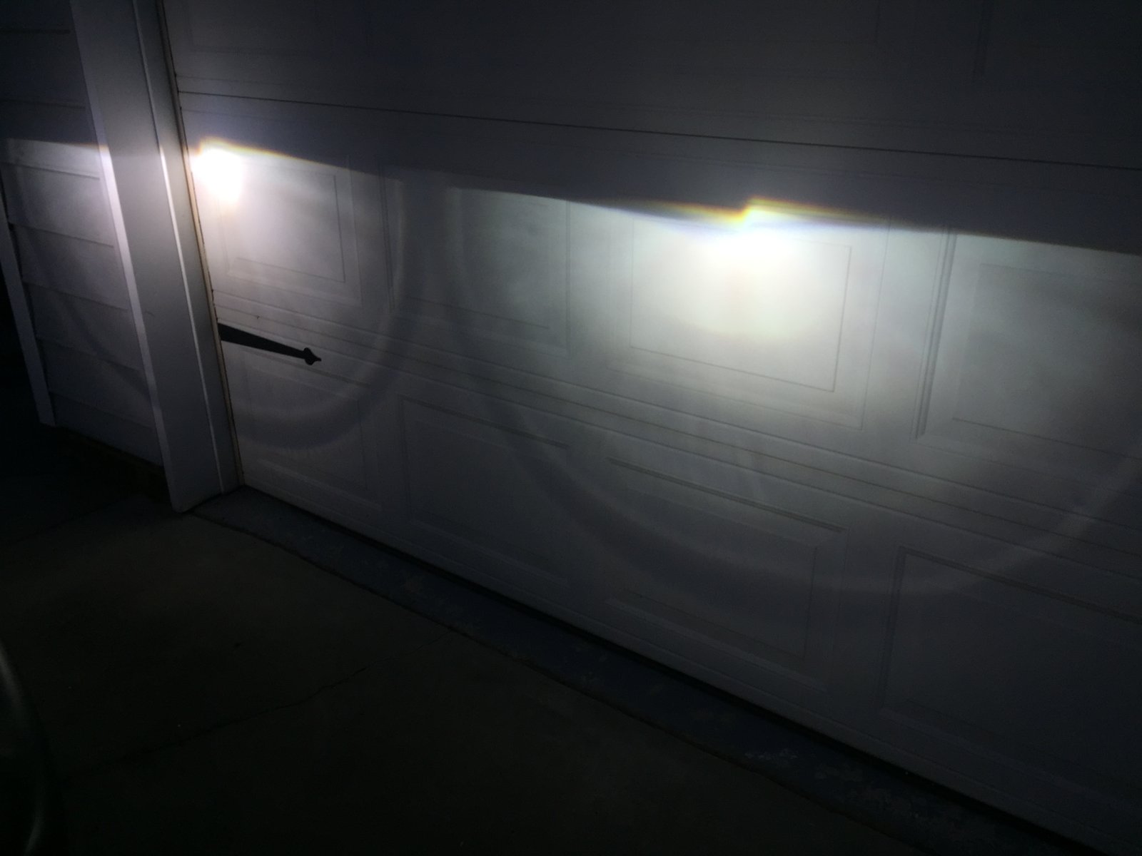

Might be sending them back, they came in a box together they were both labeled 6k....they look the same color when you look at the projector but on the wall they appear to be 2 different colors. Hopefully the color will set in over the next couple days and they will be more even. Don’t mind the ****** cut off you get what you pay for and TRS now has quick swap Morimoto projectors for Spyder headlights so those are definitely incoming soon.
Hot spots are amazing now with the numbs ground down, dead center of the cut off and buuuuuright!

Can you center them more on the garage door, maybe the side of the door is tricking our eyes(color wise) i doubt it tho, but worth a shot.
00'BlueSteel
00'BlueSteel
May 8, 2015
878
1,371
Carolina
I’ll have to check tonight, sun was up when I left the house this morning.

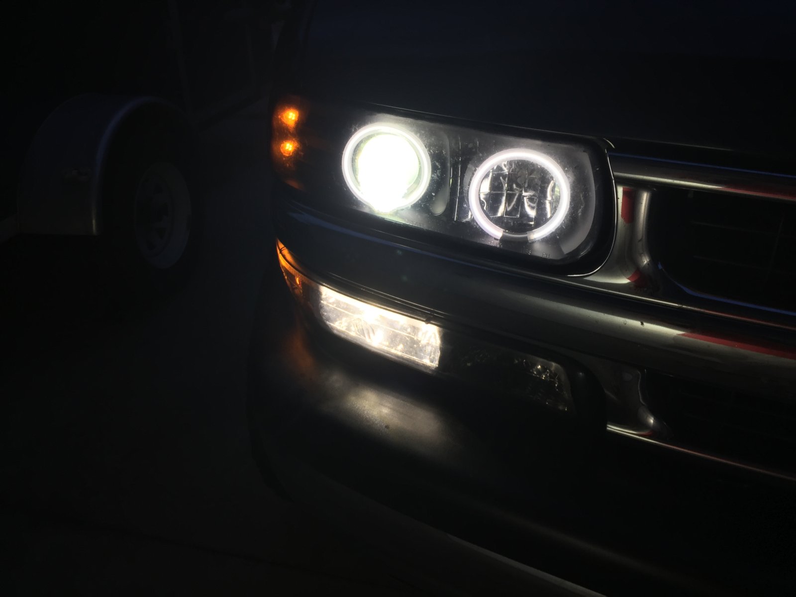

Welp got lucky the color evened out to a true 6k, won’t have to send them back. Color is much whiter in person not sure why the iPhone makes it appear so yellow. Either way I’m happy with the new color and the light output, they are far brighter than the 10k bulbs.

Yep 10 k isn't the best for actual usable light.

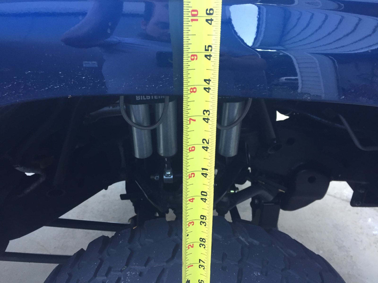

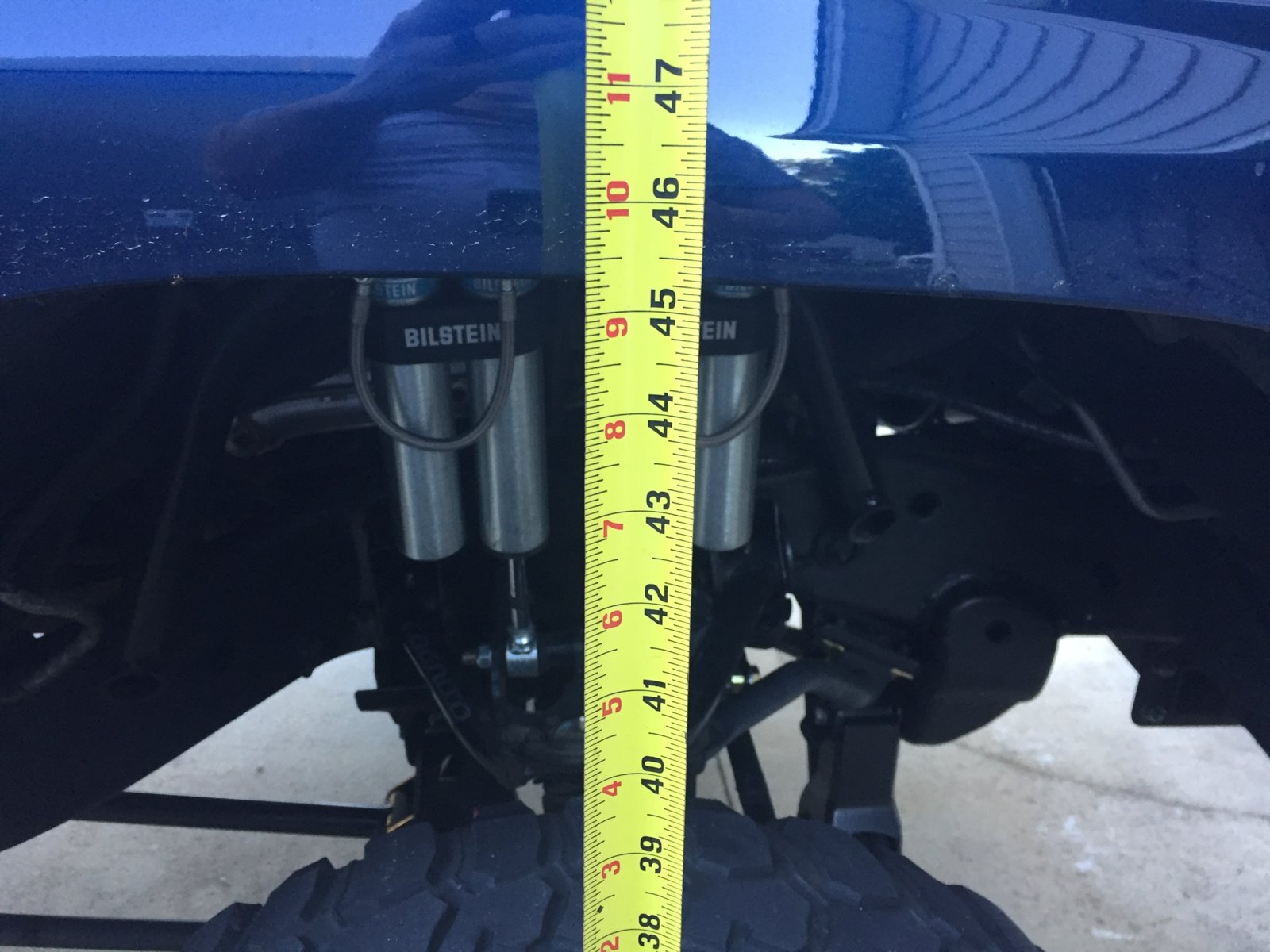

When I rotated my tires I documented the fact that when I set the front of truck down after having the wheels in the air it sits up higher until I drive it again. 1.75” higher to be exact.
45.5” fresh off the jack stands
43.75” after driving
No real point to this other than a guy asked about it and it made me want to see the numbers.

Funny how that is.
