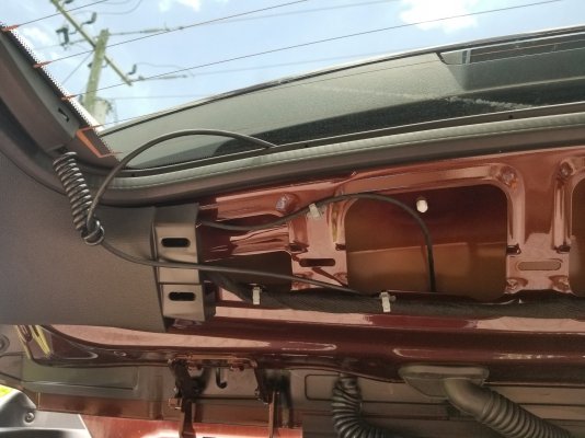

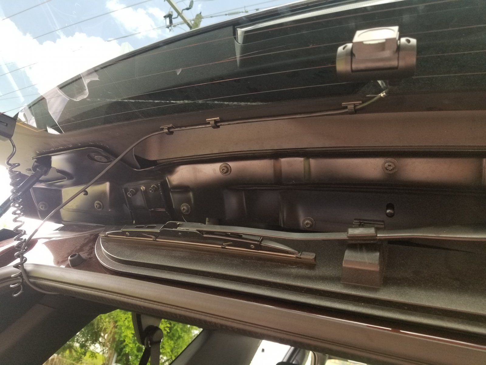

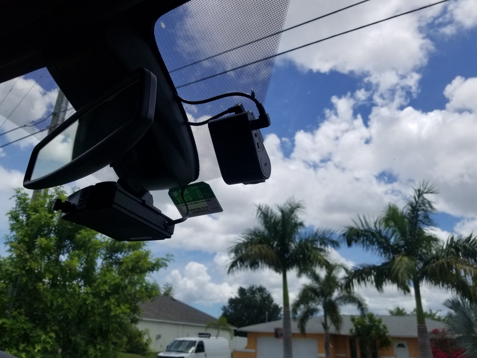

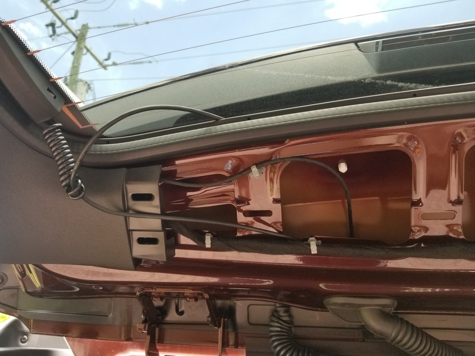

Here are a few pics from my install (didnt feel a need for a new thread).
I would like to note the USB included with the 2 channel setup was "just barely" long enough be be proper for a Yukon XL.
Nice when a project just works out.

the annoying cable in the back cannot be tacked in or the back glass won't open. so we have to live with that.
