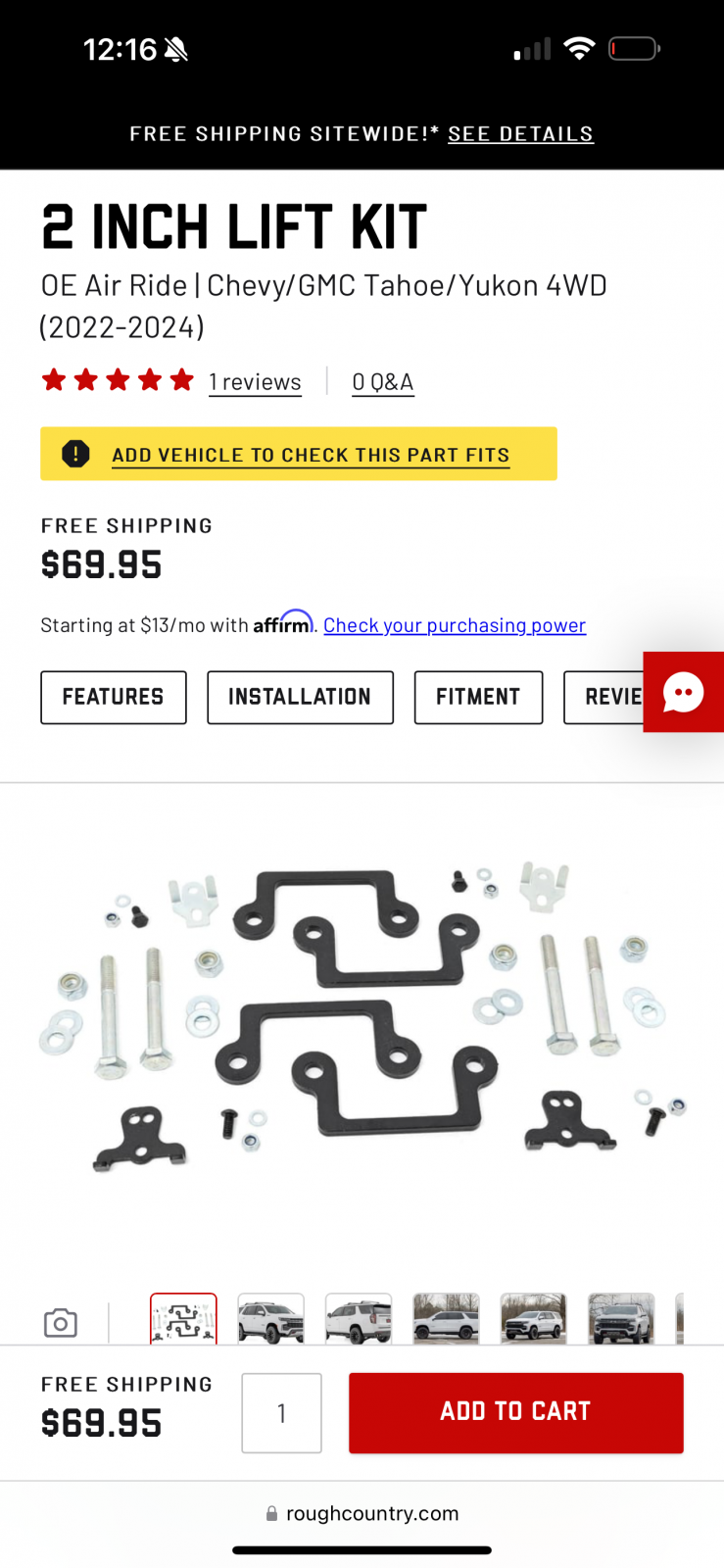

Has anyone used this kit? Other than the links seems like this is th only kit available for air ride equipped vehicles

I cannot directly assist you on this question, but kits sold by Rough Country are quite popular with folks on this Forum., @Trey Hardy may be able to give you some pointers on your question.
