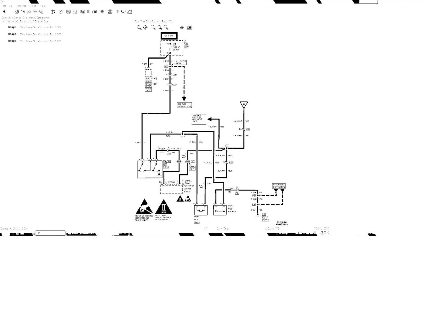

neutral is only require when going in or out of 4lo only.2hi to 4hi or vice-verse can be done at any speed. you can remove the front actuator and observe it operation with ignition key on and in park it should extend within a few seconds when you press 4hi. if not check for voltage on the light blue wire. start with that.
boots1986
Mar 3, 2013
where are there commonly shorts I found number 24 fuse burnt replaced it tried going into 4 hi and it poped the fuse instantly
---------- Post added at 02:16 PM ---------- Previous post was at 01:34 PM ----------
im currently searching through haynze manuals for a wiring diagram but can't find one
SunlitComet
OBS Jedi-Do Good
Sep 30, 2010
16,206
188
unknown at this time.
there is a harness on the front actuator trace it back to the transfer case switch and then to firewall bulk head connector. fuse to switch is brown wire. from switch to actuator and feedback switch are both light blue wire. all harnesses should flow on the left hand side of chassis.
boots1986
Mar 3, 2013
thank you for your help I found out it was a dead short in the actuator
