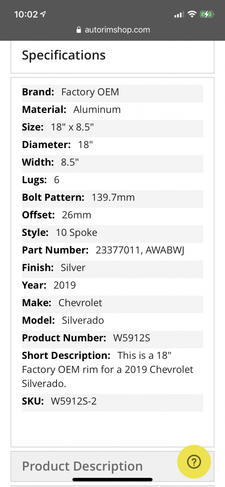

The fit...In my case, I have the 20s from a 2018 Silverado but there is plenty of clearance for 18s also. Just match the tire size or have your speedo reprogramed.

Look at my sig. I’m running 18”s and have zero fitment issues. Factory 265/65/18. I’m pretty sure you can run a 285 without rubbing… others will chime in to tell me I’m wrong if I am… they love that shit around here… LOL

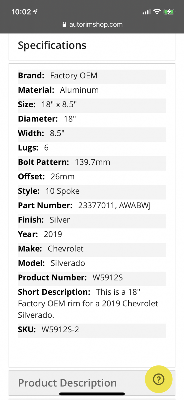

My Silverado rim specs for comparison

Our Tahoe came with the 18x8 Z71s so I know those fit but I didn't know if the extra projection on the newer ones due to extra width and different offset mattered, but it appears not.

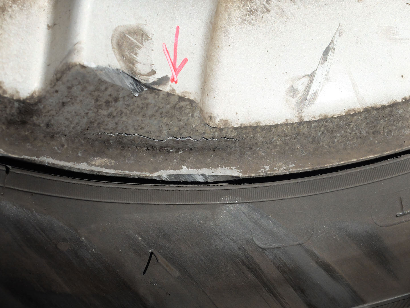

Fifteen years of winter chemicals eroded the paint and machining on all plus a recent incident with damage.
