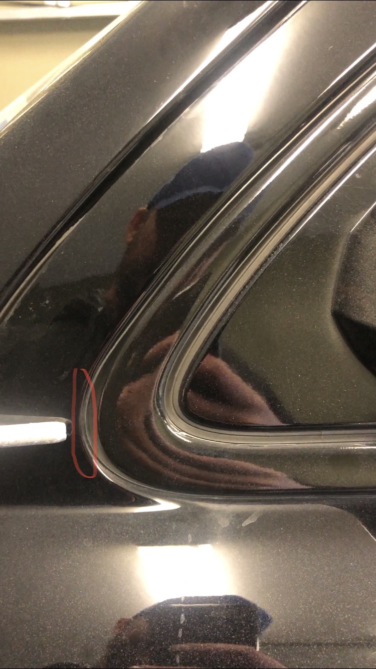

@Prospect62 , cooler morning so went back at it. Cautiously optimistic but I think I finally duplicated the sound. Seal just in front of the drivers door mirror, was whistling like crazy when I hit it with the air gun, no sound anywhere else around the door/window. My wife sat inside the truck for me and confirmed it was very noticeable from there as well. Trimmed it back and pushed some grease behind it, we’ll see. Mines too intermittent to know for sure this did the trick on a single test drive, but could be an interesting spot to apply your painters tape and go for a test drive

Thanks @nick14226 that's very helpful, I will try mine!
My noise wasn't really a whistle like you describe it, more of a low pitch "howl". But it's a starting point!

@Prospect62 , reporting back and very disappointed to say, what I found above was not my issue. I then spent about 40 minutes driving back and forth on a 55mph road between two parking lots testing with painters tape in every area I could think of, one at a time, on a cold afternoon. Taped along the hood, then the windshield, door, window, b-pillar, shark fin, roof rack, door handle, side view mirror. Every time that stinking noise was there, and I didn't notice it changing much in pitch or loudness trying all those different things. Had my windshield replaced due to a crack and was crossing fingers, still there. I'm back to the drawing board.
