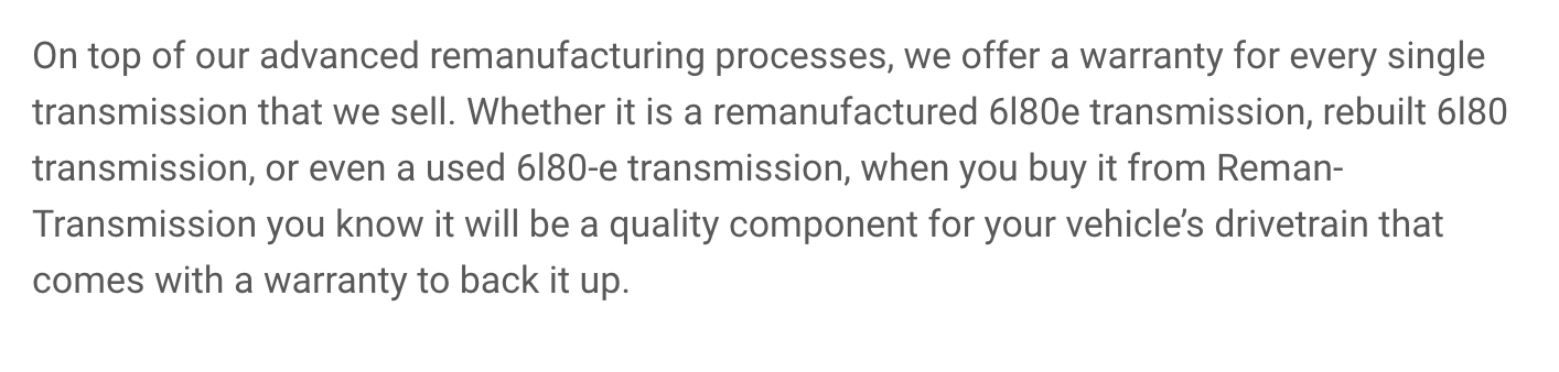

Was looking at remans and found em to be 2500 or less from what appears to be reputable company's. (Imagine Core refund as well?) Just about 15 mins of browsing tho. Would assume a shop would install roughly the same 3k tops. Midwest, where shit gets done. Also have a floor jack and 2x4's worst case. (Worked in a 360 dodge 2500) heavy sum beaches tho!
Please post a link to where you're seeing remanufactured 6L80s being offered for $2500. If that's truely the price, it would be, by far, the cheapest ive ever seen and borders on flat rate pricing.
Most reputable reman units cost between $3500-4500 or so depending on what's going into them (and there's quite a lot - for an idea, visit me 6L80 info thread via the link in my sig).

I was looking at remans @ rougly 2.5k. Imagine labor would be the same maybe 3k. Midwest where manual labor ain't crazy. All else fails I got a floor jack and 2x4's. Worked In a 360 dodge 2500. Heavy and scary but it worked.
