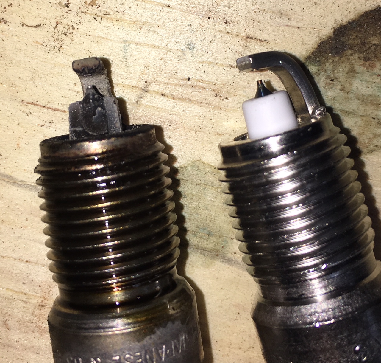

Well I found my problem. #7 misfire. went ahead and replaced all plugs and wires. Runs smooth as butter now.
