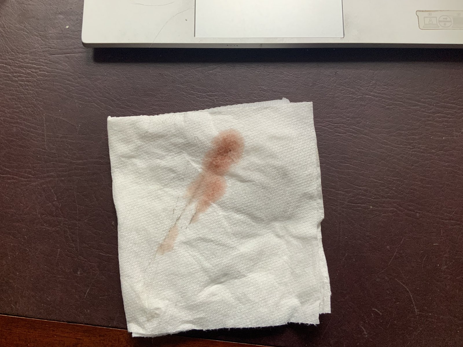

Just checked the dipstick
looks fairly new, red colored, no burnt smell at all

id still just do a pan drop and filter change.
thats looking pretty good for the miles.

Wipe the dip stick off very, very, very well
Then pull a sample
Note the smell, put it on a white surface and look at it under light (air filter box sticker)
Exclusion criteria:
- Floating particles
- Burnt smell
- Dark enough to be confused with engine oil
- Milky in appearance
If none of those exist, you're good to change it!
