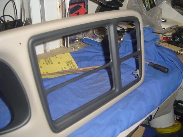

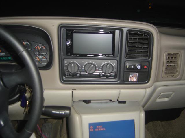

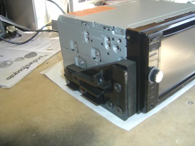

You can, but you have to make new mounting brackets, trim the dash bezel, and depending on which dd unit, you may also have to remove the metal brace that is behind the radio/hvac housing. Here are some pics to give you an idea of how I did mine:

Yes it can, I had the Alpine IVA-W505 dd installed in my 02 hoe yesterday.
