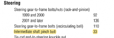

If you do replace the lower intermediate shaft, definitely make sure to torque down the coupler/pinch bolt to spec (33 ft-lbs per Chilton book). Getting the bolt "tight" may not be tight enough as I initially found out during installation. Only after going back with the torque wrench, did the last of the slop disappear. I was getting a bit nervous myself -- fearing that the bolt might snap off before hearing the click on the torque wrench, but I did finally hear the click (or beep, depending on your torque wrench). When I'm extra paranoid, I sometimes put a digital torque adapter in between a click-type torque wrench and the bit to double-check in case calibration is off.

Good point on the torque specs. Steering, brakes and suspension are important things to adhere to torque specs for.
