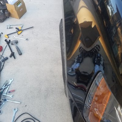

After installing the passenger side and putting the wheel/tire back on. I did not notice a difference at all, in fact the caster camber is so far out it looks lifted. Now I know I'm going to need an alignment but it looks crazy.
Now, since the Pedders drop coils are advertised as a 2.33" drop and I used BellTech 2511 spindles and set the struts at 1/2" higher than stock to compensate for the lower coils.
I'm never good with getting pictures. I forgot to get a side view but, you can see how bad its out. And I also took a picture of the lower ball joint cut down. I don't think I've seen anyone post that before. Probably cut 1/3 of the nut down.

The suspension is only "seeing" about 2" of drop (technically 1.83"). The drop from the spindles isn't supposed to affect anything in this sense. 2" isn't much and should result in a little bit of negative camber which can probably be aligned out just by adjusting the stock alignment eccentrics. I'm thinking the alignment bushings over-compensated for the minimal negative camber the drop caused and now you have positive camber. Hopefully the stock eccentrics have enough adjustment to bring it back in.

You need to have the weight of the vehicle on the suspension before tightening the a-arm mounting bolts. If you tightened those bolts with the suspension at full droop, the a-arm bushings are keeping the suspension extended, as you are seeing. Keeping them like that will reduce the life of the bushing.

I did not, I suck. Its so damn cold out and windy, I tightened everything while up in the air.
After I remove the spacers while its up I'm going to loosen everything and get that all buttoned up and reinstalled, I'm going to put it on the ground and retighten everything.

gotta let that thing settle man. get everything tightened up and put together and take her around the block a few times. May sound crazy but find some smoother dips so the truck goes up and down a little while driving, then take it to get a alignment. those bushings aren't made for any specific setup, they go with anything (except some of the custom controls arms and what not out there but that isn't the case here). I don't think there is a need to pull any spacers unless you are unhappy with the height (which I wouldn't determine until it has somewhat settled but that is just me). the tire sticking out like that happened to me on my nbs after I installed a camber kit and I was 5/7. Drove it to the alignment shop a few mins away and it was taken care of no problem.
you gotta think, your hoe has been sitting up in the air with everything extending out a stretching, so its gonna need some settle time with all the brand new stuff. I've cut that bottom balljoint bolt on a few different vehicle and what you did is perfectly normal.

Just came in from loosening the control arm bolts that I thought I tightened haha. They were lose, its back on the ground now, I'm going to go tighten them back up and start on the rear.
All very good points Cody. Thank You very much, I appreciate the info. I'm going to go start the rear now and hope to get it done today so I can boot around the block with it to get things settled. Then I need to find a decent alignment shop. Worst comes to worst, there's a dealer right down the road.
