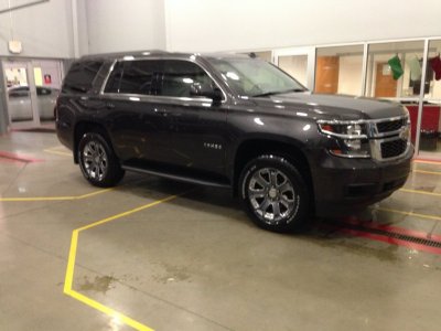

I have 275/60/20's with a 1 inch leveling kit. no problems at all

Where did you get the OEM 22 inch wheels in a 20 inch size? Looks great

I got replicas from YETI and they are perfect. Wouldn't hesitate to buy another set.

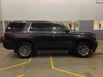

The wheels were purchased from oewheelsllc.com. they are painted the same color as the Tahoe. the tires are 33"
