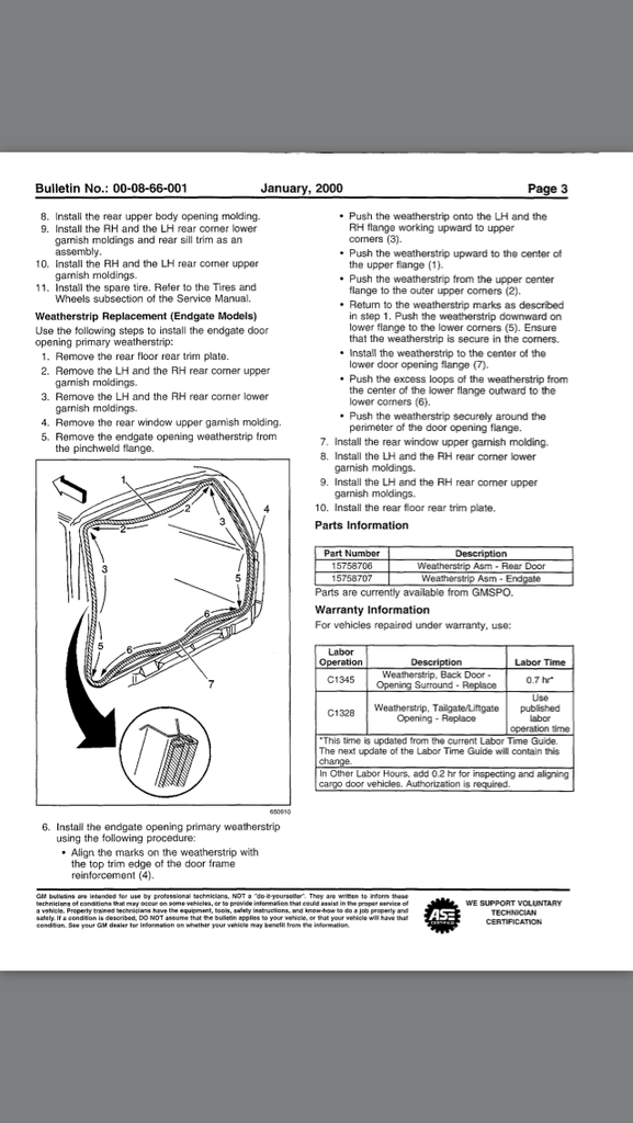

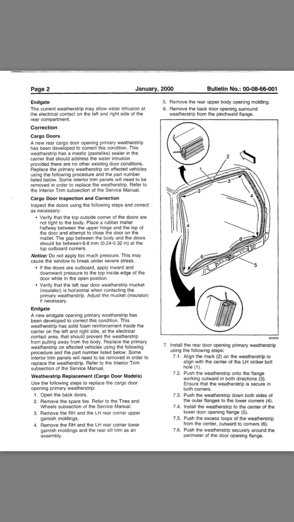

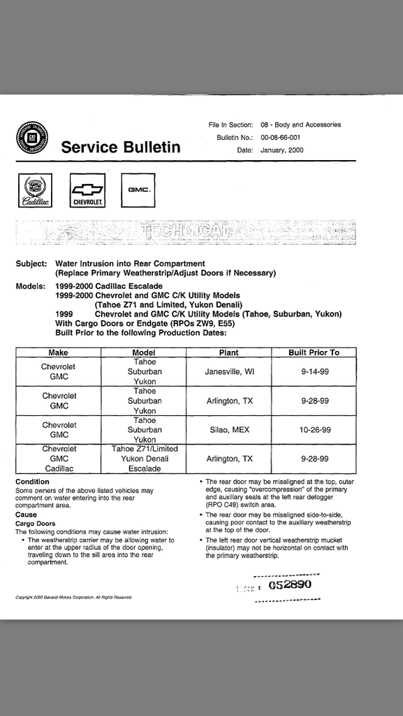

GM issued a TSB with revised weatherstripping that supposedly addressed some of the problems. I can confirm that the tailgate weatherstripping sold by LMC has the foam insulator and appears identical to the GM version revised under the TSB. It didn't help my issue, but maybe it will be of some use:
http://www.revbase.com/BBBMotor/TSb/DownloadPdf?id=1589
The alignment marks referred to in the TSB are small dabs of paint applied to the weatherstripping.

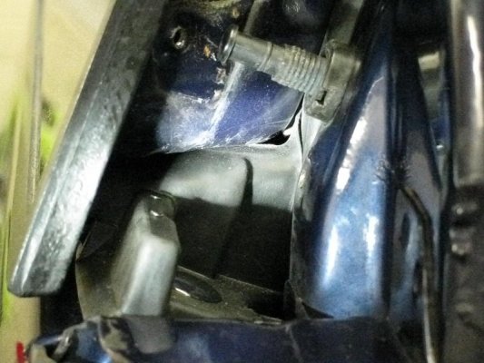

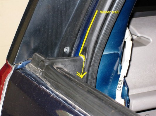

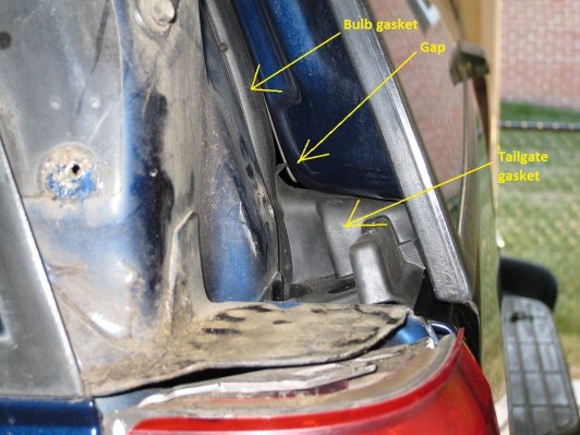

Do you have the tailgate or cargo doors? The tailgate on my 98 two-door doesn't meet the bottom of the liftglass. There's a gap and no amount of adjustment will close it. New weatherstripping did not help.
These photos are not of my truck, but show the exact same issue. The exterior side trim panels have been removed to better show the gap:

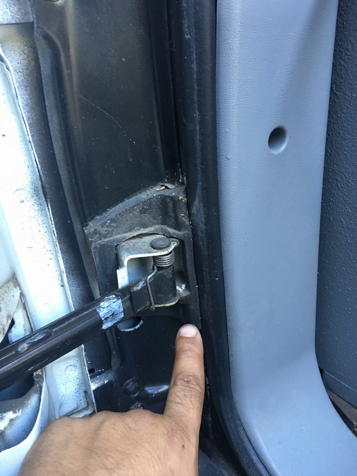

I have the barn doors. I haven't noticed any water at all in my Hoe, just a moisture/humidity problem. Haven't attempted to check for water intrusion since finding this post though.
Anyway, that TSB mentions putting a rubber mallet, halfway between the top hinge, and top of the door, then try closing the door. The door should not touch the body. If this is accurate, the windows on the doors would have to be at a proper 90 degrees, perpendicular to the ground, instead of being angled toward the truck. I'm not looking at my truck right now, but that just doesn't sound correct to me. Seems like the windows should be a lot closer than that. :hmm::shrug:
