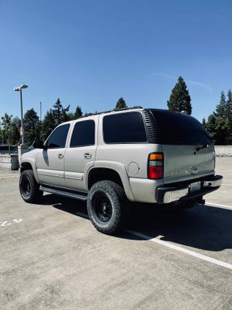

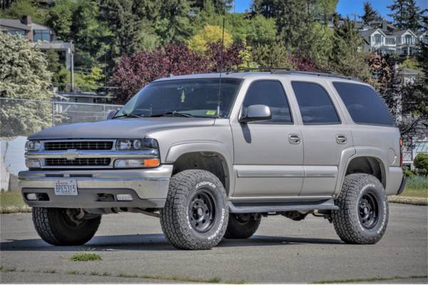

Here are some pics from when I first bought it, December of 2022.

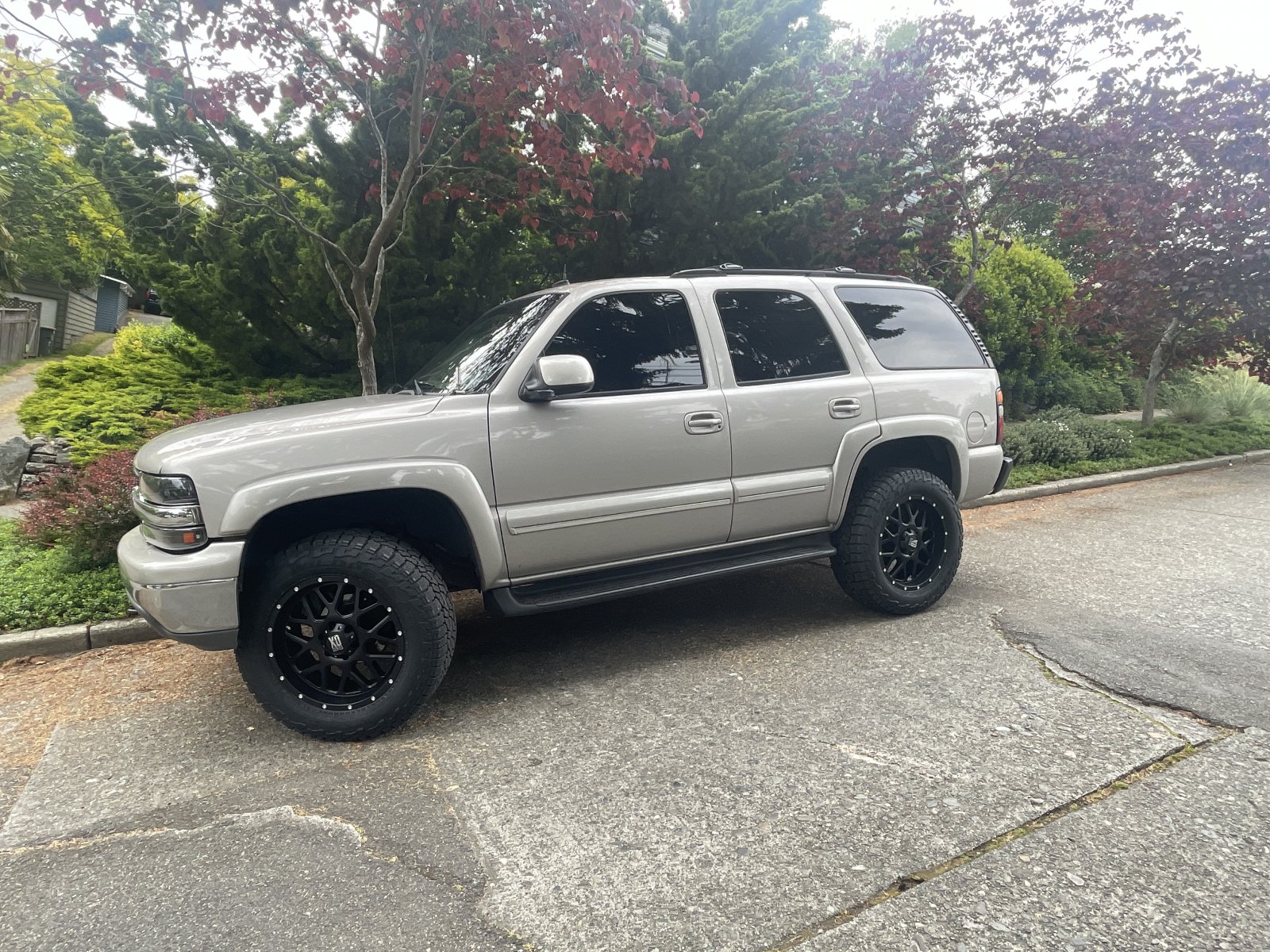

This past weekend, I swapped the wheel and tire combo. Due to a poor alignment, the front tires were basically bald on the outer half, so it was time. Decided to move from 16" to 20" wheels in preparation for a GMT900 or K2XX brake upgrade down the line. Went with XD820 Wheels and LT285/60/R20 Falken Wildpeak AT3W tires. I've heard good things about the tires, plus a combination of a good tread life warranty and lower cost than typical options like the BFG K02 or Toyo Open Country. Hopefully they serve me well. Kept the overall diameter and tire width roughly similar, with a higher offset to tuck the tires more, but left the spacers on.
