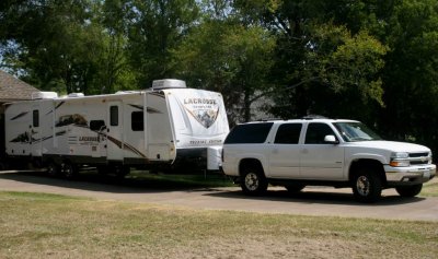

First off the gasser 3/4 tons are going relatively cheap because of age and mileage. The wreaked donor truck for Dmax, Allison, rearend and other parts will probably cost you more. Swapping it in has become common for the 800 platform so its not priced bad either and all the bugs have been worked out. Mine is 2 years old now with no problems. Heres my 2005 4x4 hooked up to my 35' Travel Trailer.
