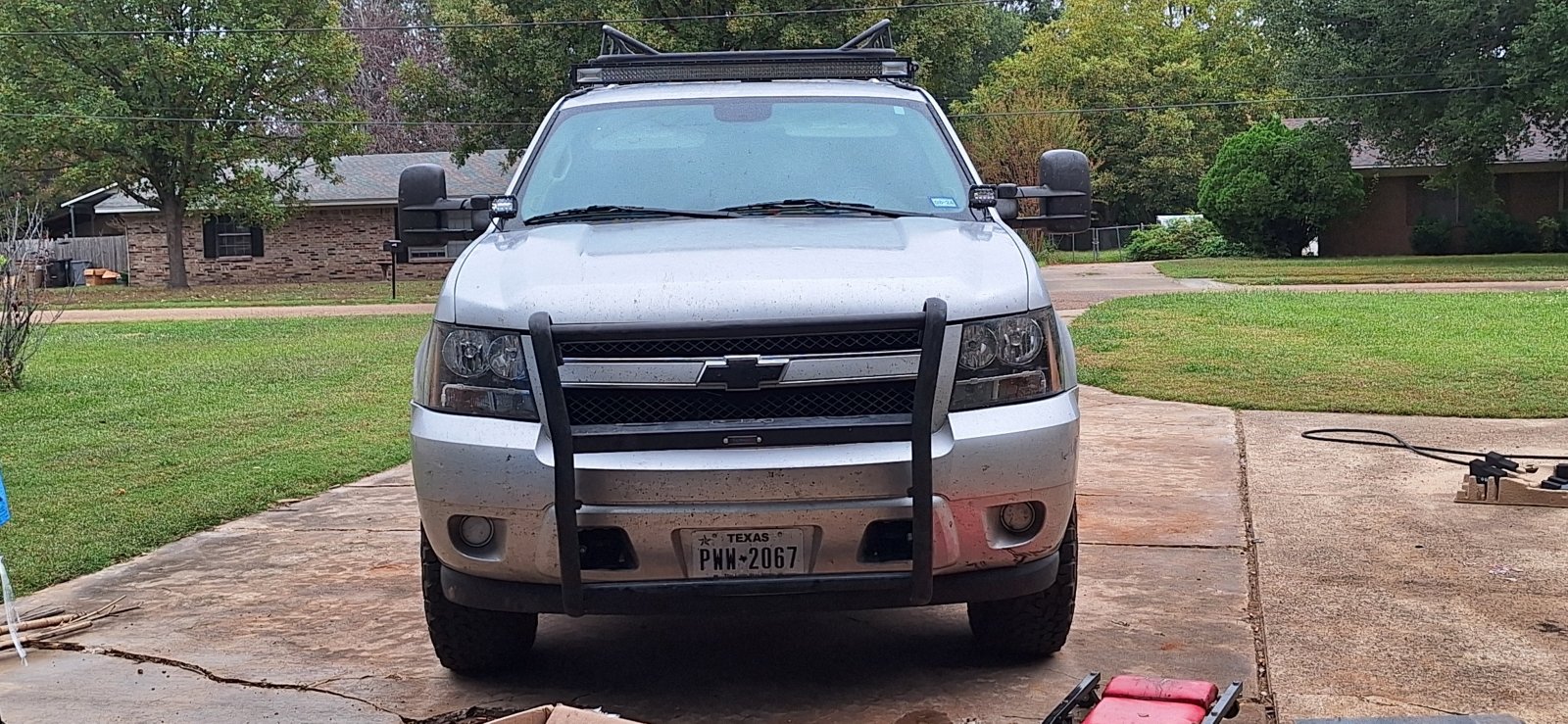

I recently got a 2010 retired GSA silver 2500 Suburban. I bought a used front grille guard off a tahoe from a police auction. It is from Go Industries. The brackets that came with it were wrong so I called the business up, the guy they put on the phone with me was a total ahole. Just basically said all that shit is too old so f off. I said, well sir I have your catalog here and I have part numbers. He said that he couldn't help me. So I go on their web site and put the old part number in that I found, and it pulls up a bracket kit that cost $105. I ordered it and it is a perfect fit. I will try to post some pics. Also with this bracket kit, you can mount I think about four different brush guards. I really like the Big Tex One, but the one I got was only $250 and it is fully welded.

It was off a 07-14 1/2 ton police tahoe. The brackets that came with it did not work for a 2500. I found one of their old catalogs somewhere online. It has information about our trucks and how they used to make all these parts. Gives you part numbers, and is how I was able to see this bracket was for a 2500 Suburban and some other stuff

Thanks for all the info! I did a little digging and found the part number for the guard for the GMT900 2500 Suburban in the 2021 catalog...
