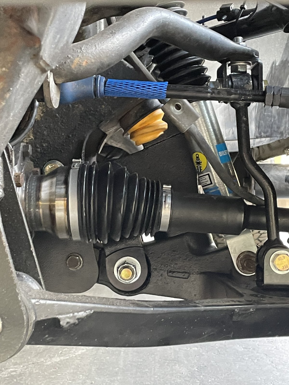

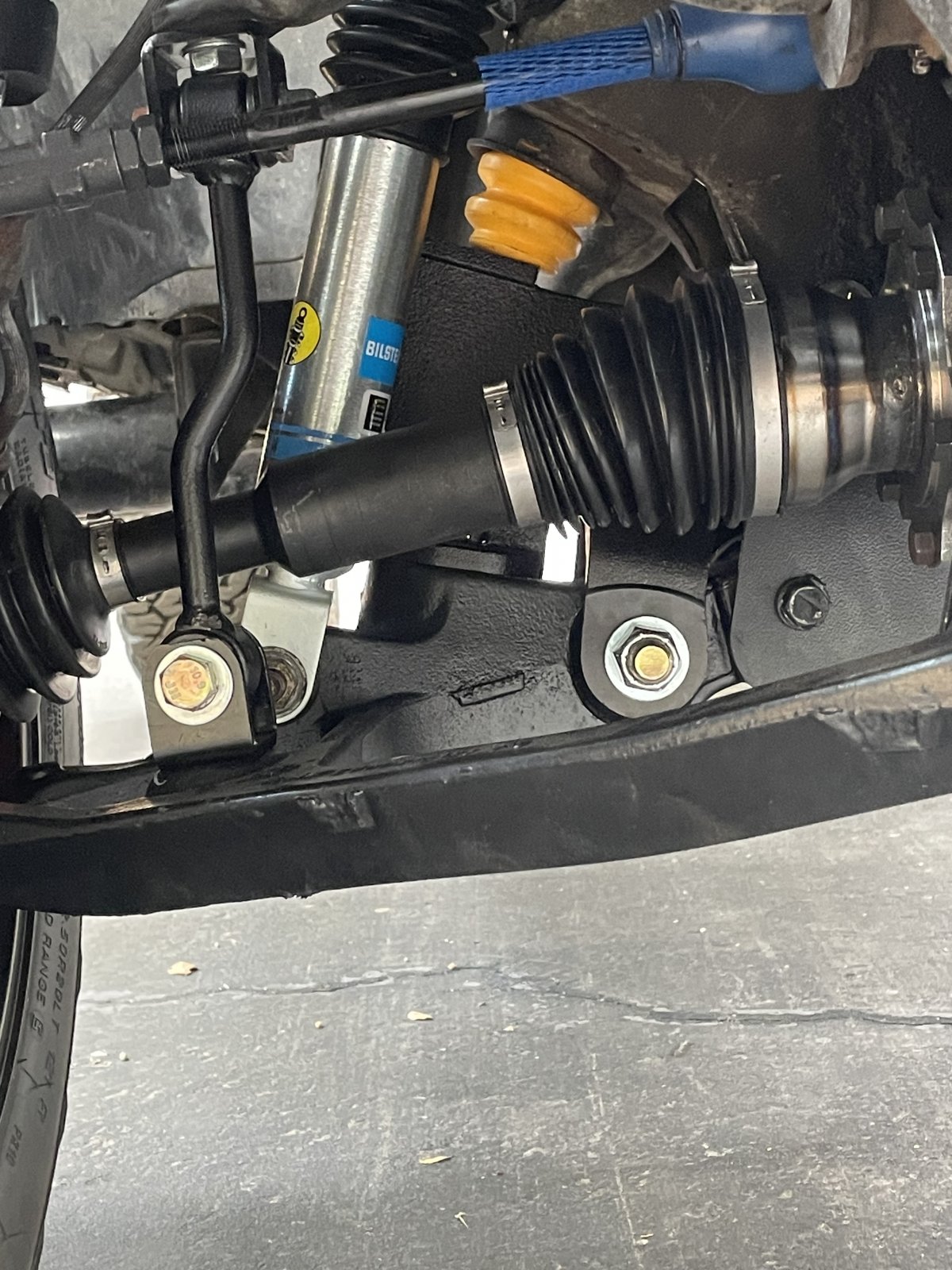

So another issue I’m having, after the 6” Lift, my bump stops are riding on the lower A-arm. See pics. So I’m thinking I’ll crank up the keys a little bit, which gave me clearance. Took it around the block and right back to where I started, bump stops are back resting on the arm. Any thoughts? My torsion key bolts are out about 1”. Trying to get this resolved before taking in for alignment IMG_4462.jpeg

I can't tell that from your pic but with the stock suspension the front jounce (not "bump") stops are supposed to contact the lower control arms.

Yep...jounce stops are always supposed to be in contact with control arm bracket. Certainly you can adjust the keys for more lift but they should still touch.
