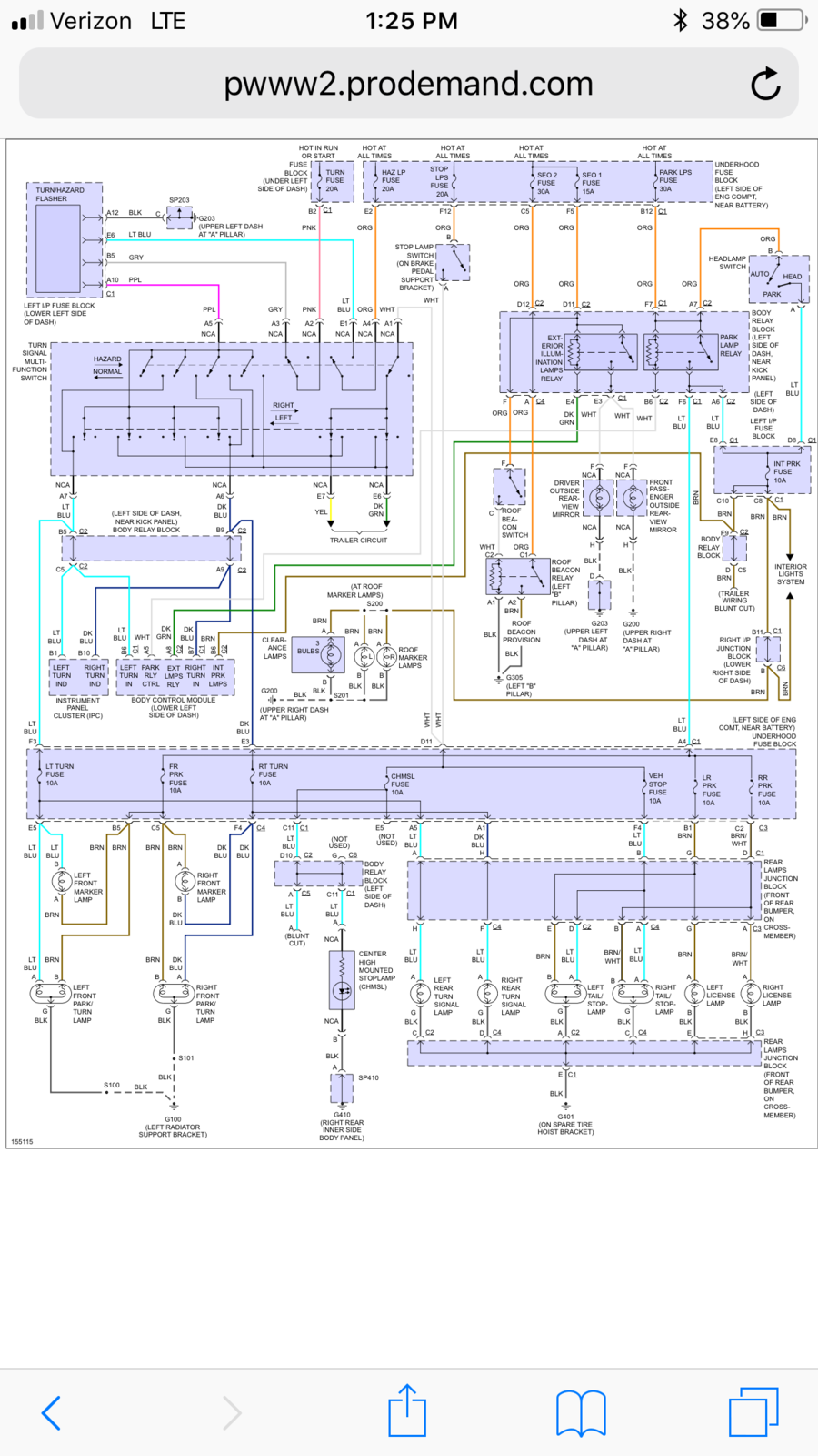

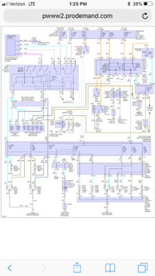

After doing an oil change, fixing a window regulator, and a few other little things that had been bothering me, I was happily out on a drive the other day noting how damn near everything was working perfectly for once. This was until another driver pulled up and said "you know you ain't got no brake lights, right??" No, no I was not aware of this...
Indeed, no brake lights are working, side or center. Running lights are on, but do not get brighter with brakes. Interestingly, cruise control still works too. Fuses and bulbs all check out good. I saw mention of a junction box near the rear right of the vehicle that is often at fault, but I didn't see anything there... Granted, it was dark and I was pissed off and didn't spend much time looking.
'02 Tahoe 4x4 5.3 Flex. ~330,000 miles
