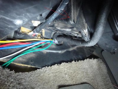

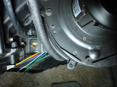

So there is a leak under my passenger side floor board it look like it is coming out of the blower motor?, every time it rains there is a small puddle in the floor board I have taken three pictures so you know where i am talking bought, Anyone know how to fix this? and the cabin fitter is dry as a bone when it happens x,x

Do you have a factory sunroof? If so check the drains in the front corners. I had a simular leak on the drivers side.

I am thinking the cowl screws need to be removed and some sealant put on them. Just can't recall where it was brought up. I think it was GM.

remove wipers
remove cowl
clean
replace cowl
replace screws and seal them with silicone
it's a very common problem

Common issue like others said, try what they mentioned, if not then you need to remove that panel on the cowl and ré seal it

You replace the windshield recently? I had the same problem. Water would drip from the blower area and pool under the running board where the passenger door met the frame. Carpet would get all flooded out in the rain.
Tracked it down to the upper portion of the windshield where water was running down and around the seals. Had it resealed and no problems since.
This was do to a ****** install on a windshield.

So it was the cowl letting in the water in the did not replace the screw back on the passenger side so i just found another identical screw lubed it up with silicone it it fix the problem :beer:

on NBS trucks this is usually from a clogged A/C drain tube or leaky sunroof - door sills. but on a obs id check the windshield
