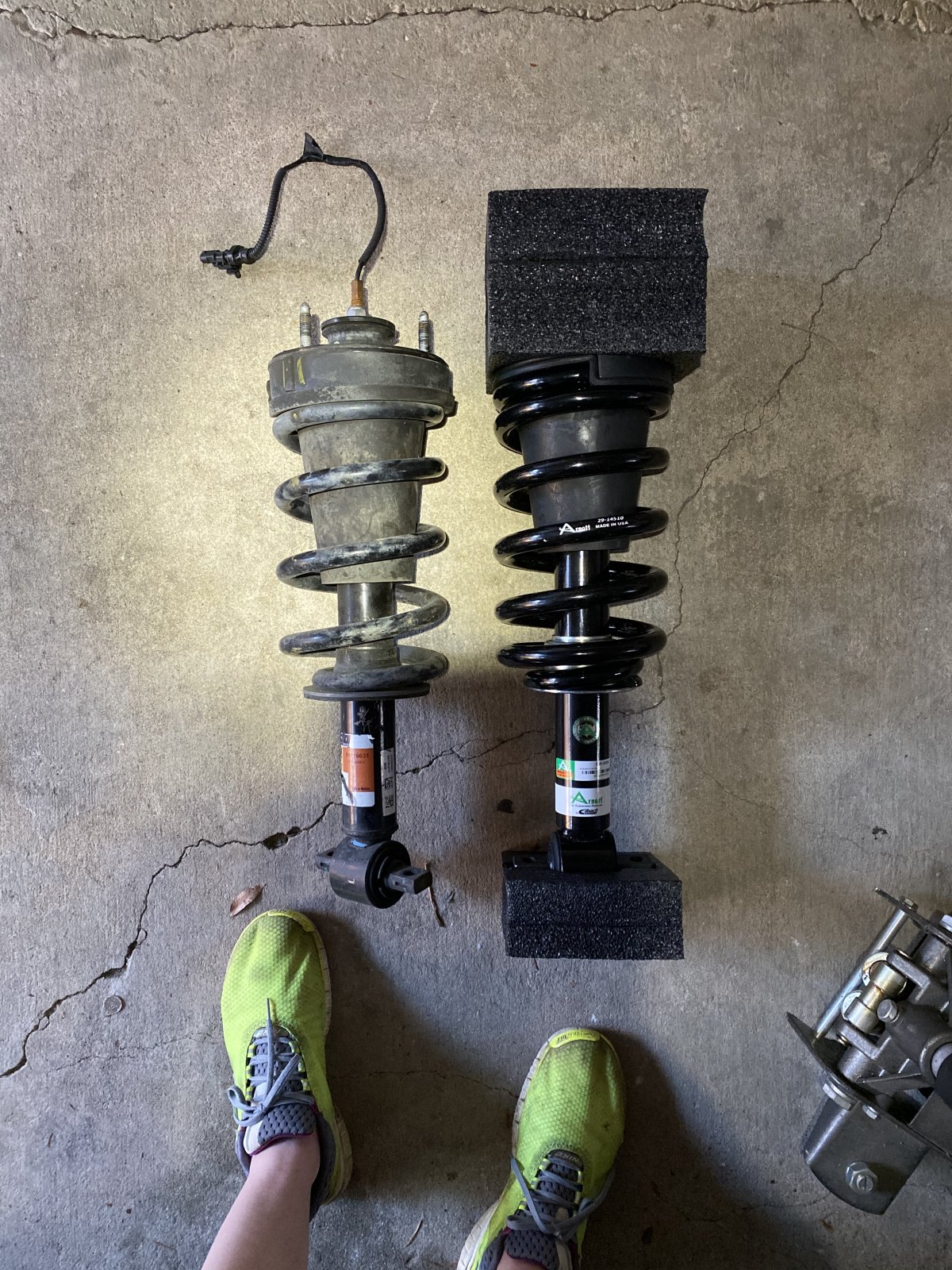

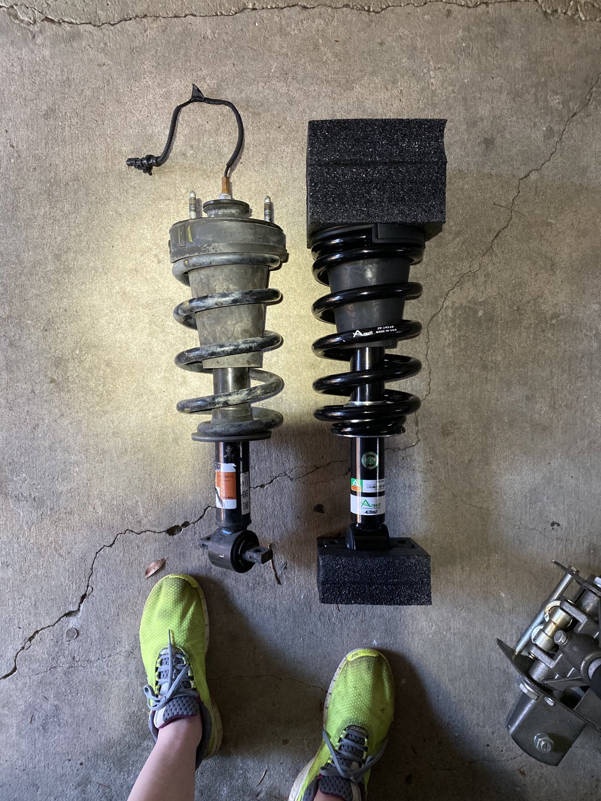

I recently had to replace my front struts (2016 Yukon Denali) at 68k miles due to leaking. Did some research and really wasn’t thrilled about paying close to $600 per shock absorber for the OEM AC Delcos—especially seeing how some were even failing at less than 40k miles. I decided to go with a full coilover replacement from Arnott (model SK-3354) which are an exact replacement—yes they are magnetic shocks. I paid about $450 each after tax from ShockWarehouse.com using a coupon code they had. I originally had a leveling kit, however it is not needed with these coilovers due to their beefier size. See pics below.

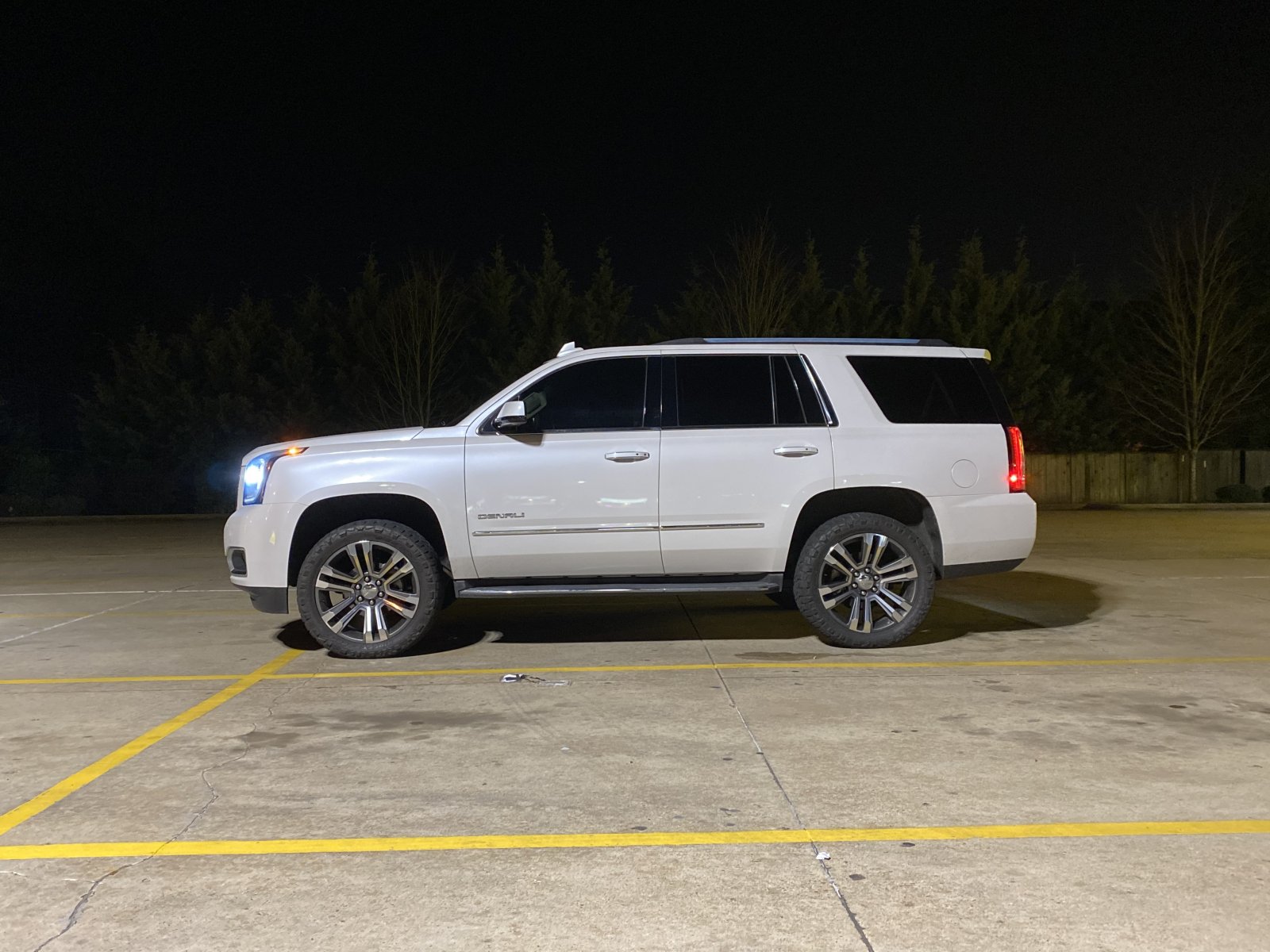

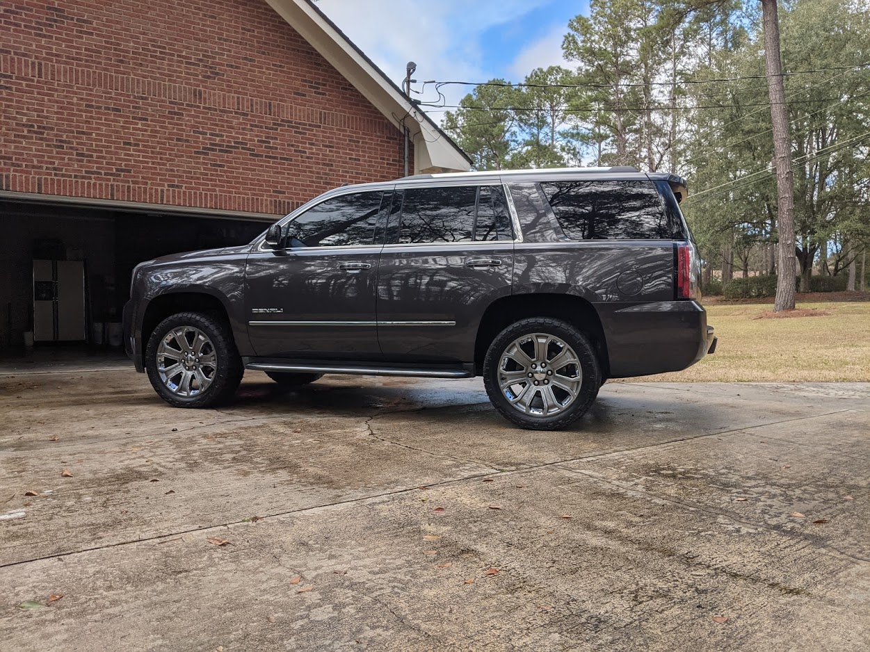

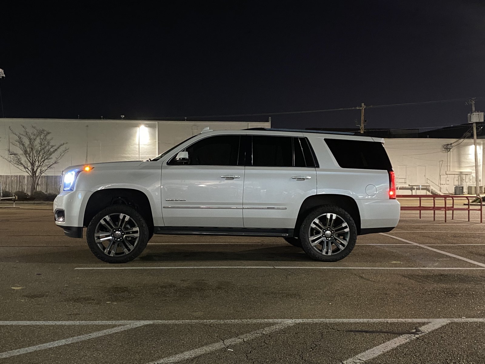

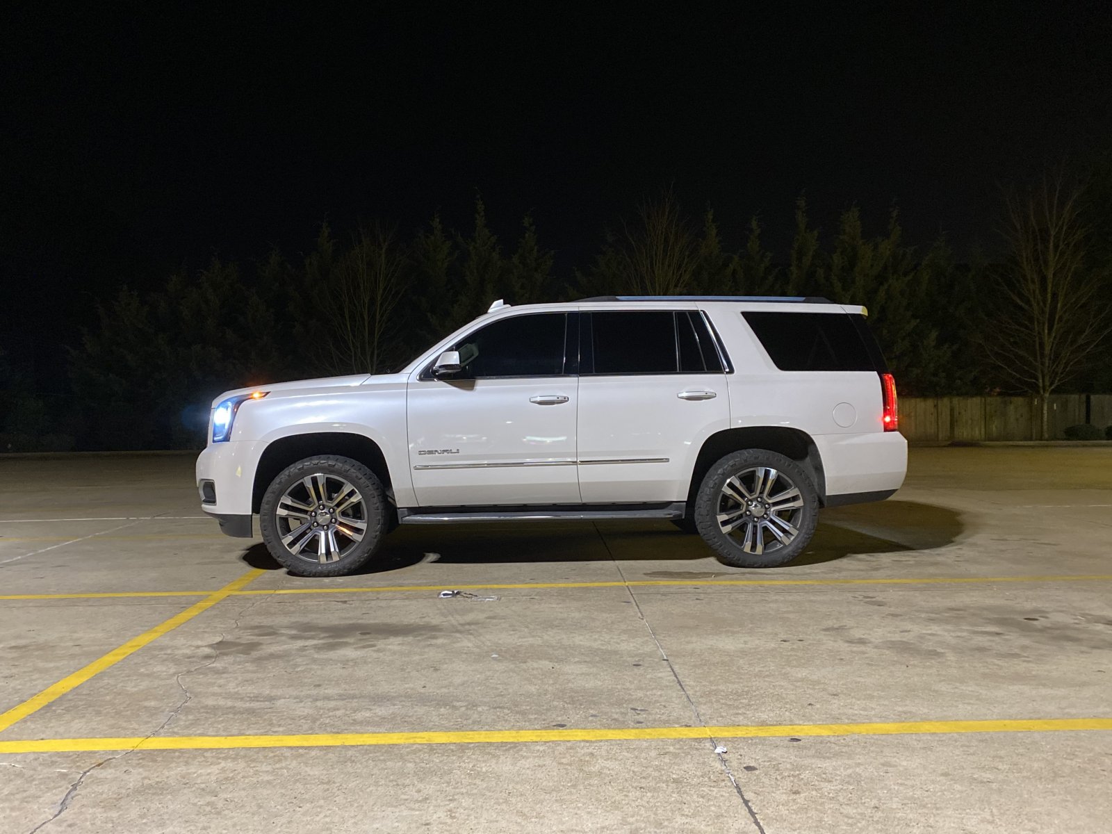

2nd pic is with leveling kit, before I realized it would not be needed with these new coilovers. 3rd pic is after removing leveling kit. I considered lifting the rear, but my tires are a bit too small for that much of a lift. I had a good 2 inches more in the front than the rear. Tires are 305/45/22.975E24EA-C3AD-4606-8AE5-1C254E68443E.jpegB5A0F380-39B6-458E-9849-623CCB8DBFAF.jpeg 80F58B3C-7E7F-4116-ABFA-98E408C7E3F4.jpeg

interesting to see the difference in coil diameter, definitely looks like it would have a slightly higher spring rate, obvious by your installed pics.
is the number on the spring itself the same as the part number or is it different, wonder if arnott sells the coil separately

Holy shit, yea they definitely lifted the front quite a bit. You would think that Arnott would mention that. If they were truly a “direct replacement”, they should be damn close to factory height IMO...but an added bonus if you want the rig leveled!
