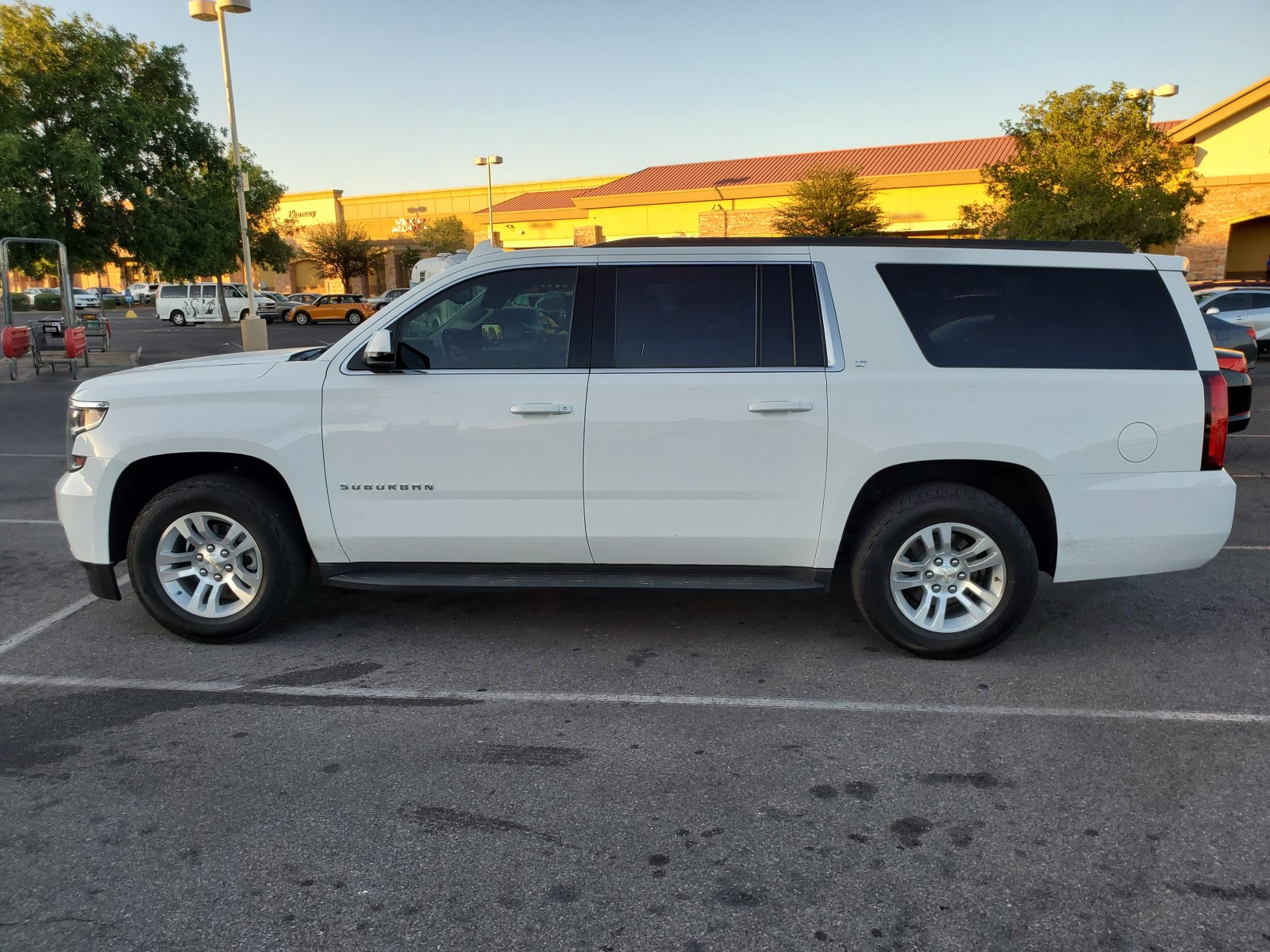

Got the same kit on my 19 suburban. I think if you use the factory isolators you'd probably be sitting at about 1.5 drop 20200426_183529.jpg

You can remove the factory rubber isolator and replace it with rubber hose. You will gain between .75" and 1", but to get the back end level you'll need to come down around 2". I know it looks like an inch, but its closer to 2. I would recommend the rear level kit, 2" spring and a shock extender in the rear.
