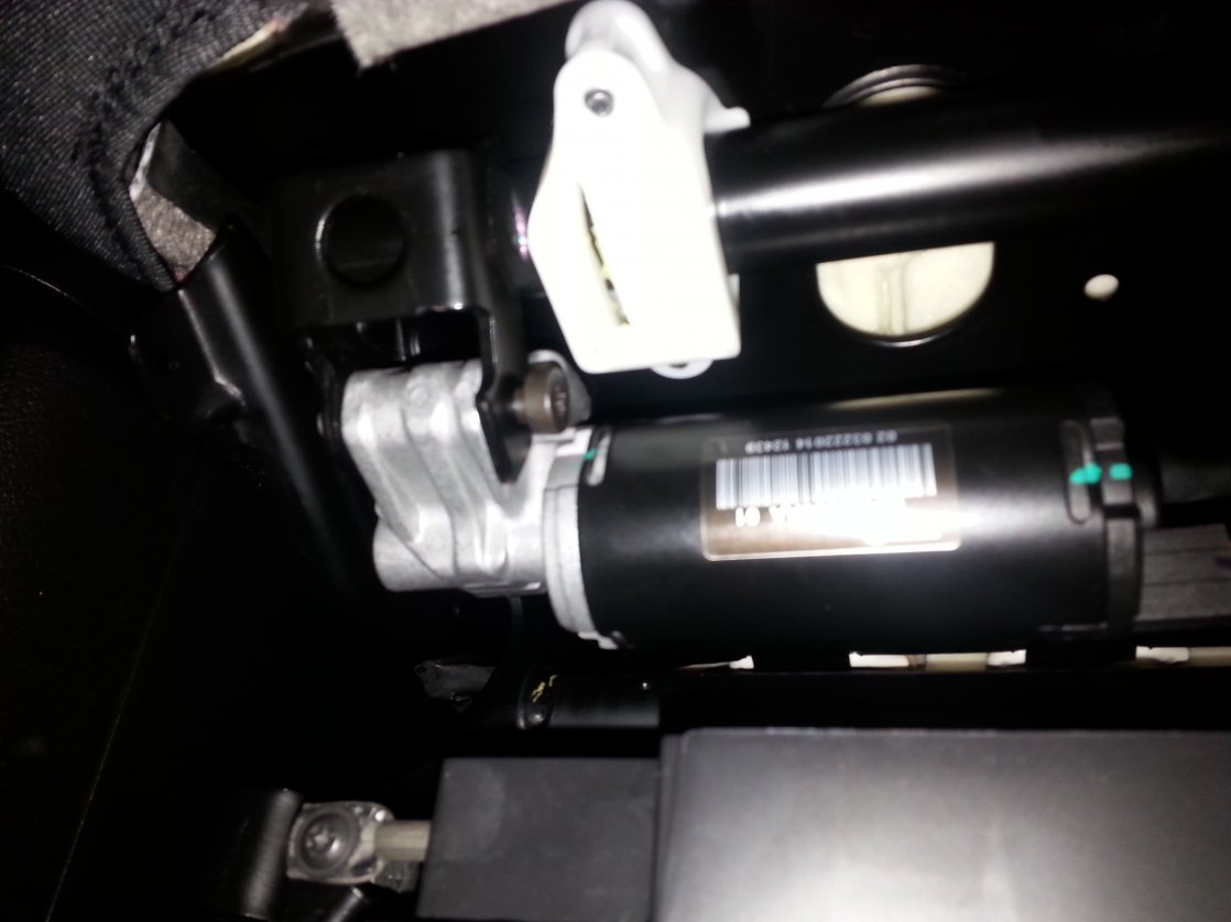

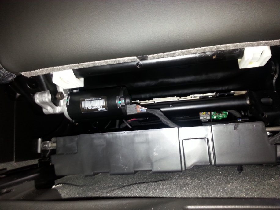

Mine does it almost every time I drive. I spoke to Sewell GMC in Dallas about it. The service manager said it was a known issue but GMC doesn't have a fix yet (as of a week ago). Apparently it is the motor for the seat and it's moving around. He told me they "fixed" it on one other new Yukon by using parts from a 2014 but that they were told by GM not to do that again so now they won't fix mine until they have an official GM fix for the 2015s. He claims it's not a safety issue, just rather annoying.

I'm going to dig into mine the next couple of days and try to find it. Very annoying.
