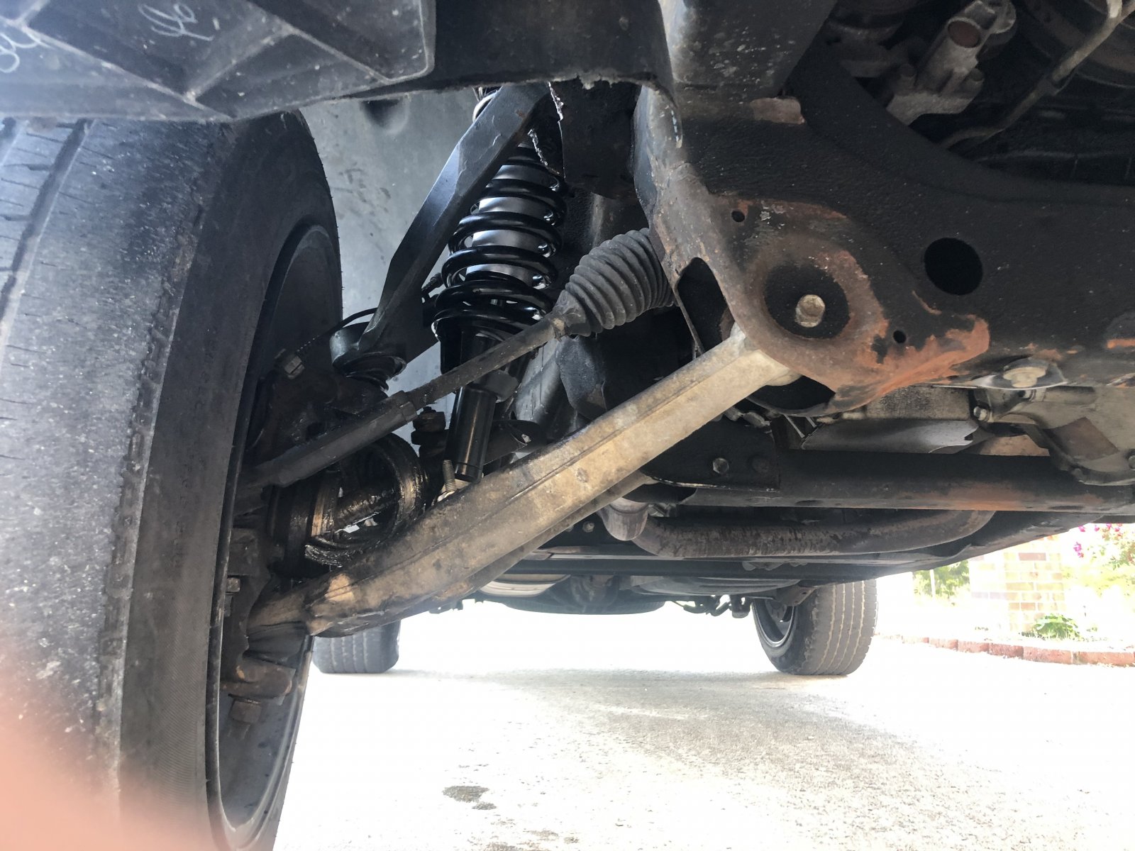

Hey guys. I’m lifted a bit and have cut the factory droop stops. I suspect that my upper ball joint is now acting as a droop stop because to get the upper balljoint installed I have to jack up my lower control arm and compress the strut to get the ball joint in.
This leads to a jarring sensation when the front wheels reach full extension or droop when coming over speed bumps or anytime there is no weight on the front end and the front wheels get to fully extend.
My theory is I need to get some limiting straps installed in the front so that when the front struts fully extend my upper balljoints to take the beating for it.
Thought?
