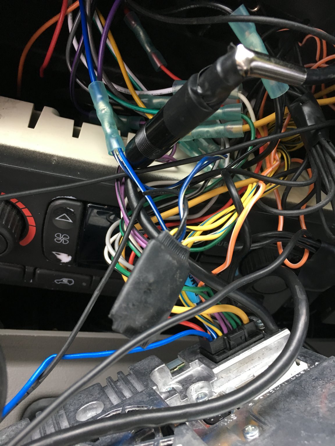

Sorry about that but it worked! Only thing is I have that piece that bypasses the foot brake which is tied to the remote wire (blue with white) and im getting some interference throughout my speakers. Any thoughts on rewiring it
