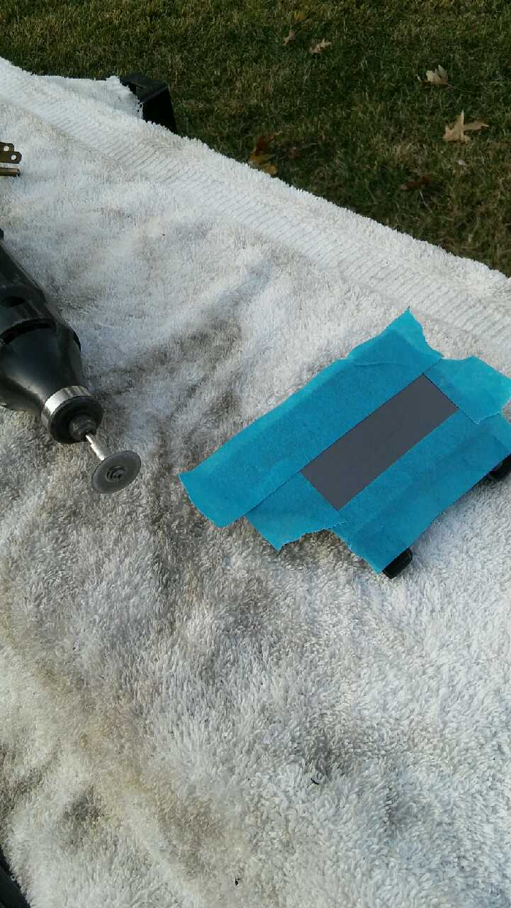

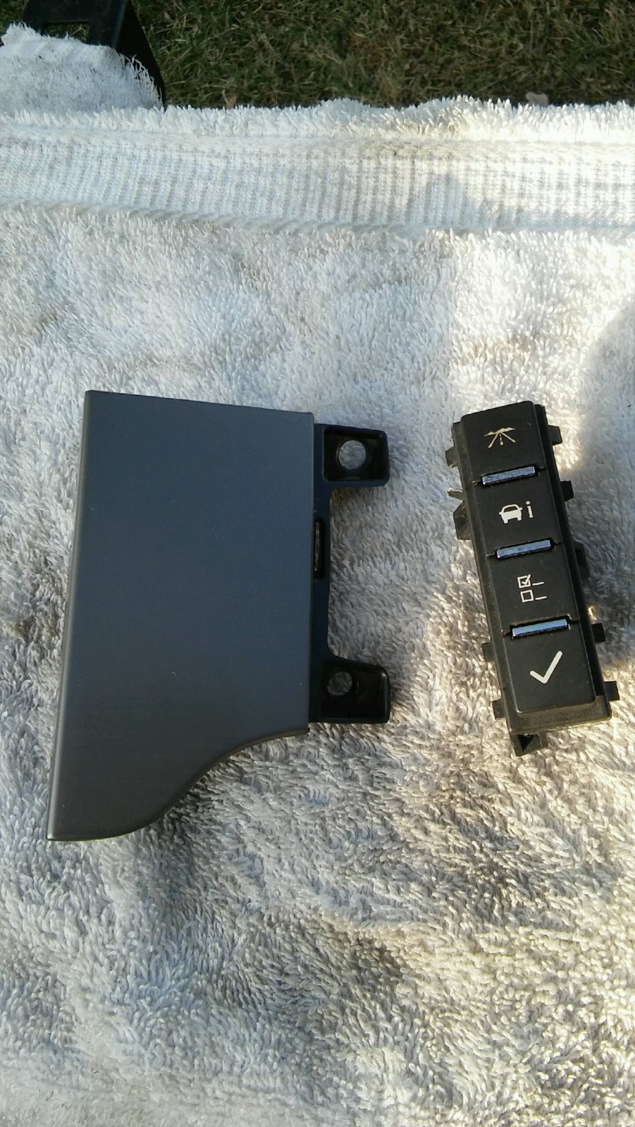

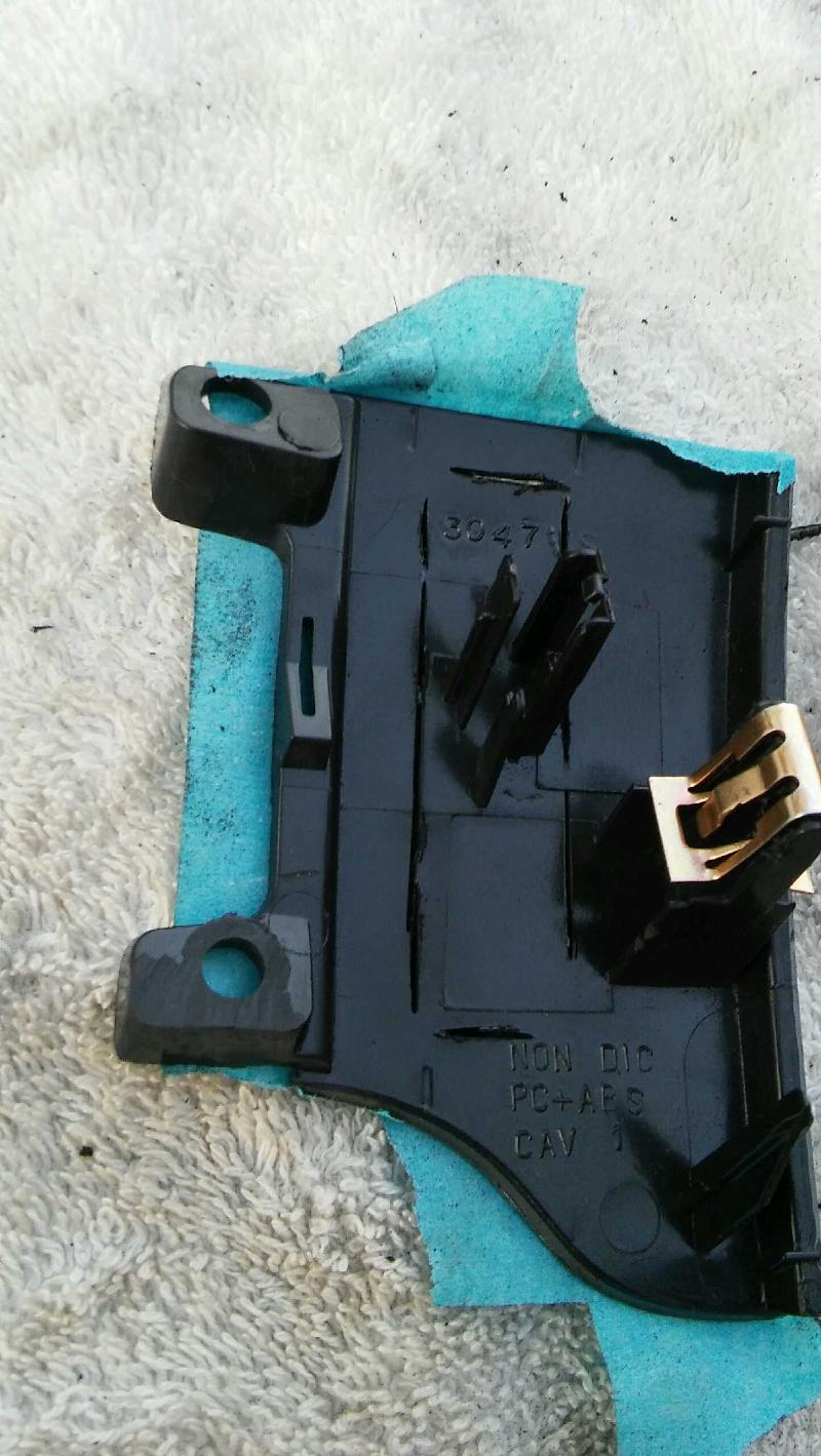

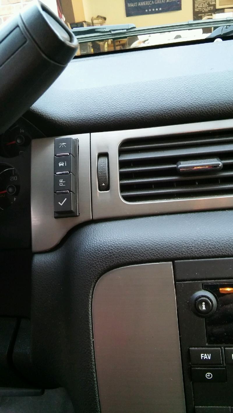

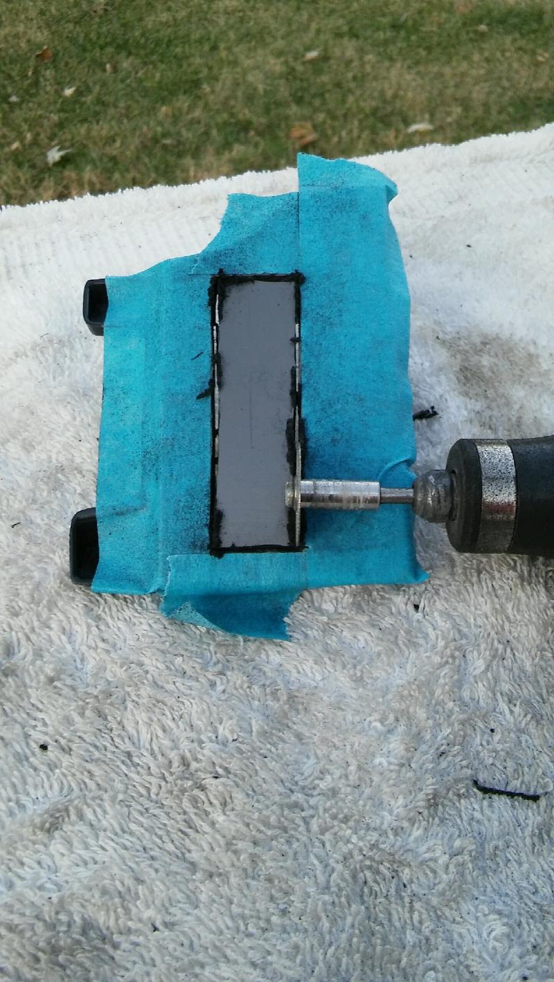

I picked up some spare parts and a DIC. Here are some pics. I had to separate the small trim piece from the long trim with the middle vents. I just ground the plastic rivet heads off with the dremel cut off and left the studs to slide the DIC trim back on when it goes back together.
View attachment 188053 View attachment 188054 View attachment 188055 View attachment 188056 View attachment 188057
Nice work, but it couldn't be flush mounted like factory?
