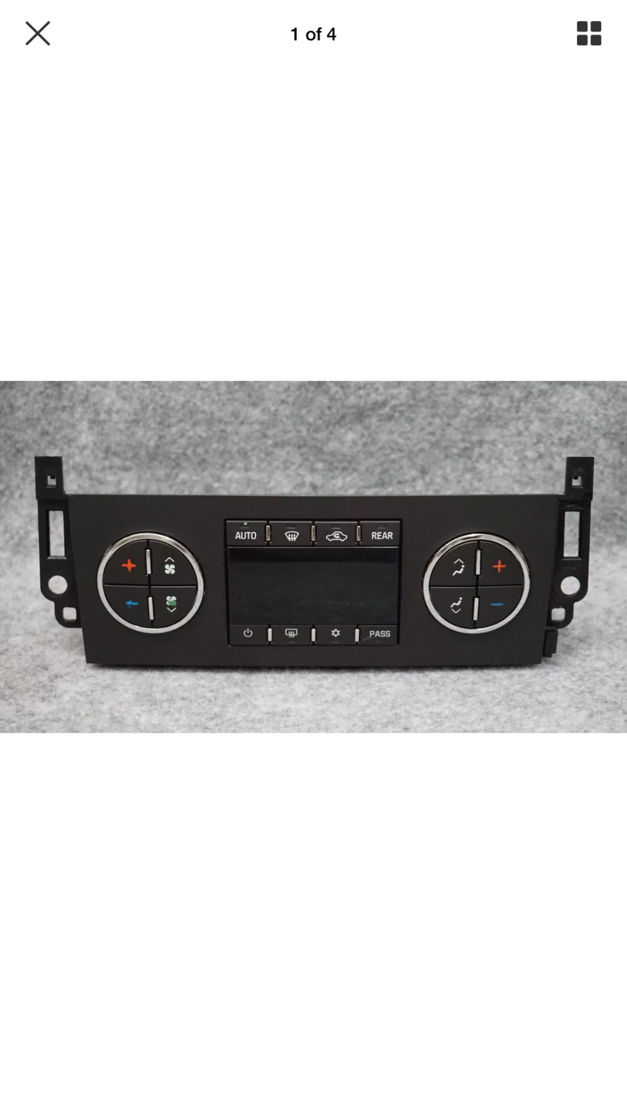

So basically you replaced the front climate control module? I am having the rear climate control problems and i am hoping this might be the solution, i could just pick up a replacement.

his is the part i am referring to
