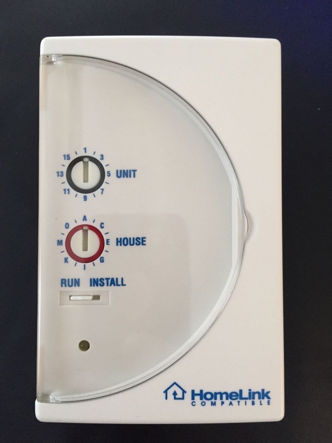

Has anyone tried to get X-10 to work with HomeLink?
I have been using x10 forever and would love to get my "new" (to me) 03 Yukon Denali HomeLink to work my lights...
I have found some vague instructions that tell me it is possible, but I cannot seem to get it to work...
/http://www.homelink.com/about/lighting
My Yukon has a black slider on the left side of the overhead 'console' that contains the HomeLink transmitter, the slider is mentioned in the instructions but I am not sure if fwd or backwards in learn or run...
Programming
Any ideas??? Thanks....
Programming
- Move the RUN-INSTALL slide switch to the INSTALL position.
- Turn the red HOUSE rotary dial to position "A" and the black UNIT rotary dial to number "1."
- Plug the Vehicle Interface into an outlet, preferably in the garage.
- Press and hold the Universal Transceiver button chosen to activate home lighting, releasing when an audible tone is heard from the Vehicle Interface. (If no tone is heard, the vehicle and the Vehicle Interface may need to be closer to each other during this procedure.)
- After the tone is heard, move the RUN-INSTALL slide switch to the RUN position.
