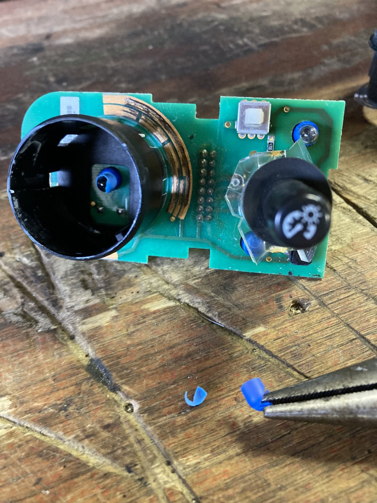

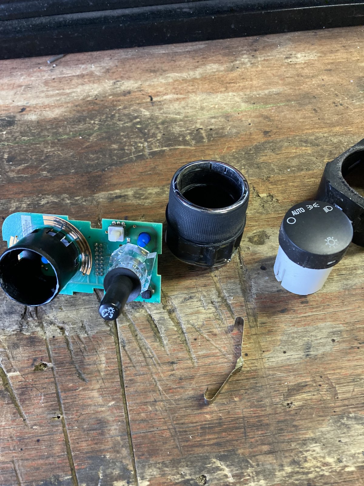

Some reason I lost the backlighting on my headlight and interior/fog light switches by not in the 4WD switch. :(
This really messed with my head last night driving in the dark I keep thinking my lights weren’t on.
Anybody have this happen and know the fix? Just a new switch?

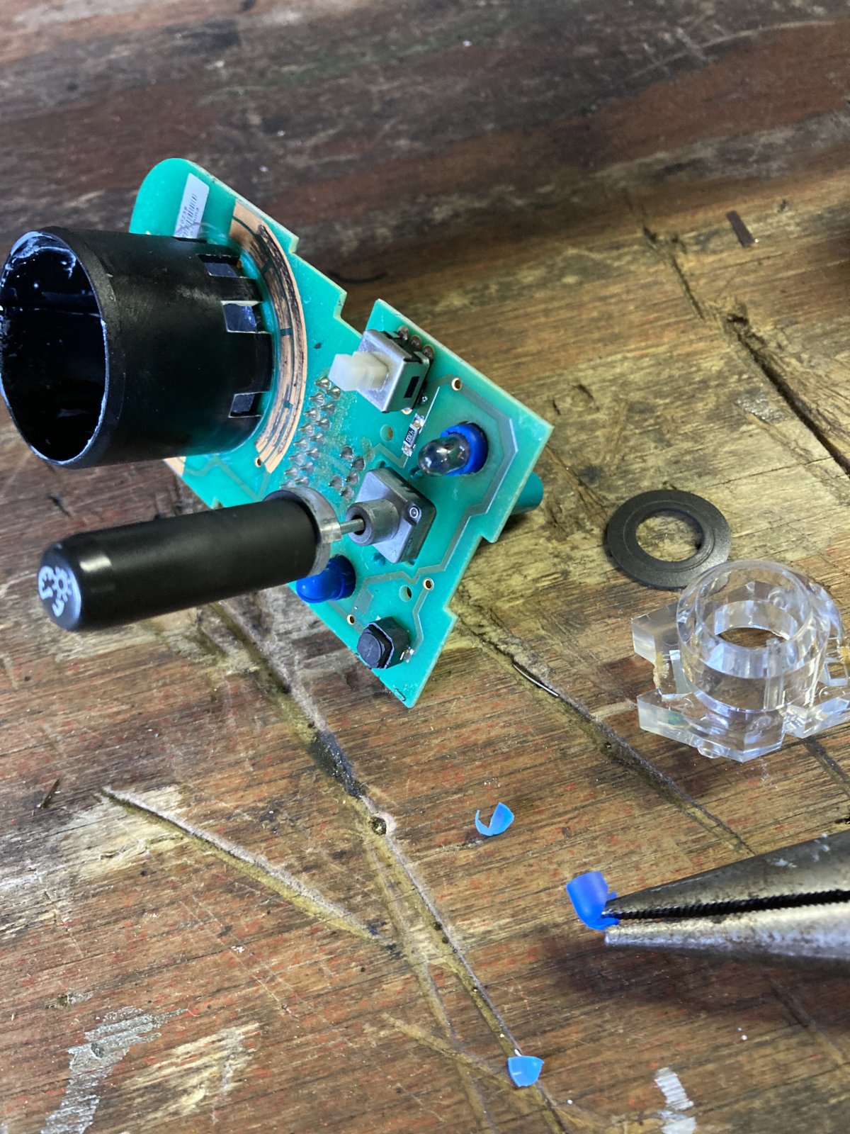

I don't know how the circuits are in those. But, with that many bulbs being off, I don't think it's the bulbs. Have you pulled the switch out and checked the basics?
Yes I did the basic research. And gave it a love tap / fist bump like you said. No dice. Pre-R&R exercise so I can replace it in a jiffy. Wish me luck.
The bulbs are soldered to a board inside, just get another off Amazon. That's what I did anyway.
Well forget Amazon, too expensive, RA is $30.
I am trying this one.
Will report back.
