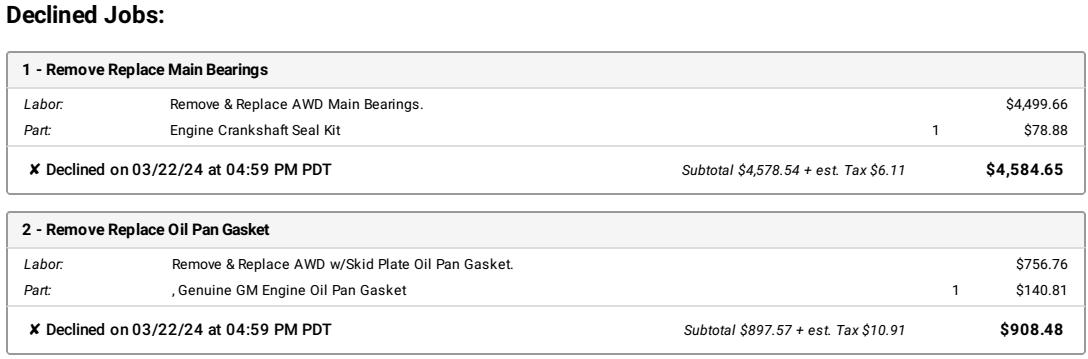

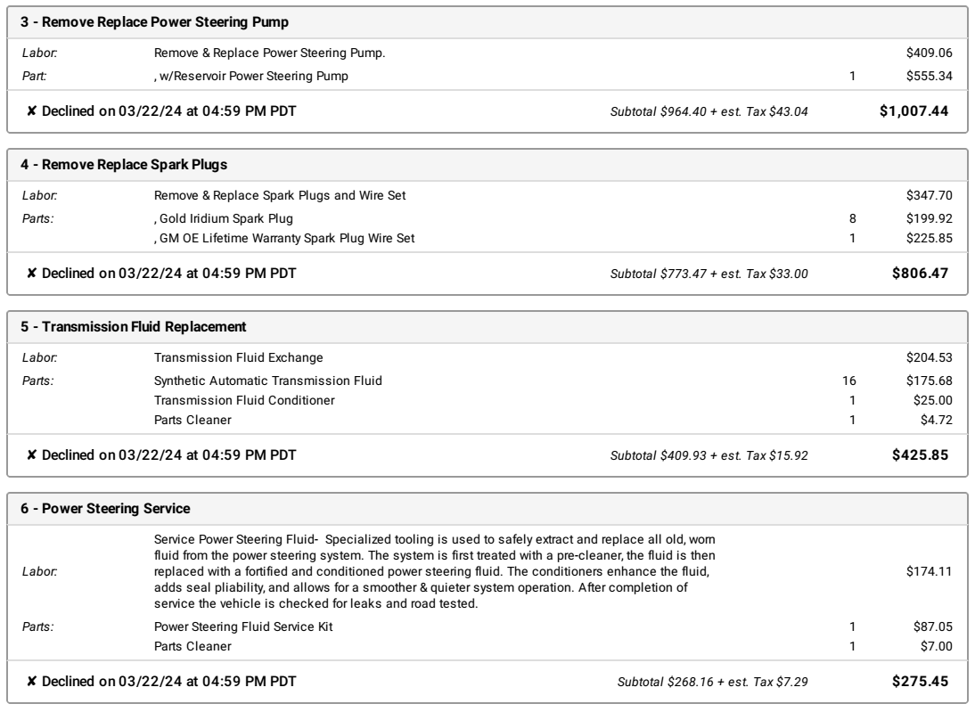

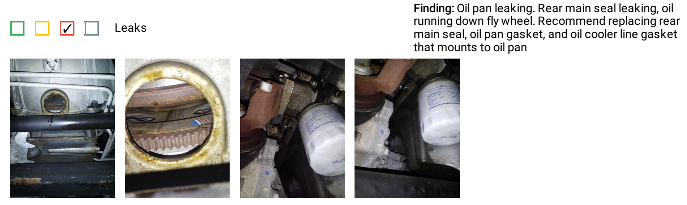

2014 Yukon XL Denali, just had a pre-purchase inspection done. 130k miles. Fluids need to be exchanged, as I expected would be the case. They also listed spark plug replacement, power steering pump replacement, oil pan gasket replacement....but the worst line item is for:

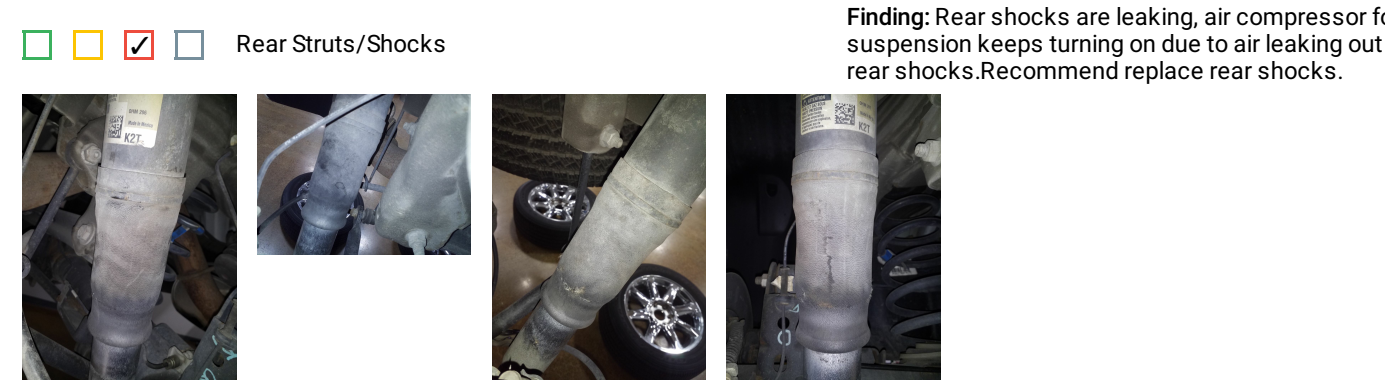

"Remove & Replace AWD Main Bearings" and this item, including the Engine Crankshaft Seal Kit ($78), is $4500. Is that a legitimate cost for this service? The other items seemed high, but were not nearly as surprising as this one. The inspection noted "Oil Pan leaking. Rear main seal leaking, oil running down flywheel. Recommend replacing rear main seal, oil pan gasket and oil cooler line gasket that mounts to oil pan" but I don't see anything that says "bearings" The inspection also notes the rear shocks, but I don't see those listed in the actual jobs they bid out to me, unless that's what is included in the AWD main bearings?
This shop comes highly rated so I somewhat trust their information but just trying to understand.
