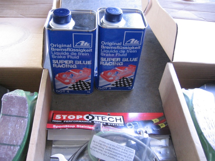

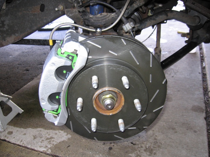

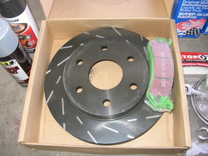

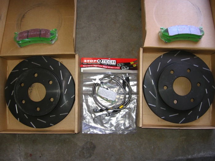

The stock shit sucked so bad it wasnt even funny! Everytime the brakes got wet, it would take over twice the distance to stop and the pads werent even worn halfway! Since upgrading everything on my Formula a few years back, I figured I would do the same thing to the Yukon.
Discount tire direct for the pads, I think $74 shipped, autoanything.com for the rotors and brake lines $260 shipped.
EBC slotted rotors
EBC green stuff pads
StopTech stainless brake lines
ATE Super Blue brake fluid
OEM new calipers(stockers were badly seized and wouldnt break loose even with heat)

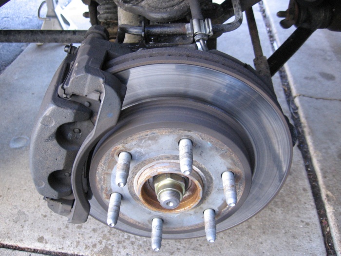

Everything went pretty much as planned except for the calipers bolts being rusted/seized in place and then rounded off, finding out the boot on the caliper bracket was stuck in sideways rubbing on the slide pin and oh yeah the brake line having a pin hole in it. Anyways got it all done and come to find out the rear rotors and pads were garbage but didnt have a kit to do the rears so April for that one! Since I had to replace the calipers, I ended up spraying them too.

so far so good but I drove it just enough to seat the pads and I have to complete the rears to get the full effect of good brakes BUT there was a noticeable difference already!
Make sure you read the instructions for seating the EBC pads. The yellowstuff pad seating was different than normal pad seating.
