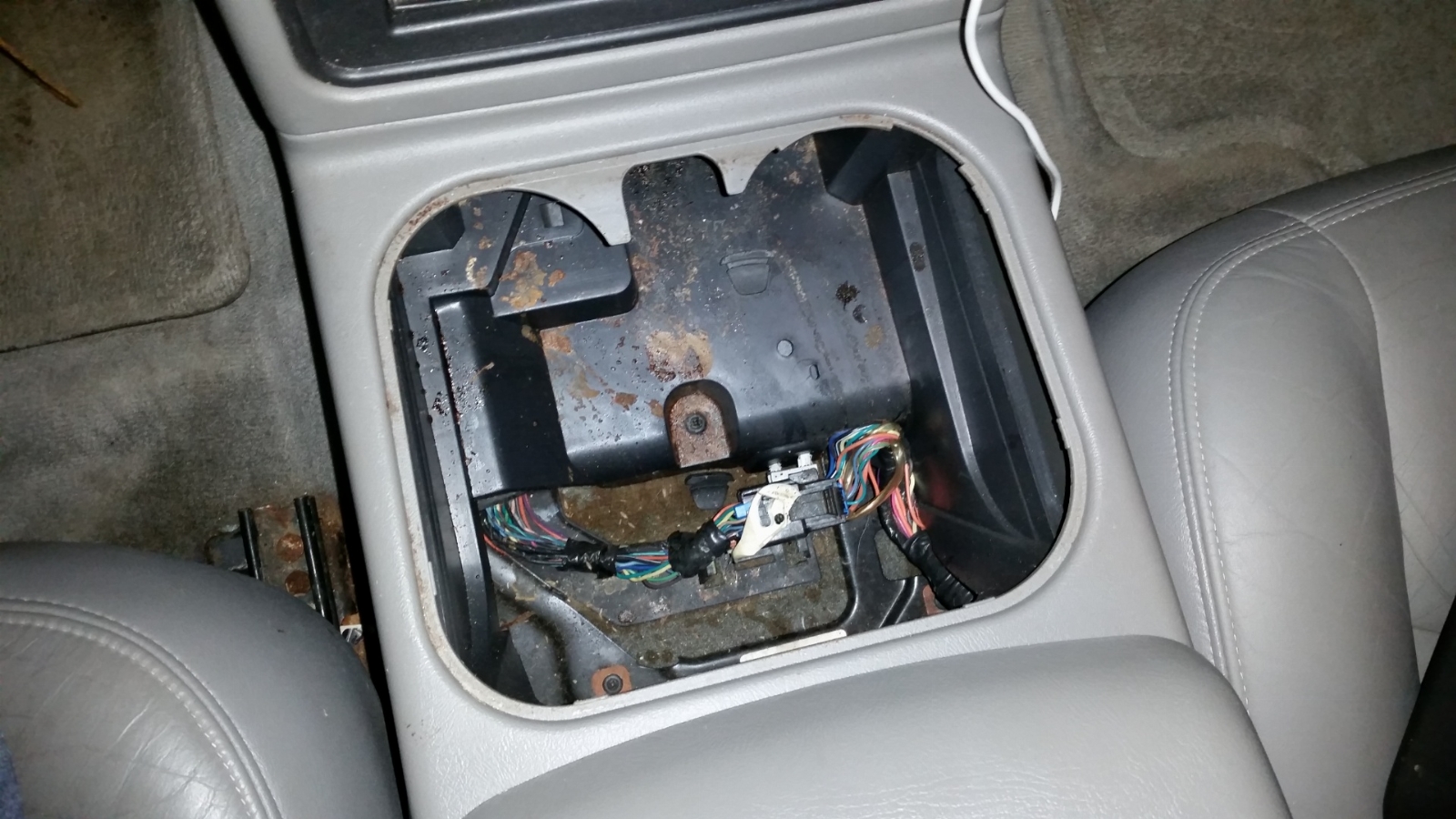

Here is the harness/plug in the center counsel. No amp or anything resembling an amp in there.

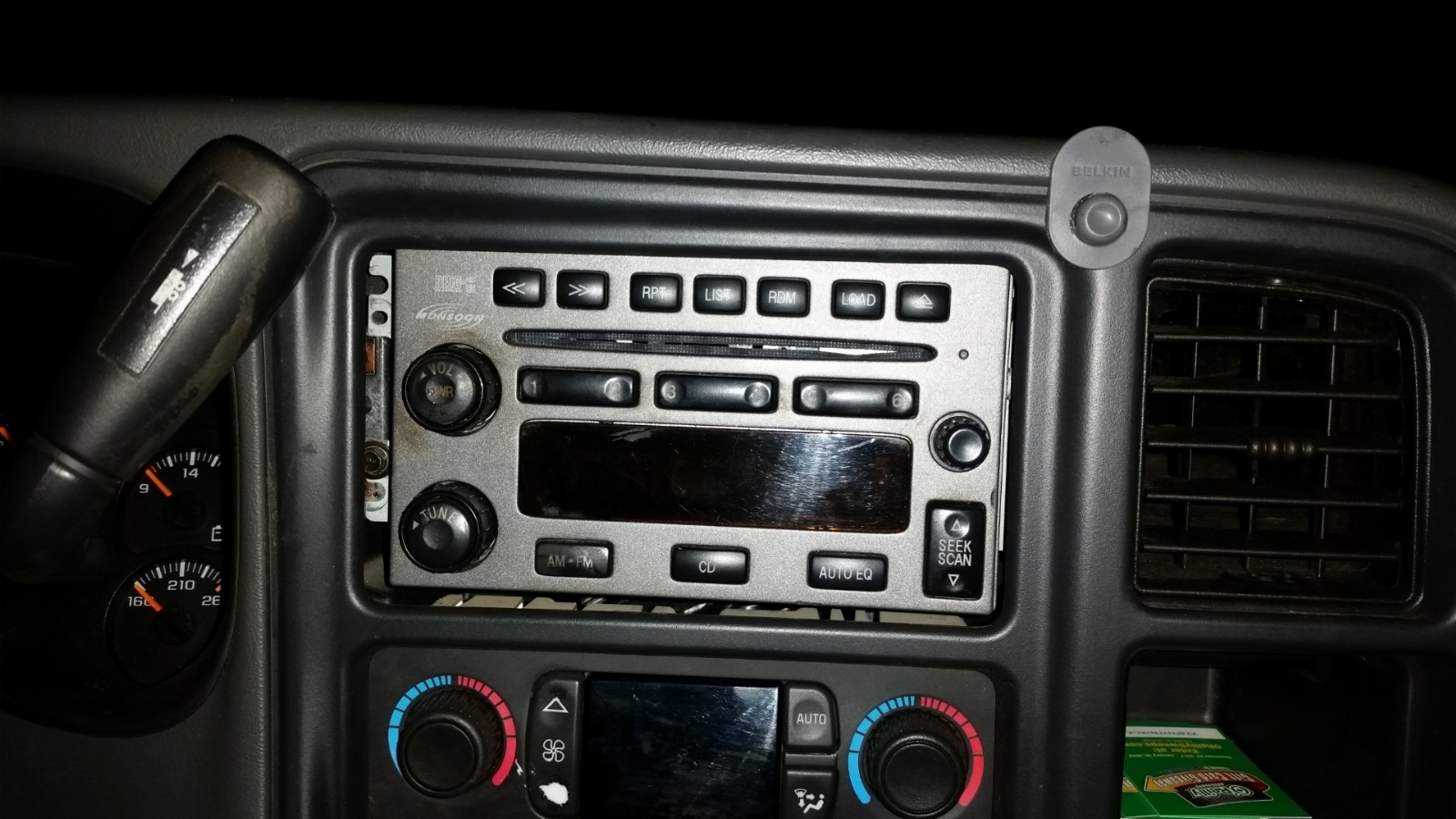

Here is the head unit that is not factory. I have no idea what it came out of to be honest. And also, just for the heck of it, my rear audio and climate controls.

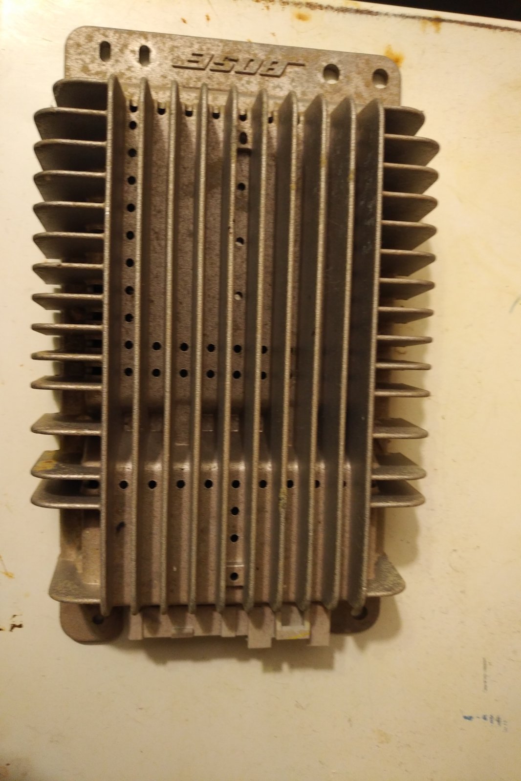

What are your rpo codes? Or request a build sheet from customer service so you know what it had from the factory. This is what the premium Bose amp looks like. It is mounted under the metal bracket and I had to remove the center console to access it when I converted to the Bose Lux. amp. IMG_20180110_0650199.jpg

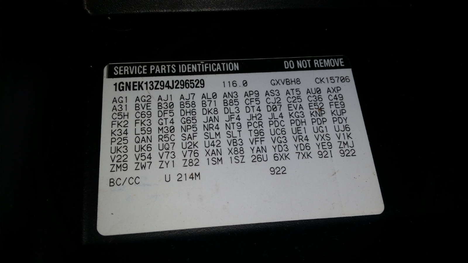

What are your rpo codes? Or request a build sheet from customer service so you know what it had from the factory. This is what the premium Bose amp looks like. It is mounted under the metal bracket and I had to remove the center console to access it when I converted to the Bose Lux. amp. View attachment 190328
I am not at home at the moment and wont be until Friday but where can I find the RPO codes at? A sticker in the truck somewhere or something? I will have to take another look for the amp as well.
Am I the only one who is fairly certain that the head unit in the OP's post came out of a Hyundai?
YIKES! It sure looks like it. Hope they didnt booger up a bunch of wires in the dash to make that radio work in there. Even if they did, I know I can make it right and work as it should but it will just be a way bigger job.
Thanks for the info so far. :)
RPO sticker is in your glove box.

Ok, I was able to run by the house quick and found the decal.
