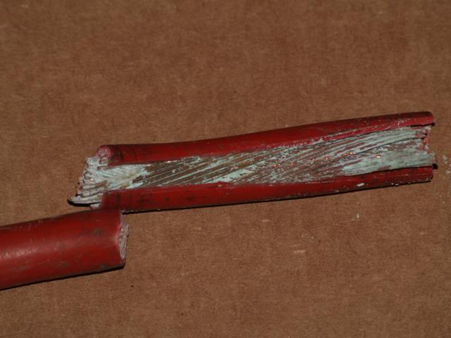

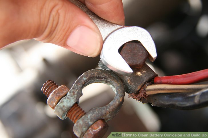

a tight connection won't matter if corrosion has built up in The wires beneath the clamps. You have to remove each clamp and scrub everywhere with a wire brush before securing well with the bolt, which should also be cleaned well.
We aren't talking about the obvious attachment posts, but the wire underneath the clamps, that you can't see without disassembling.
I actually had some $hit identical to this short of the positive lead terminal that connects to the battery. AFTER I loosened the post clamp from the wire/lead, I found this corrosion underneath that could not be seen otherwise. Scrubbed it all out, secured it back to the clamp, reconnect to Pos terminal, good as new. I think you are overlooking something.
Look here
Remove these

And before attaching the new clamps onto the cables you didn't do any prep work? That's where my issue was but I had to actually spread the wires out and scrub all of the corrosion out; it was embedded within the individual strands, I didn't see much outward sign of corrosion or contamination such as your typical green&ashy on the batt post & cable clamp as I clean that reg. I had to disassemble everything then untwist & spread the individual strands to find the root cause.
