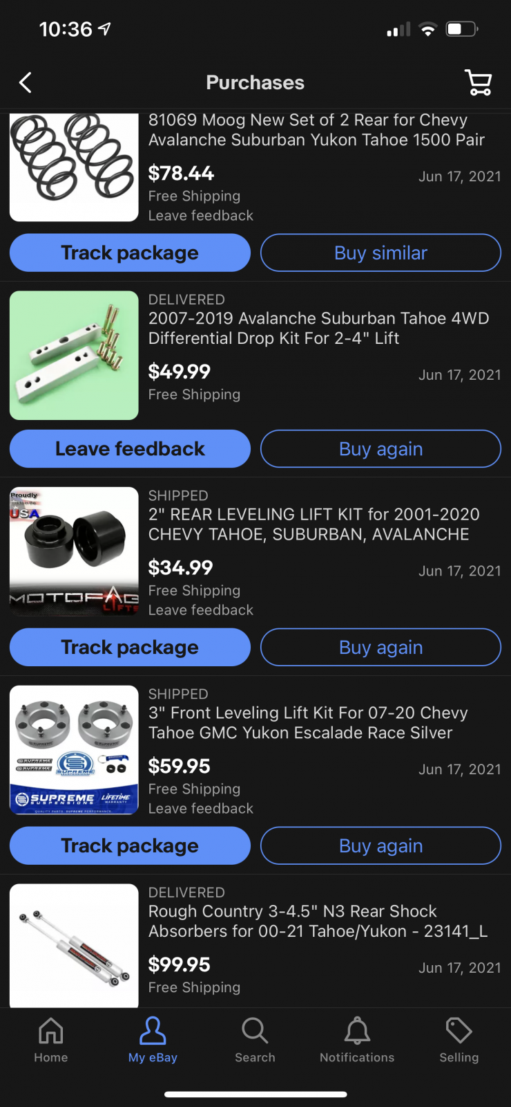

I always read about everybody asking about what to use for your 3-4” lift and how to do it. so I just want to show a sample of what I’m doing for my 2019 suburban LT 4x4.
I posted Pics for reference, the tires btw are Fuel mud grabbers 275/65-18. I don’t have the fancy suspension options so this build is easy. Wheel tires will come mounted balanced and drop shipped to my place. Whole cost of project is about $2509.95 total including lift parts. I’ll have it installed in two weeks when I’m home from the road and will be making an install video and another post update on ride, handling, quality.
this is a stopgap lift until I’m done saving for my mid travel kit that will ultimately be on this big girl.

I really like the way that sits especially with the 22s, I wanted to stay with the 22s but the wife really liked the rims I picked out and the style tires because she drives it 80% of the time while I’m out on the road.
I forgot to mention I did get upper arms for the truck because I have the stamped arms with aluminum knuckles that I know cause problems with the ball joints. I wanted to achieve 4 inch lift without all the added crossmembers from more expensive kits.

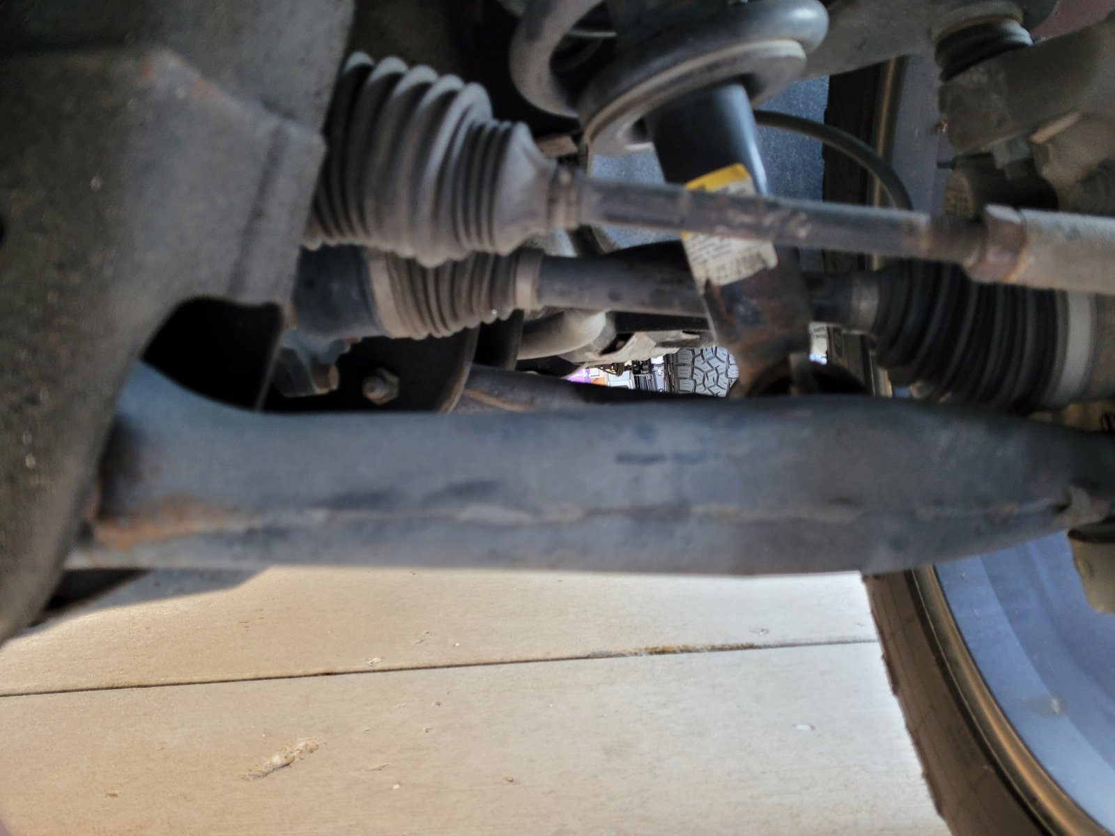

How straight are your C.V. axles?
STORMIN08
Nov 21, 2011
974
459
Honestly, not too bad. But I would prefer better
I also would prefer a knuckle to correct arm angles, but did not want to deal with new wheels at the time.

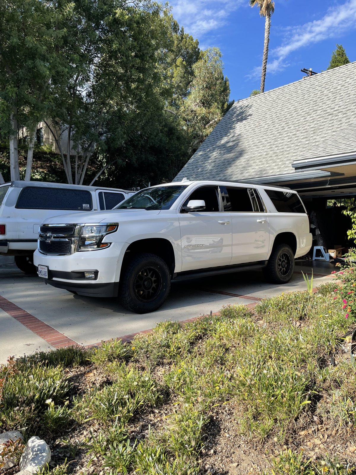

Here’s an update to my 3” lift install. Everything fit up nice with no issues. Took about 6 hours with a jack, jack stands and a combo of hand tools and air tools.
the Z71 coils and 2” spacer with a 3” front spacer combo give a nice close to factory rake and ride.
