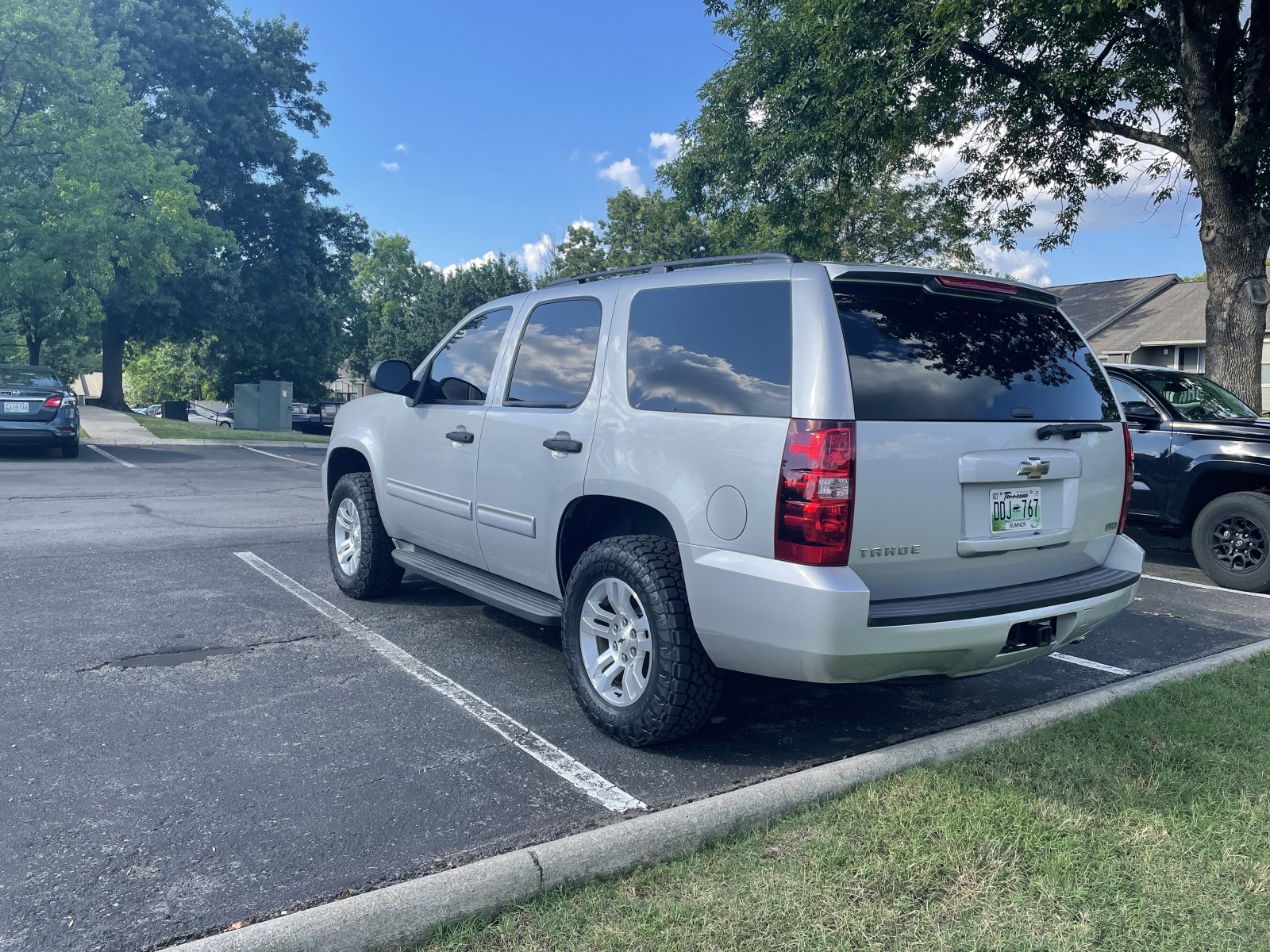

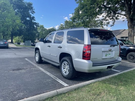

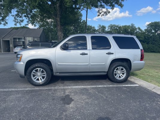

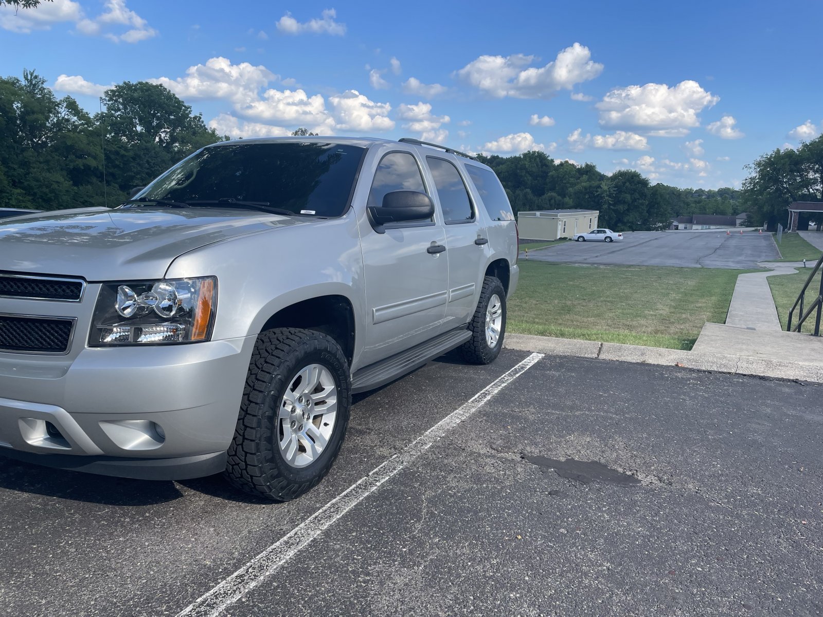

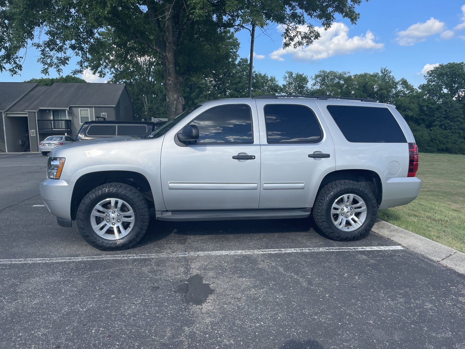

Hey guys. I bought a 2010 Tahoe Ls about a year ago and installed a 2” rough country leveling kit. I want to put on a bigger tire to improve the stance and look. Im wondering if i can fit a275/65/18 without any trimming( not locked to the toyo’s but i like the look) any help would be appreciated. Pics too! Thanks in advance

Yes, that's only about 1/2 inch taller tire. You could go 265-70-18 without a level and is a 1/2 taller than the one you mentioned.

Thanks for the reply and info Swathdiver. Much appreciated. I figured i was good on height but was worried about width and height combined. I think im gonna go with the 275’s. I like a little wider tire.
