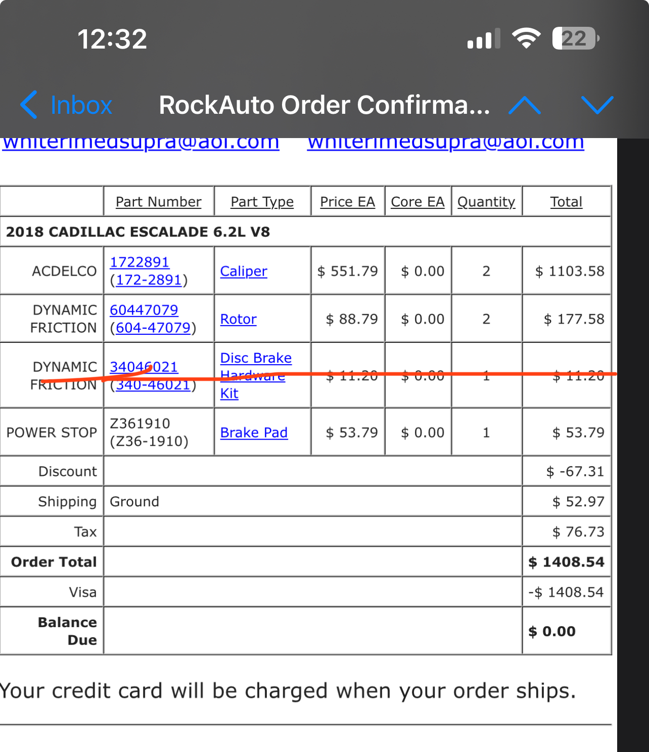

Here’s what you need, calipers are both Left side, just flip the bleeders and plugs for passenger side. You also need 2 M10x1.0 banjo bolts- Dorman 14100 should work (I just had some used ones from another car that I used. Just install this all on my brothers 18’ and was easy peazy.
