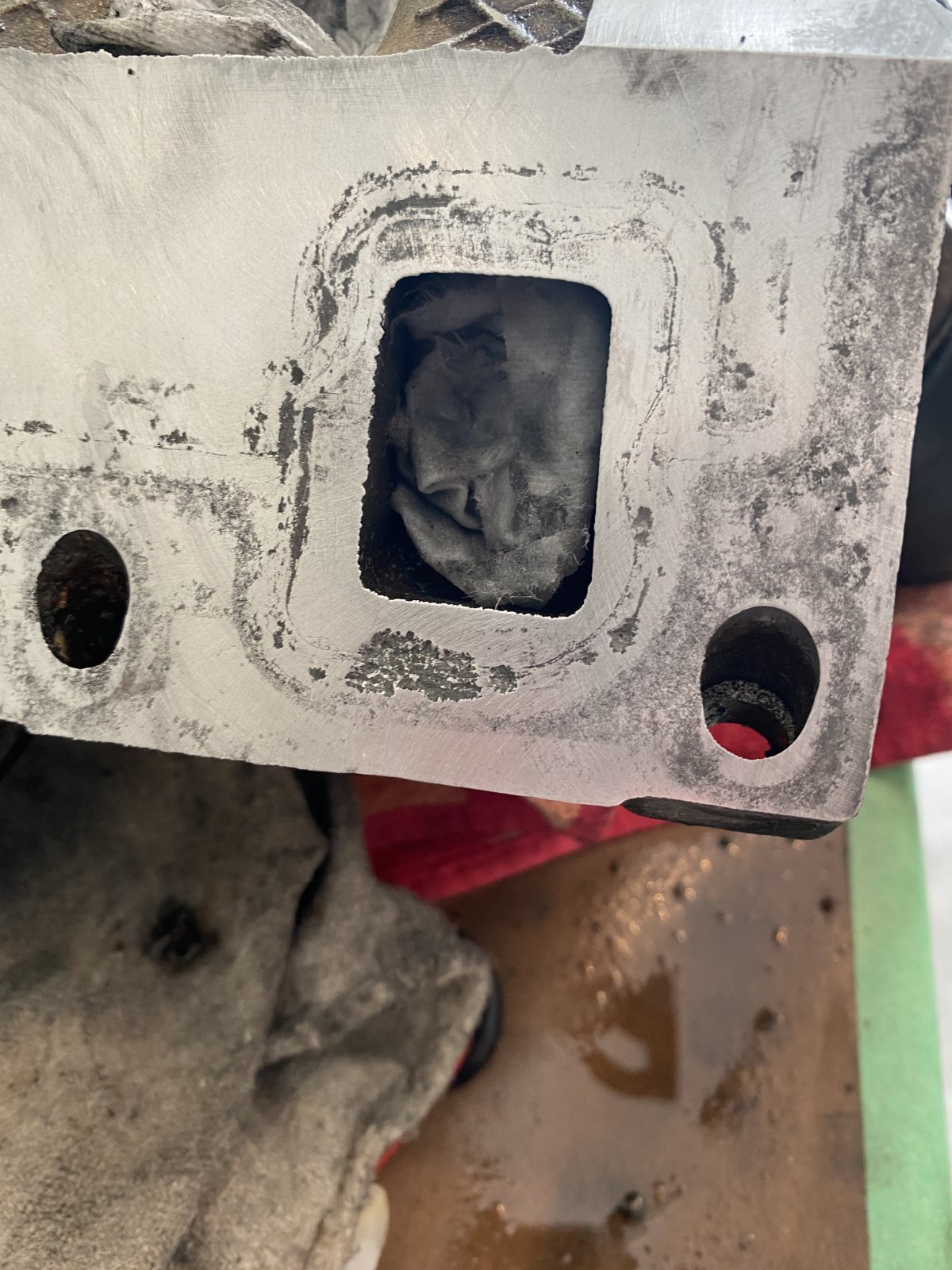

I had bad coolant leaks on my '97. It was leaking from the quick disconnect fitting at the intake and running down the back of the engine. I replaced both the hose and the fitting at the intake. There was also a pinhole leak at the two small water pump hoses, which I replaced with OEM GM parts. Then I got the lower intake manifold off, and had major pitting and corrosion at the coolant port. I had to hot parts washer, sand blast, and epoxy the area before reassembly with new gaskets.IMG_4807.jpeg
