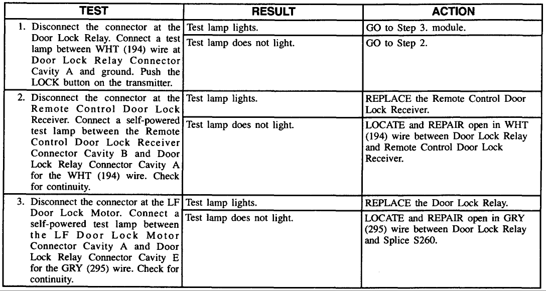

Here are the diagnostics for a 98 Tahoe, it should be the same as your 99. It is basically using the keyless entry to test the door lock relay as this is what grounds out the door lock actuators when the lock/unlock is pushed. If it isn't switching over, nothing is going to work.
Door lock relay connector...
