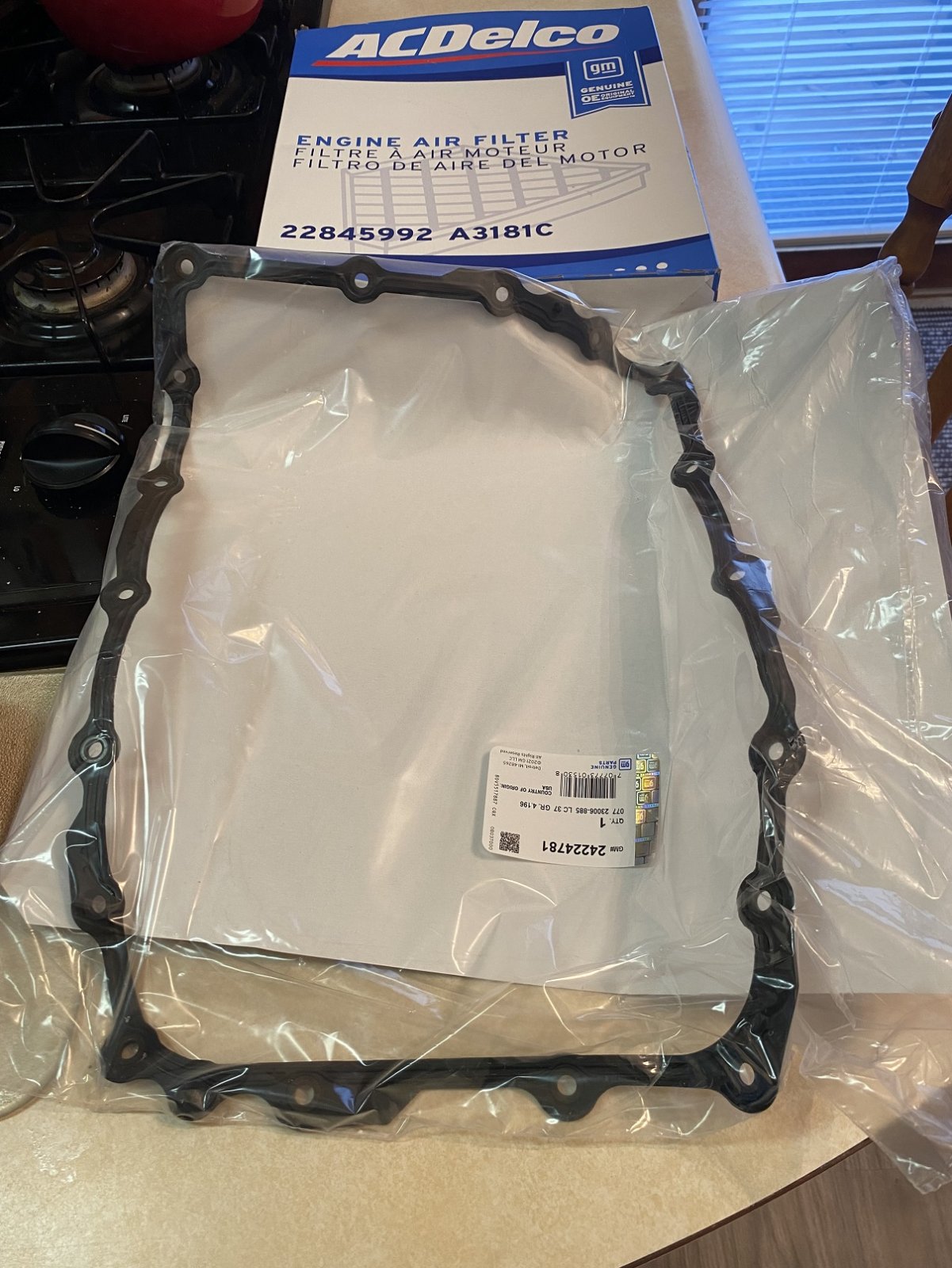

That gasket is probably still good to use. List of parts that I just got for our '19
Fluid ACDelco 10-9394 quart or 10-9395 gallon
Filter ACDelco 24236933
Factory type gasket ACDelco 24224781
Also a cabin filter CF188
Air filter 22845992 A3181C
Got all this at Amazon, not too impressed with the packing though. Hope this will straighten out ok.
