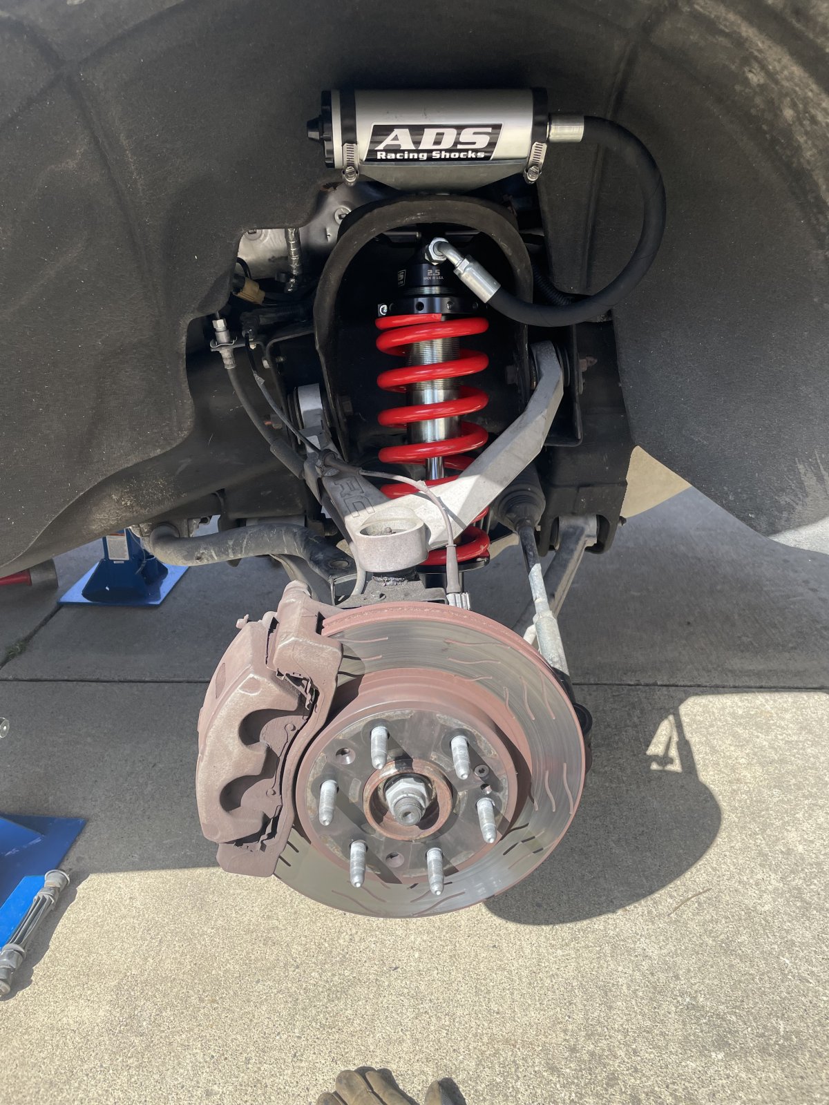

You can call ADS racing and they have a 2.5 front and rear set up.
If you tell them what type of driving you do they will tune the shocks accordingly.
Fox won’t do that and king requires you to know what valve stack to put in
Awesome, I knew somebody out there had to be more customer oriented in the suspension world...I assume most of us don't know squat about valving shocks.

I’m fairly well versed and I’m still an idiot.
The GM of ADS has a Yukon, so he developed the shocks for his own vehicle. So extra Gucci design that we all benefit from.
